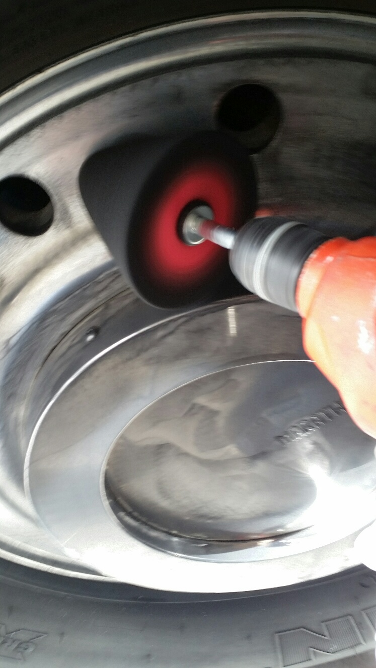

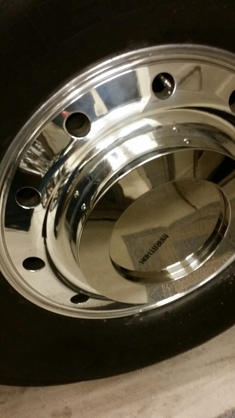

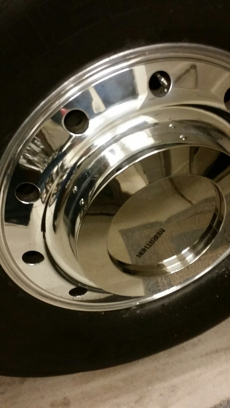

For about 27 bucks at Walmart and about 15 minutes of polishing each wheel, you can make them look new again. Just clean the wheels first then apply Mother's Mag and Aluminum Polish to the surfaces of the wheel. Add a little polish to the Mother's Polishing Cone and start with slow rotation to disperse polish over the entire wheel surface. Increase drill rotation speed to a comfortable level and polish the wheel until the polish begins to dry. Wipe polish from wheel with a Miracle cloth and apply a good coat of wax to enhance and preserve the shiny surface.

Looks good....Thanks for the tip.
