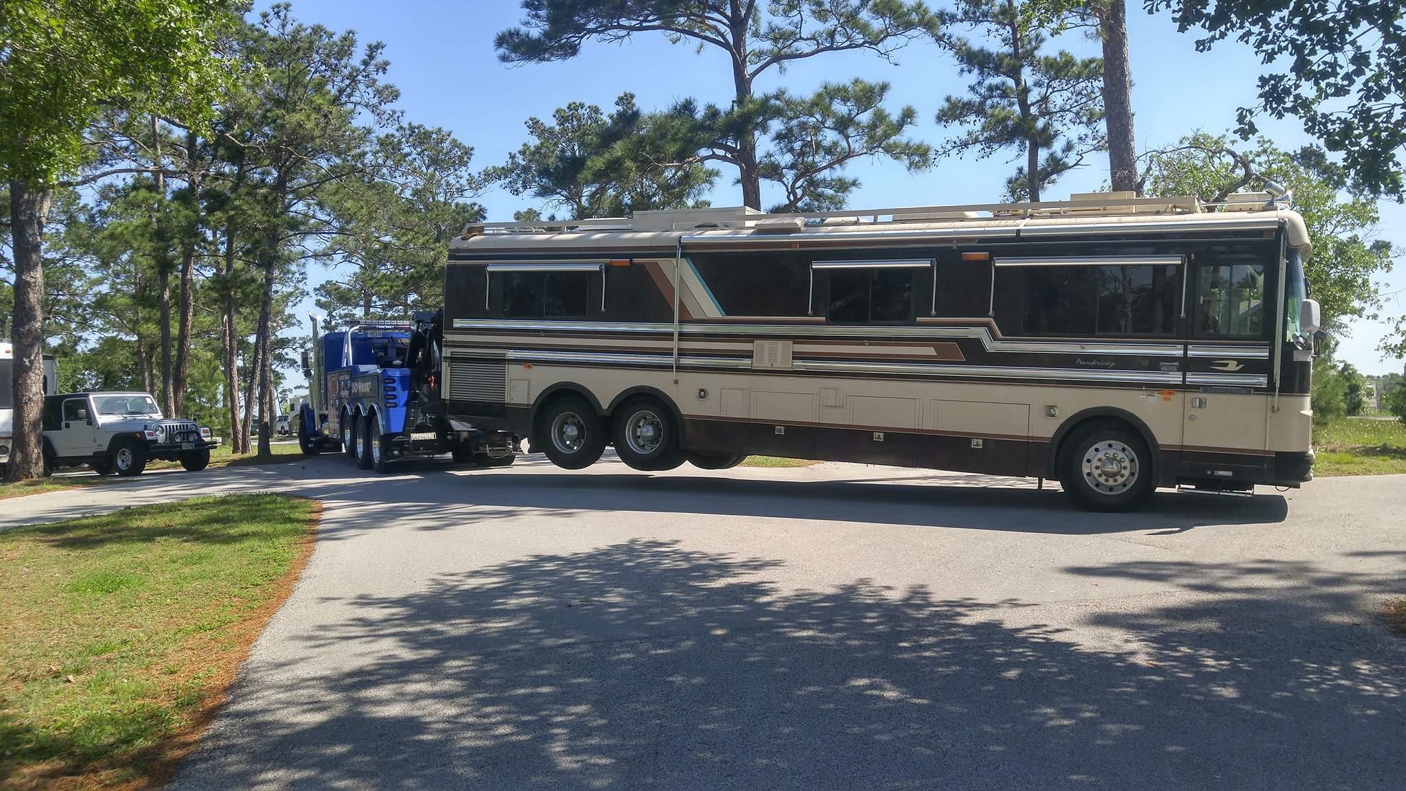

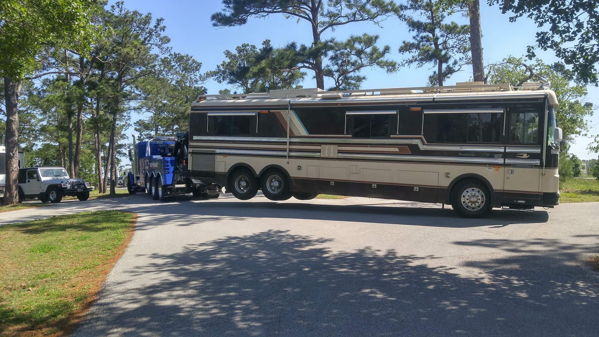

As for the tow, Yeah...that alone was a nightmare. Four different companies walked away from even attempting but Tyler at BDS Recovery in Texas told me over the phone it would be done. 5 hours later it was done. Huge relief for me and high praise for Tyler and BDS.
