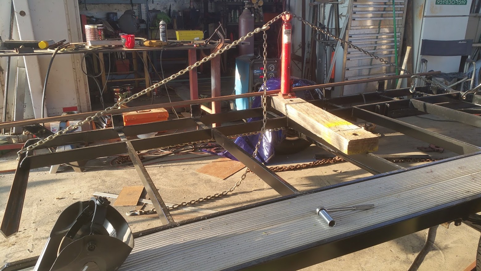

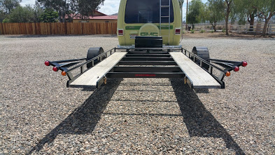

Here is a link to a project I am working on. right now I have a bit of a problem with the side Mirror fit on the pickup so I may need to use my other suv which has an issue with length. the video is on a rented server I use to host how to video's for my website customers and project proposals for landscapes. Please give me input on my plan. Thanks in advance

Greg,
Love it. Love the simplicity of design with the triangles.
By way of background, I have a Chapparal Aluminum bed trailer with dove tail, large storage box up front, dual tire racks above and wing walls on the sides. I also have a Performax 24’ enclosed with 5’ tongue and 1’ hitch puts me at 30’ behind the 43’ Bird. I mention these because my random comments below will refer to features of them. I really wish I had an enclosed stacker now!
-If drawn to scale, your balance looks pretty good.
-Love the rotating triangle design. Simple & effective. Your single point of failure is the rotating or hinge assembly. As such, the support for that assembly needs to be quite robust. I have some ideas we can discuss. Call me if you want. Remember the pics I sent of my rooftop crane assembly?
-Per you comments, I would not even try to rotate the loaded assembly by hand, nor would I use hydraulics. The stackers tend to use winches. Mount a heavy one on the tongue and let it do the work. Power source from bus plug is readily available. And it’s a safety if something breaks and has to be loaded manually.
-the fancy “arches” can be light framed aluminum sheet attached to the triangles. Just like my wing walls on the Chapparal.
-if you can dove tail that trailer bed far enough that might solve some rear clearance problems and maybe reduce overall load height which is a large problem as you mentioned.
-Highly endorse your rear load ramp and structural support idea. The back door ramp and dove tail on the enclosed trailer is great.
-Suggest drop in wheel chocks on the back of the upper ramp. Kind of like motorcycle chocks. Drop them in a hole in the ramp and insert a lock pin on the bottom side of the stud.
-Good thing that trailer has 7k axles! I assume it’s pretty stoutly cross framed underneath. How close will you be to the 14k limit when fully loaded? Most stackers have triple axles for added safety.
-Does that trailer require 2&5/16” ball and have you upgraded your receiver to 2.5” for 20k+ loads? My LXi has been converted to 2.5” receiver and braced (builder said he wouldn’t blink at 30k load but that’s not happening). On the other hand, an enclosed stacker might approach 20k and I like the safety factor. Loaded with the Hummer, the enclosed trailer pulls as easy as the Chapparal.
-Do you have equal lift load bars and anti sway bar hitch assembly?
-I have to assume that trailer has four wheel brakes!
-Trailer tires rated for the 7k axles?
There may be others I forgot, but that’s my random thoughts for now. You got what you paid for!?
Neat idea. Fully loaded height will make checking your routes ahead of time fairly important.
FWIW.
Mike Bulriss
2001 LXi 43' DS Millennium Edition
San Antonio, TX
05-03-2018, 10:57 (This post was last modified: 05-03-2018 11:31 by travelite.)
RE: open stacker project
Hi Greg,
Good to hear from you. Glad all is well.
I think it's feasible. Just a couple of points:
1) Depending upon the trailer weight, width, and axle track width you may want to consider outriggers. You have a loaded upside down pendulum and you need to watch eccentricities. Ideally you'd be loading and unloading on a perfectly flat and level surface but that's never going to happen in the real world. You have suspension deflection, side support arm deflection, bearing free play at the rotating pins, and all the other environmental concerns from soft soil to wind to tire air pressure to contend with. If the pendulum articulates outside the normal plane you can have some fairly large bending moment forces on the booms and on the pins. There's considerable weight up there with the two Razors plus the supporting platform and tracks. I can see a several thousand ft-lb bending moment to contend with. This can all be much better controlled if you have outriggers to shore up the trailer platform.
2) The bending moment will always be there so you have to deal with it. You'll need a pivoting system at the trailer that spreads the forces across the trailer longitudinal beams. Something like a third trailer axle. Imagine another axle that lies across the frame longitudinals and u-bolted into place. Alternatively a subframe can be constructed to span the width of the trailer longitudinals. This way we've eliminated the twisting forces that you'd see be simply connecting the rotating pin to one frame member - now it's a force couple spread over two frame rails.
3) Once the pendulum is fully loaded and rotated into it's final resting place I'd like to see it firmly pinned to the trailer frame rails. My preferred point of attachment is up at the tongue by the steer wheels of the leading razor. This makes a secure attachment point pinned to the trailer in double shear without any intervening links; likewise, when you're loading I'd like to see it pinned back by the dovetail, and
4) I'd use hydraulics. The winch system is simple but I want better control. With the winch there's always the possibility of cable slack, and I know the pendulum is just waiting for any screwup to make fools of us. I'd put the hydraulic rams between the two trailer axles with the piston attached to the highest apex where the two triangles meet.
Just my opinion, hope this helps.

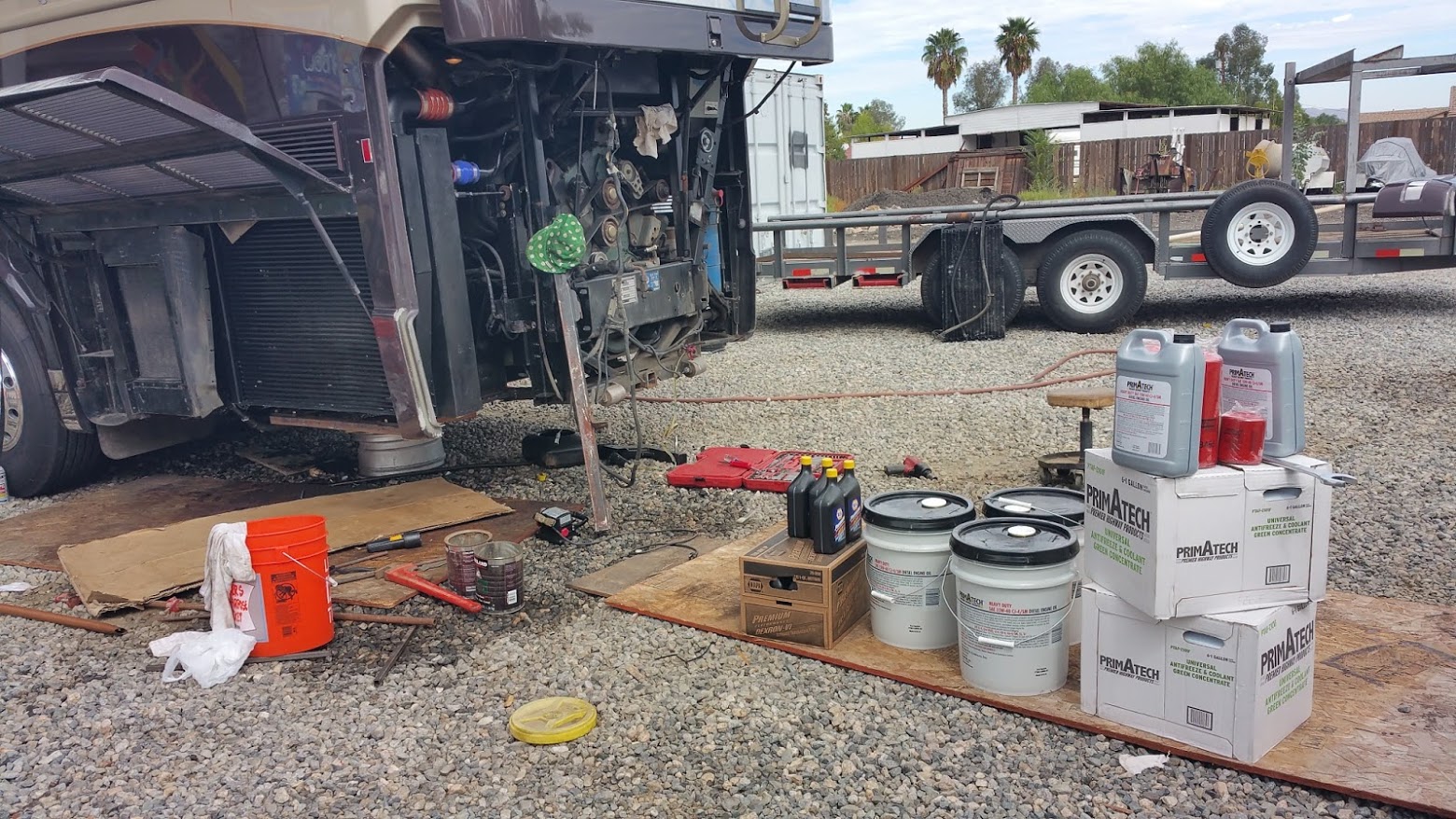

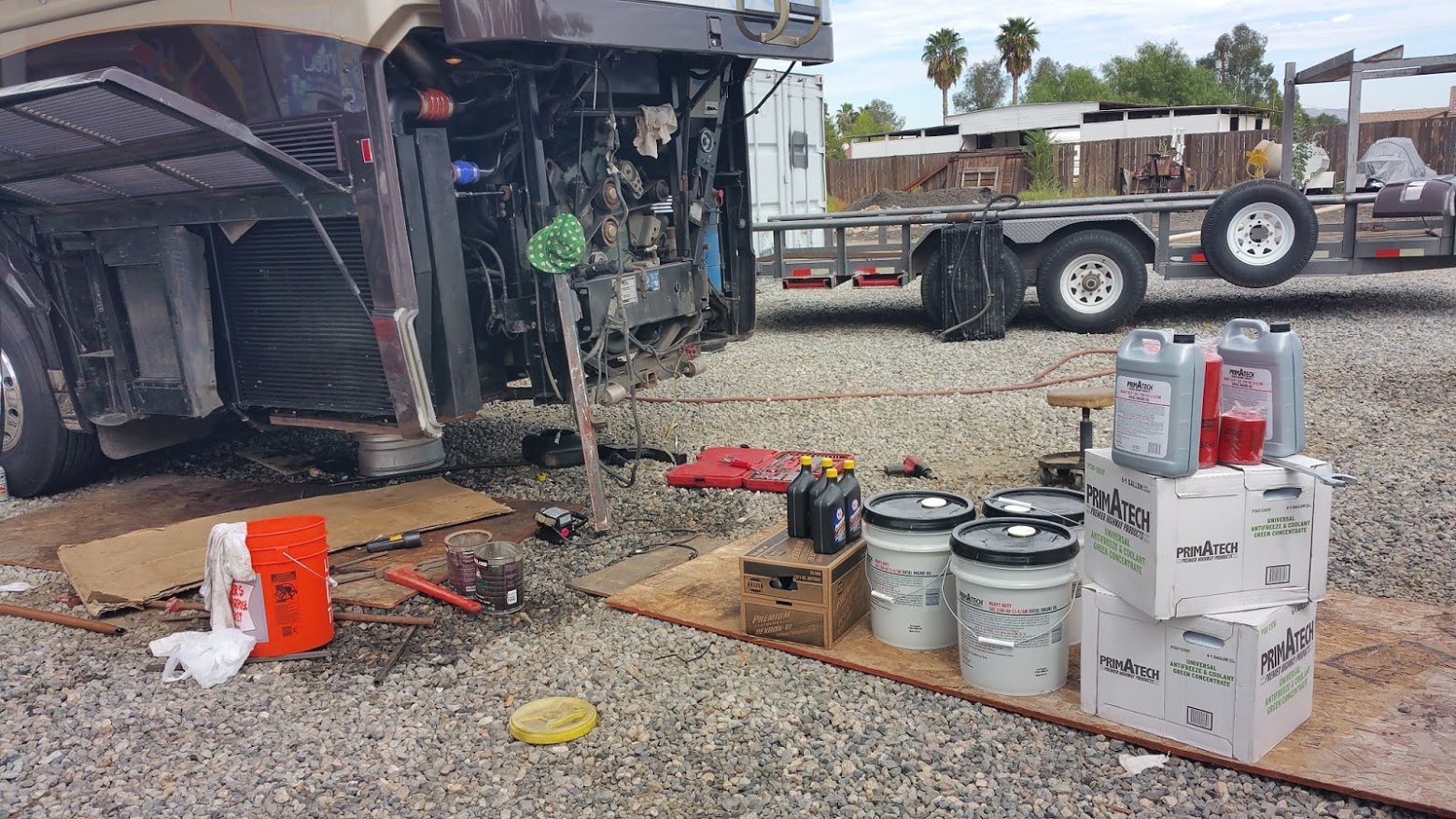

Arcticdude thanks for the input. I did stack the last couple of toys sideways but the rzrs are too long for this. they are lite enough to rid on top of the truck but when I add the rack weight things once again get too heavy . this same trailer had the quad rack prior here is an image of that stack. (sorry cant find one of it loaded this image was taken after I slid in a new radiator via bumper access). the quads entered from the other side of the trailer where I cut the trailer top truss off and installed two 3x3 tubes to hold this top rack up. the pivot of the rack was on top of this side of the trailers top truss tube. the power was a farm jack on the other side. The twist David talked about was non existing because the 3x3 tubes welded vertical held control. there might some use for using a support to work realtime to control the twist with that setup.

I hadn't realized those RZR's were 9' long when I suggested putting them crossways. That does pretty well rule that out, for sure. Even trying to stack them in lengthwise front of the Hummer makes for a long trailer and probably not a viable option for your usage. Nothing is ever easy, is it!
