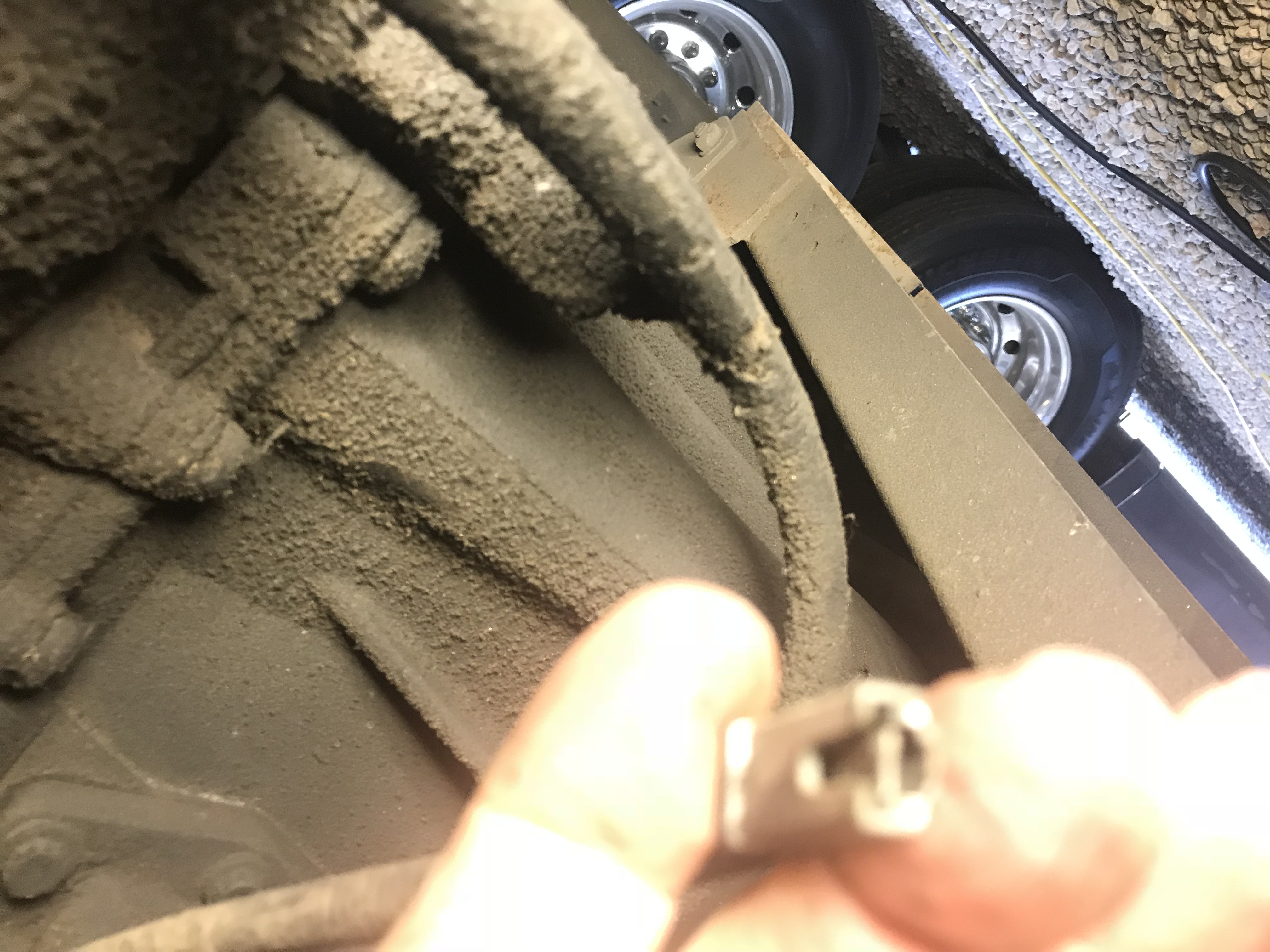

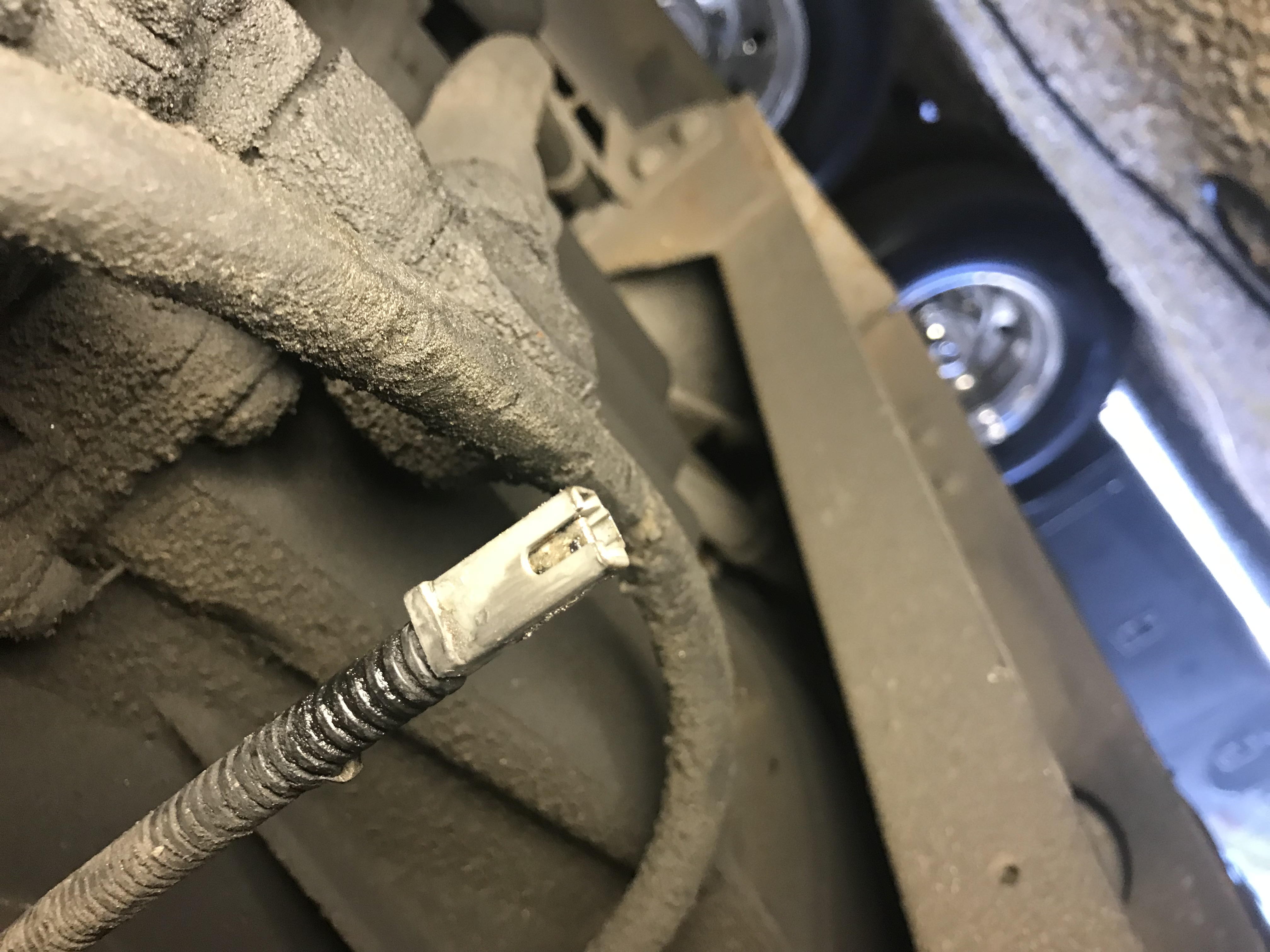

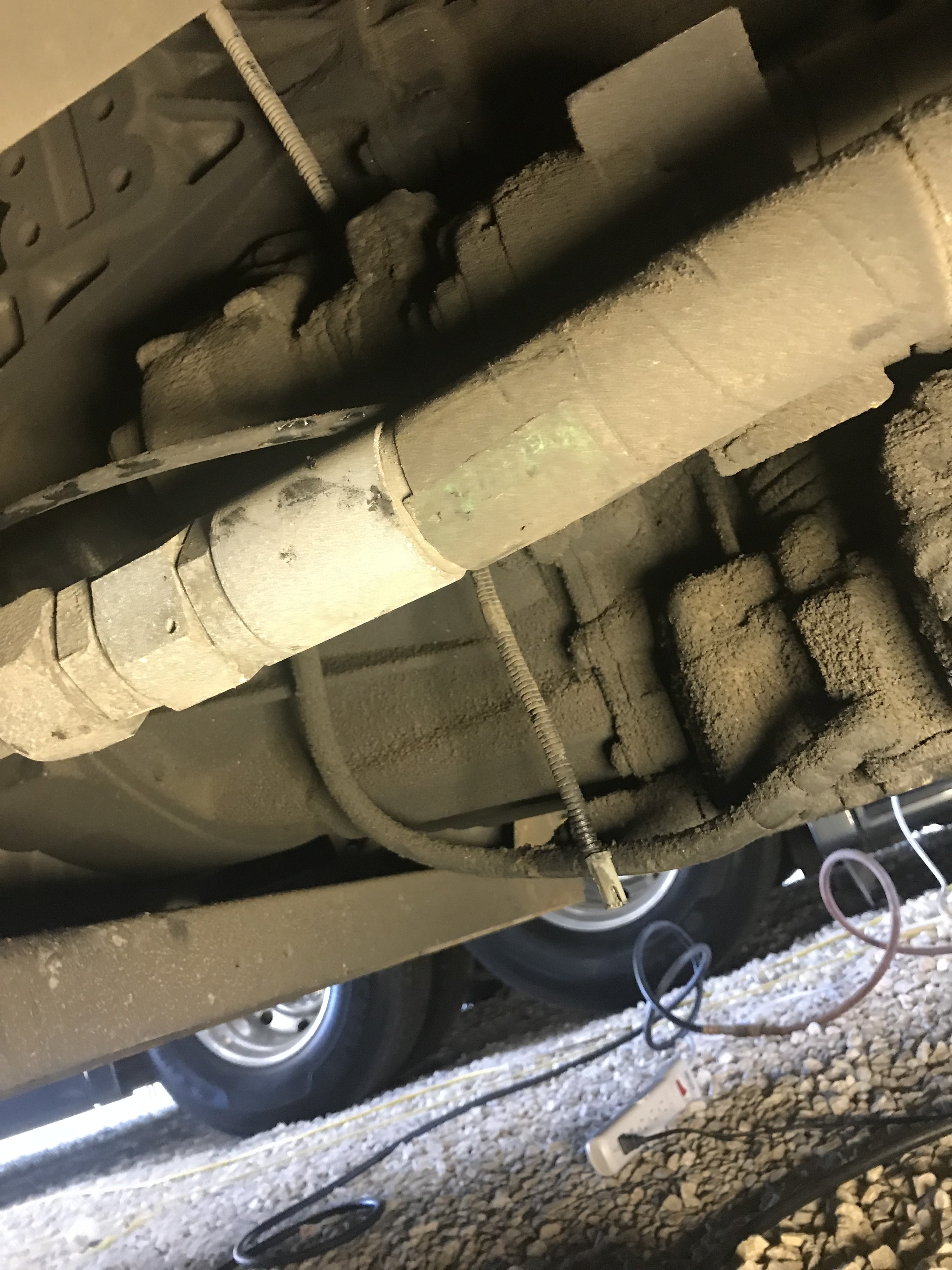

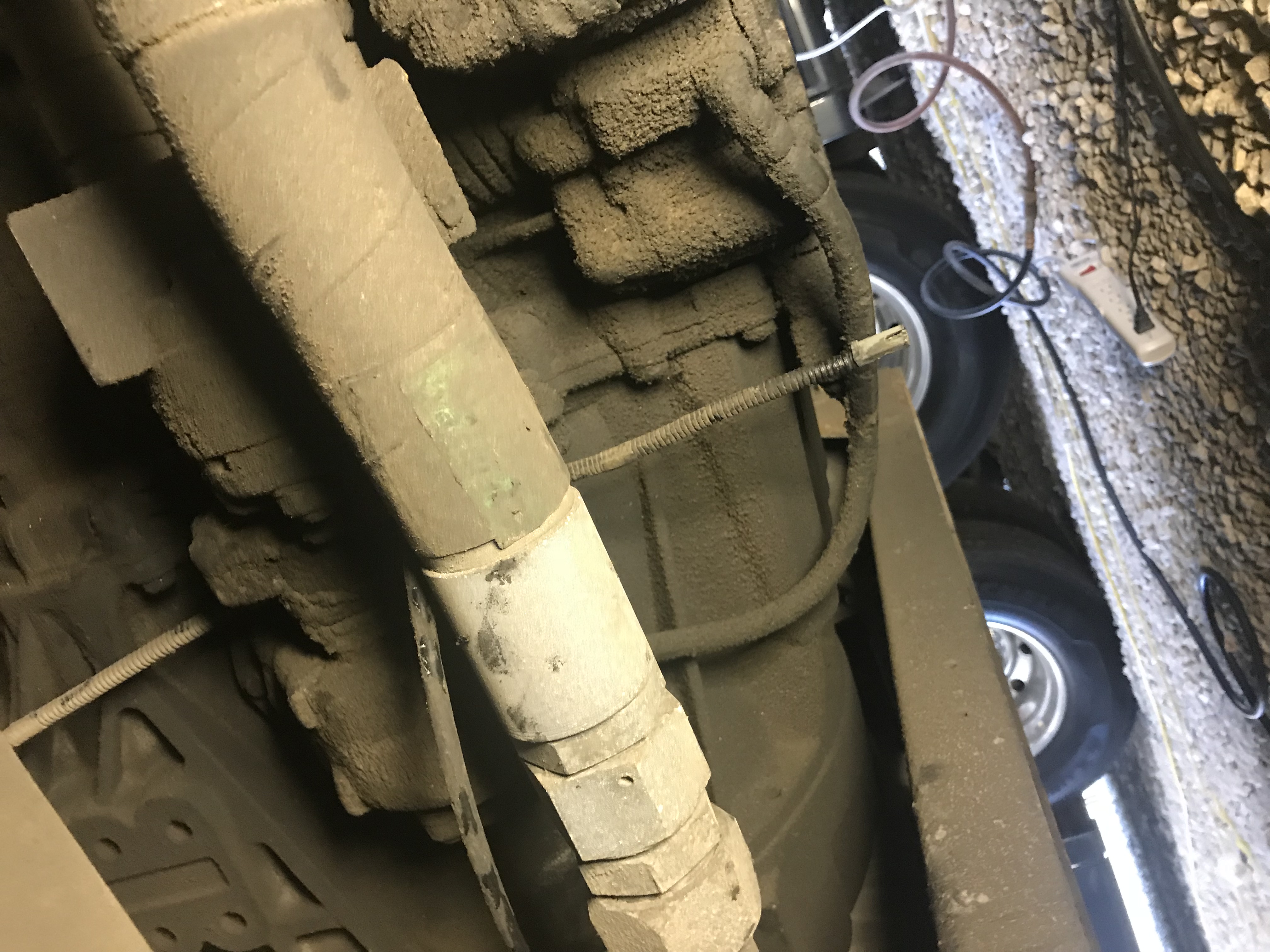

So, finally getting around on doing some PM on my relatively new-to-me LXi and I was squirting some of that expensive grease into the expensive PTO when I noticed a clump of mud and grease hanging down on a wire behind the PTO. Once cleaned off with brake cleaner, it looks like a connector for the end of a temp or other sensor. Can’t find anything close that it would attach to. Any ideas?
Or is this one of those strange extra cables Bluebird loved to leave laying around? When I was cleaning the heater fans under the water closet sink I found several coiled up wires. I thought, nah, but when I put a meter on them, sure enough, they were live 12v wires. Not even capped off. Kind of like programmer Easter eggs in code!? It was obviously hanging there for a very long time because it was heavily encrusted with grease and road mud. So my guess is it can’t be too important! Thanks for any ideas. Mike Bulriss 2001 LXi 43' DS Millennium Edition San Antonio, TX |

I found out that our PHP version limits file upload sizes to 2MB. I resized your IMG_4088.jpg from 2.2MB down to 1.4MB and it uploaded fine. BTW, could that might be your barometric sensor wiring harness? See if it's connected to the harness that goes to your turbo boost sensor. david brady, '02 Wanderlodge LXi 'Smokey' (Sold), '04 Prevost H3 Vantare 'SpongeBob' "I don't like being wrong, but I really hate being right" |

After reading of your adventures with a problematic one, I’m kind of hoping that the only barometric sensor that I have is the one hanging in the bus with the temperature and humidity gauges. That wire connector was as covered with grease and grime just as thick as the nearby hose coming out of the transmission. So obviously, it has been hanging there for a long time through prior owners. I could find no connectors for it around the tranny, pto, or even in the frame rails. My Bird exhibits none of the loss of power, loss of boost issues that you reported when you had problems. Quite the contrary, it runs like a scalded ape, which is reflected in poor fuel mileage (the ‘pro driver’ says about 6mpg, my calculator, not even close). When last checked shortly before I bought it, there were no active codes. I check closer later today on the harness connection, but I’m tempted to leave well enough alone. ? Mike Bulriss 2001 LXi 43' DS Millennium Edition San Antonio, TX |

That connector does not look like a data plug, but it could be from the inverter to the batteries for the temp sensor. The PO cut mine somewhere along there and darned if I can find it. Wish it hung down like that. Ron & Dorinda Rueckwald 2000 LXi, Single Slide Summer in St. Joseph, MI Winter in St. Petersburg, FL |
