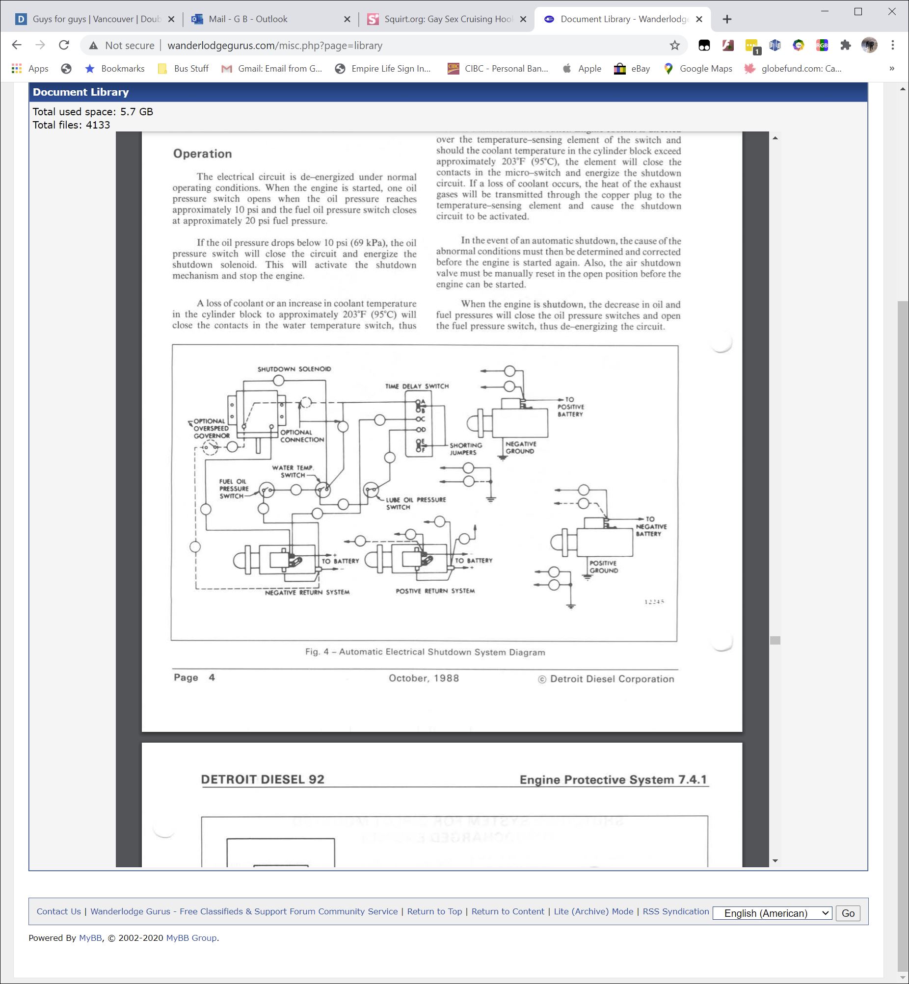

Found this in the Engine manual in the Document Library section. There is a ton of information there. If they broke your senders it should be easy enough to remove the ignition keys so no one can start the bus and remove your senders and take them your local Detroit or Heavy Truck shop and get two new ones. Not sure if they destroyed the wiring as well as your post was not clear on that. This schematic should help some though as it does show the two senders you speak of.
Gary 82 PT 35 6V92 BC (Sold)

Thank you,, all good suggestions but the shop hid what they did, threw out my sensors, lied about what they did and then tried to blame it on me to say I lied about the issues and results. I am having to start over again since none of the sensors involved are from Detroit. I am having to match sensors with existing gauges. The whole things just sticks.
