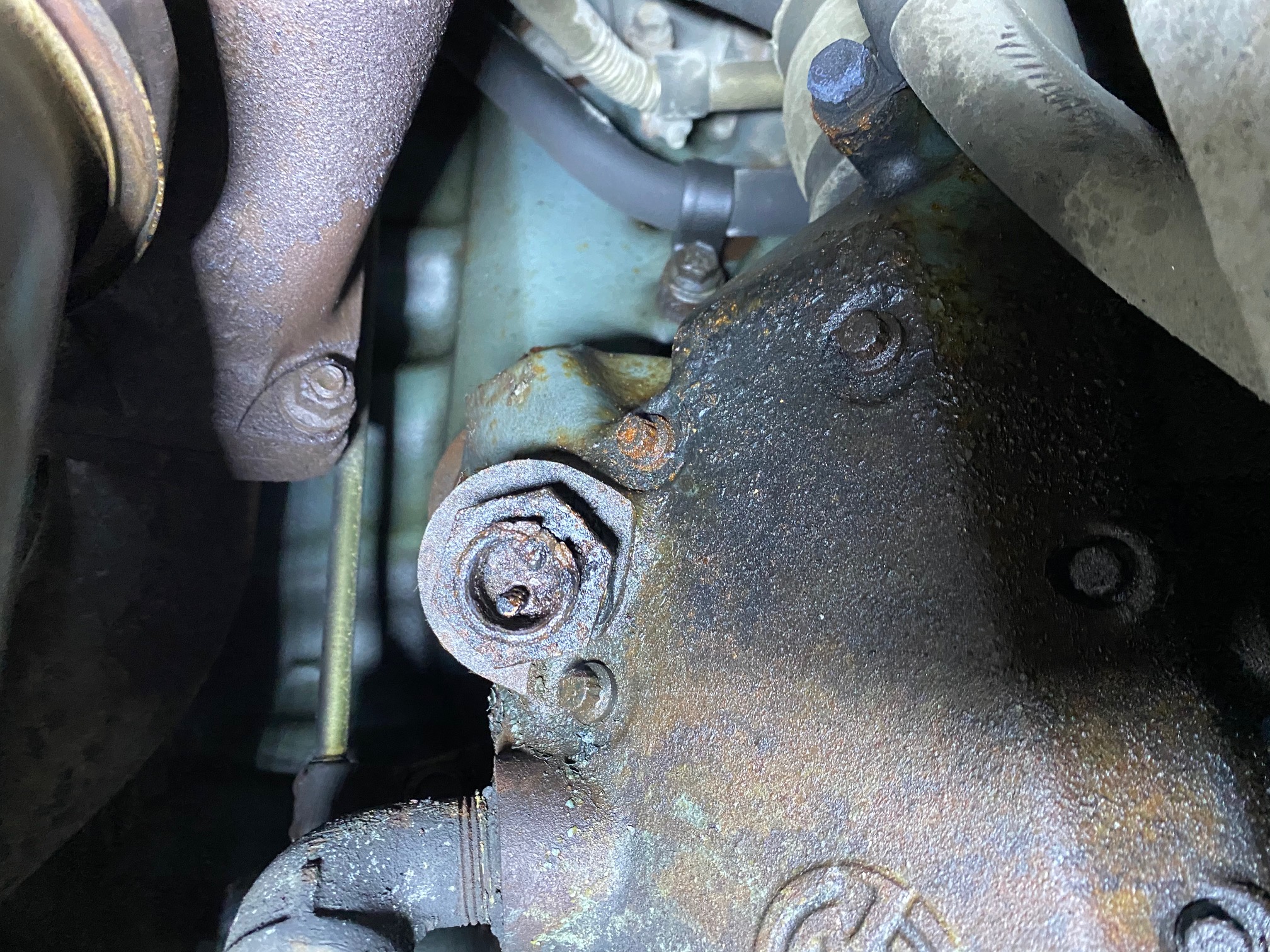

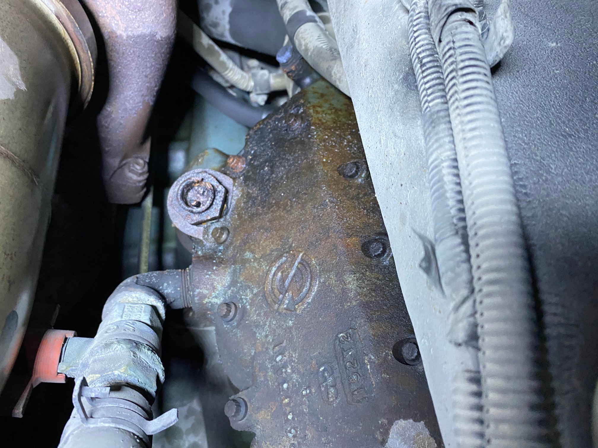

Here's a couple of pictures:
This is the block heater, or at least what's left of it
Here's a little larger view. While I've been spraying penetrating oil on things in hopes I will not have to remove the oil cooler to get this heater out, you can still see color changes in the cooler paint from the seeping coolant.

As a followup to my heater issue. I was able to remove the old block heater. It took an impact wrench to get it started. Then it came out easily. I had the new one ready to go back in and did not drain the coolant prior to removing the old one. I lost less than a quart in the swap over.
