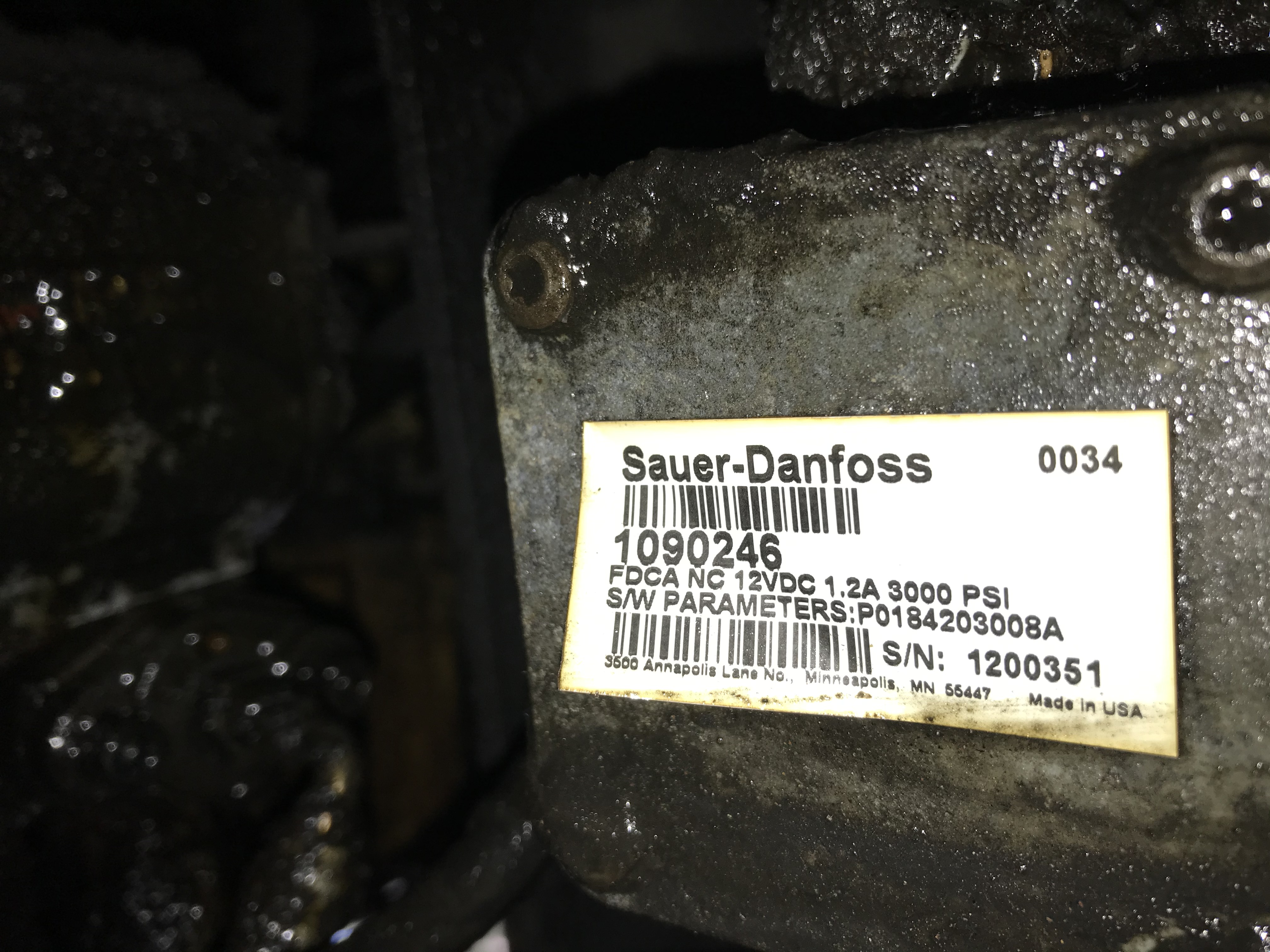

I have a 2001 thomas/matthews book mobile conversion.
My Hydraulic fan control sauer-danfoss 1090246 has quit and is leaking.
She's up in anchorage at a Thomas dealer and he cant get the part, we have spend days looking.
I saw this forum and decided to give it a shot! Our bus got 'stuck' up there during covid/canada rules so we are flying up next week for a summer of fun if we can get it fixed! The storage facility noticied the leak and I had a mobile mechanic from the Thomas dealer go over a couple weeks ago.
I saw postings from Articdude! Maybe he can help!
Cant wait to check out your forum! PS I live in VT.

Can you bypass it to get home? On the air clutch fans there is a provision to thread a couple bolts into the hub and bypass the clutch and hopefully you have the same backup feature. Then you can cap off the hydraulic line and have your bus at least until you can track down the part, or find an alternative. Its noisy on the highway and robs some power but in a pusher you likely would not notice.
If a Thomas dealer cannot find a Thomas part you may have to get creative. But I had a similar problem with a Ditch Witch hydraulic motor and they could not help me so I ended up taking it to an independent hydraulic repair shop and they had no trouble getting it working again.

Try contacting Sundstrand, as they routinely come up when dealing with anything Sauer-Danfoss.
https://www.hydrostaticpumprepair.net/
Also, take a look at an older thread from here:
http://www.wanderlodgegurus.com/showthre...controller
You may get lucky on an updated part number through one of these folks, though I think one listed is Sundstrand.

your 2013 post is how i found you on the internet! But that was 8 years ago, a lifetime for a bus!!
There is an updated part number the dealer got but also not available.
I found an anchorage mechanic who knows about this item he is gonna go look tomorrow
