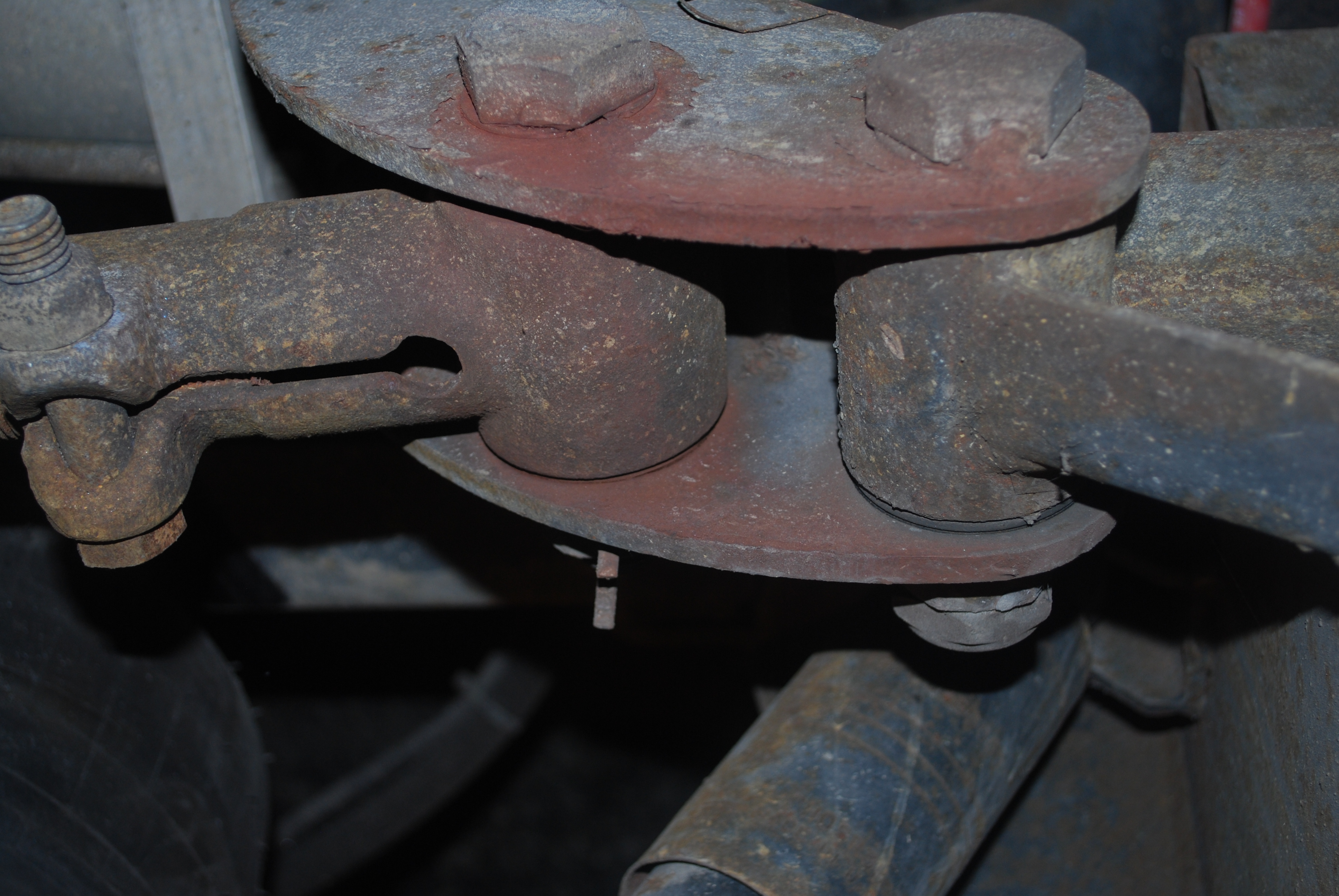

RE: steerable tag
I hope I have attached a picture showing what to look for as bushing in the suspension start to fail. The red rust indicate the bushing is starting to move around. This particular bushing is on the lockup system of my tag axle. Charlie Vaughn 1999 LXi |
