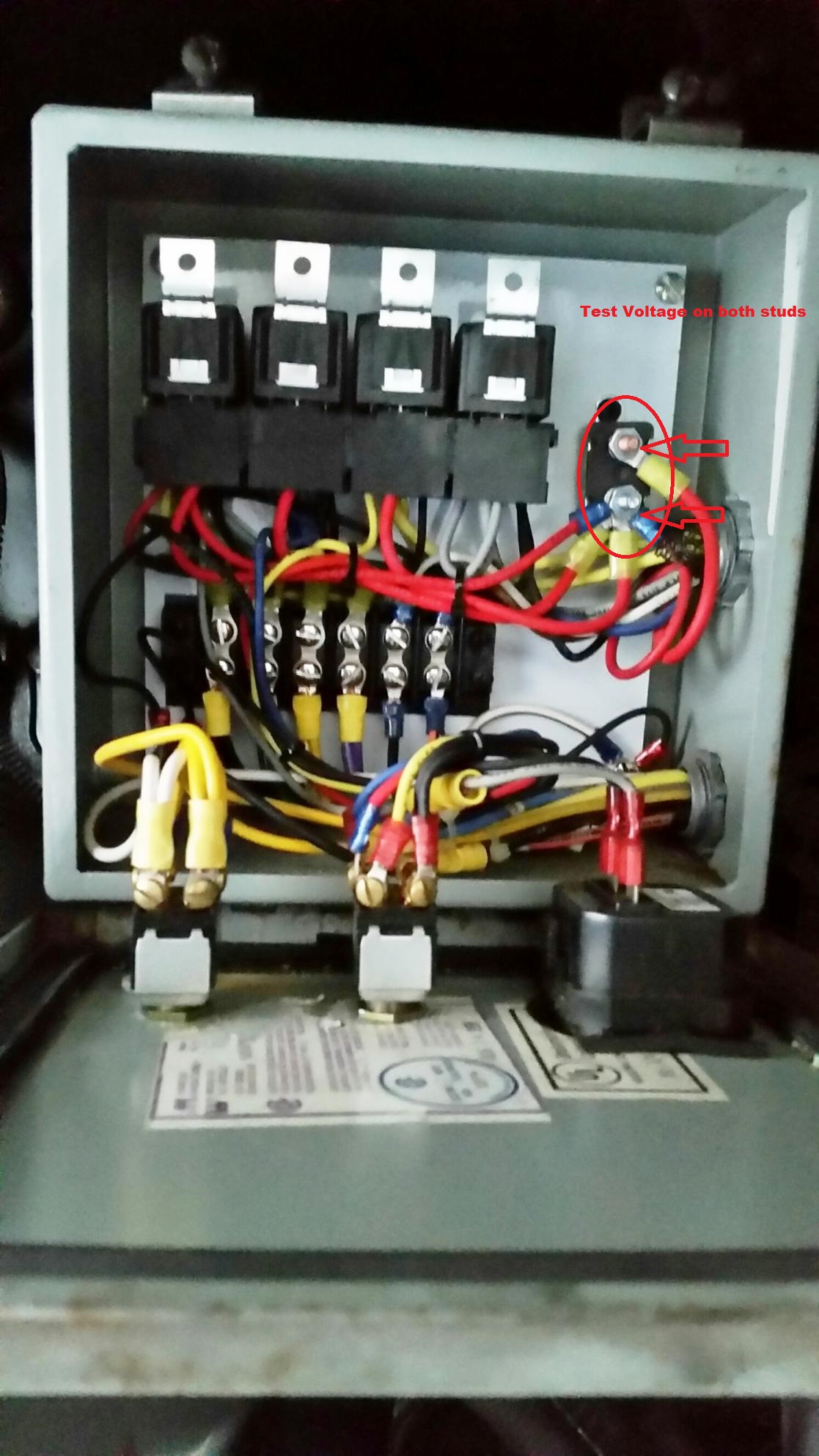

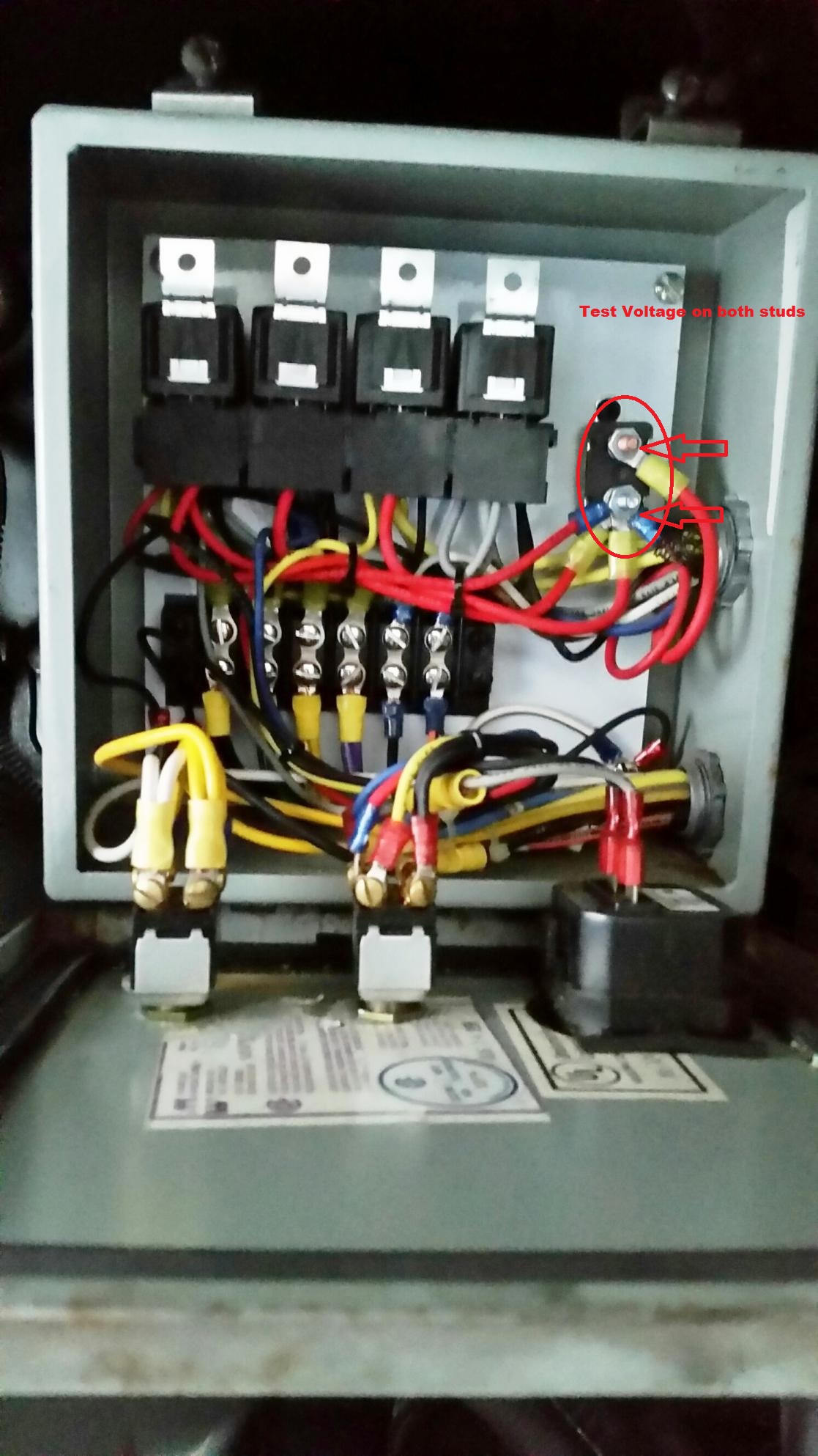

Hi Gary,
There is a Generator Actuator breaker, manually reset-able, in the front dash lower front load center, SK33. Inside the grey box with the in/out switch there's an auto-reset circuit breaker and two relays, on for in and one for out. I'd check SK33 and power on both side of the auto-reset CB in the grey box. Test voltage under load. I believe Chuck had a problem with his actuator, he'll probably chime in momentarily.

First check to see if the gen IN/OUT actuator switch works. then check if you have power at the top right terminal on the IN/OUT switch in the gen control box. Power across those terminals comes from the SK33 fuse and feeds the actuator motor. It should be a yellow 10ga wire labeled 'D'. If no power there, read on.
I did have the same problem. I have been unable to find a schematic for the gen actuator. I would check that Sk33 fuse to assure it is not blown. Also test the Auto Reset CB for available power at the top terminal. Then check the bottom terminal on the Auto Reset CB for power to assure the Auto Reset CB is good.
I had a short in the yellow line #D running from the SK33 fuse located in the lower dash panel in front of the passengers seat to the right top terminal on the in/out switch in the gen control box.
If the SK33 fuse is ok and there is power on the bottom terminal of the Auto reset CB, you may have the same problem as I had. You can
pull the SK33 fuse and temporarily jump to feed power from the Auto reset CB terminal to the top right terminal on the in/out actuator switch inside the gen control panel.
All this assumes your bus is wired the same as mine.......... If you are not electrically adept, have an electrician look at it.
