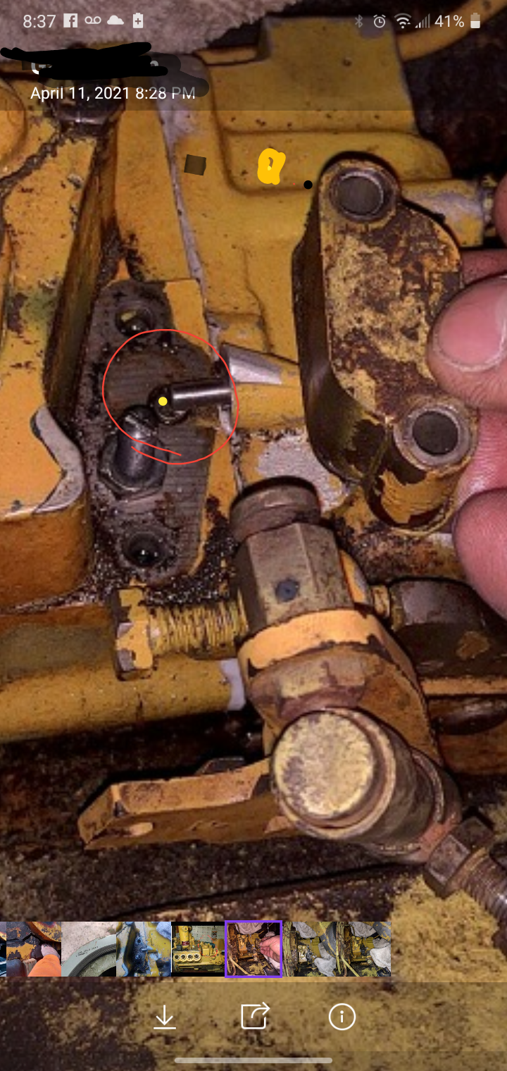

04-11-2021, 23:01 (This post was last modified: 04-11-2021 23:02 by cuttn4fun.)
RE: cat 3208 fuel leak
New member here searching for information on the 3208 i have. It is leaking diesel and thought it was throttle rod. Got that all replaced and still leaking. Took it apart to find it leaking at the spot circled in red.fuel is just bubbling up from the spot with the yellow dot under the small cover. Any help is greatly appreciated.
