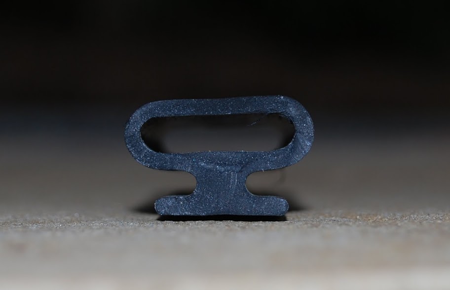

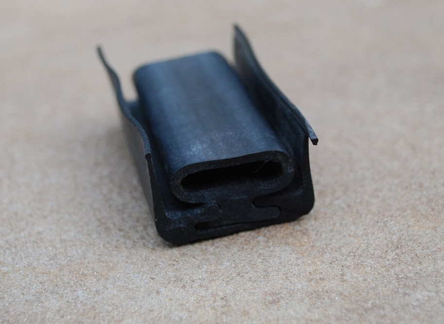

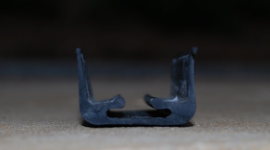

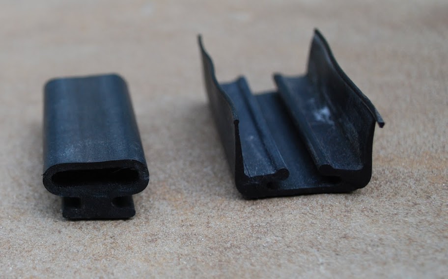

Hello all,
A while back Doc&Linda shipped to me a sample of an M380 slide seal with it's retainer. (Actually, I have almost the entire seal, it's missing just a few feet). Well, since then I dropped the ball. Suzana and I packed up the old house, bought a new house, and moved all of our belongings. We're pretty well settled in now so I'd like to get this started again. I've already snipped off a section and sent it to Roger Anderson at DRI. We know that there is a setup fee for extrusions. In this case there will be two extrusions. I'll speak with Roger early next week to get the current rates. The original seal uses a molded corner for the retainer. I know that we can't do that due to cost. If we don't do a molded corner then the retainer wiper will almost certainly kink in the corners. I suspect that this won't be an issue. A simple solution to the kinking is to take a scissors and make a series of cuts into the wiper at the corners. That may be all that's required. I'll discuss it with Roger. In any case I'd like to gauge interest. Can we have a show of hands as to who may be interested in contributing to offset the setup fees?

02-15-2013, 14:41 (This post was last modified: 02-15-2013 14:44 by davidbrady.)
RE: M380 Slide Seal Development
(02-15-2013 14:37)Robert Britton Wrote:  David, thanks for looking into this. I've been told (but have not verified myself) that OEM seals with the molded corners for the M380 are still available?? Mine is going on nine years old with no leaks so seems the original design is a good one. Has anyone looked into buying OEM replacements...pros--cons?
Hi Robert,
Welcome to the forum!
I don't know who the OEM is. Nonetheless, it is a good seal that people have few problems with. Once Roger looks at it I'll get his opinion as to whatever upgrades might be warranted. I know that if we do it thru DRI and if we do it without molded retainer corners, the price will be very attractive. Once again, DRI will make money at a reasonable profit margin and I have no financial interest. Now we need some M380 owners to volunteer! Smile BTW, the seal profile as shown in the third photo above is a standard profile in most air seal vendor's portfolios including DRI's and Seal Masters; however, the actual dimensions are slightly different from what DRI has stocked on its shelves, so a new extrusion will be required.

03-07-2013, 14:10 (This post was last modified: 03-07-2013 14:16 by davidbrady.)
While speaking with Roger today I had a chance to ask about the M380 seal development. There would be two setup fees, one for the retainer extrusion and one for the seal extrusion. These fees are $1300 each, or $2600 total. If we made it with no molded corners, Roger estimates we would be at around $400.00 retail for the air seal bladder and about $400 retail for the retainer. The OEM only used molded corners for the retainer - no molded corners for the air seal bladder. If we don't use molded corners for the retainer there will be some wiggling of the inner and outer wipers at the corners.
