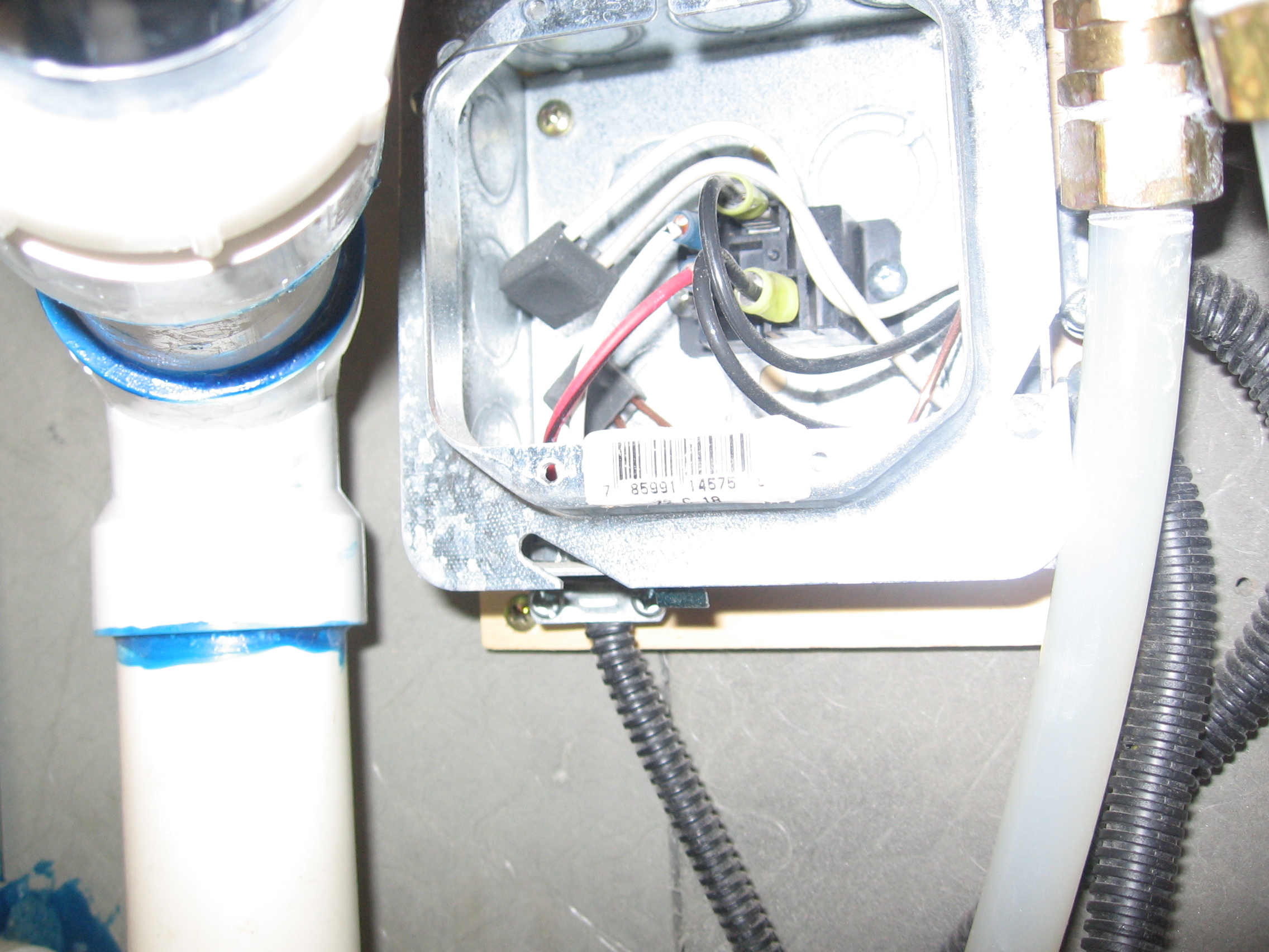

In the bathroom over the vanity are two thermostats, one labeled for electric heat and one labeled for hydronic heat. The M380 has two baseboard electric heaters, one is under the bathroom vanity and one is under the laundry closet doors. The electric thermostat will turn on the heater below the laundry closet doors but does not turn on the heater under the vanity. That heater under the vanity is connected to a solid state relay (I think that is what it is) located on the wall under the vanity. It appears that this relay is activated by a signal from a thermostat to close the 120V contacts and direct power to the heater. There is 120V at that relay coming from the bath elec heat breaker in the bedroom load center. My reason for describing the above is that I cannot find a separate thermostat for that heater. I’m in hopes that someone can tell me if it is controlled off the same thermostat that controls the other heater under the laundry closet doors or is there a separate thermostat for it somewhere that I can’t find? If both heaters are controlled by the same thermostat; does anyone know why the thermostat is able to send a signal to one heater but not the other as there is no control power at the relay with the thermostat turned all the way up. Chuck Chuck & Tela Millsap 2003 Prevost Marathon XLII 2000 LXi #2 S/S (Sold) 2004 M380 D/S (Sold) 2000 LXi #1 N/S (Sold |

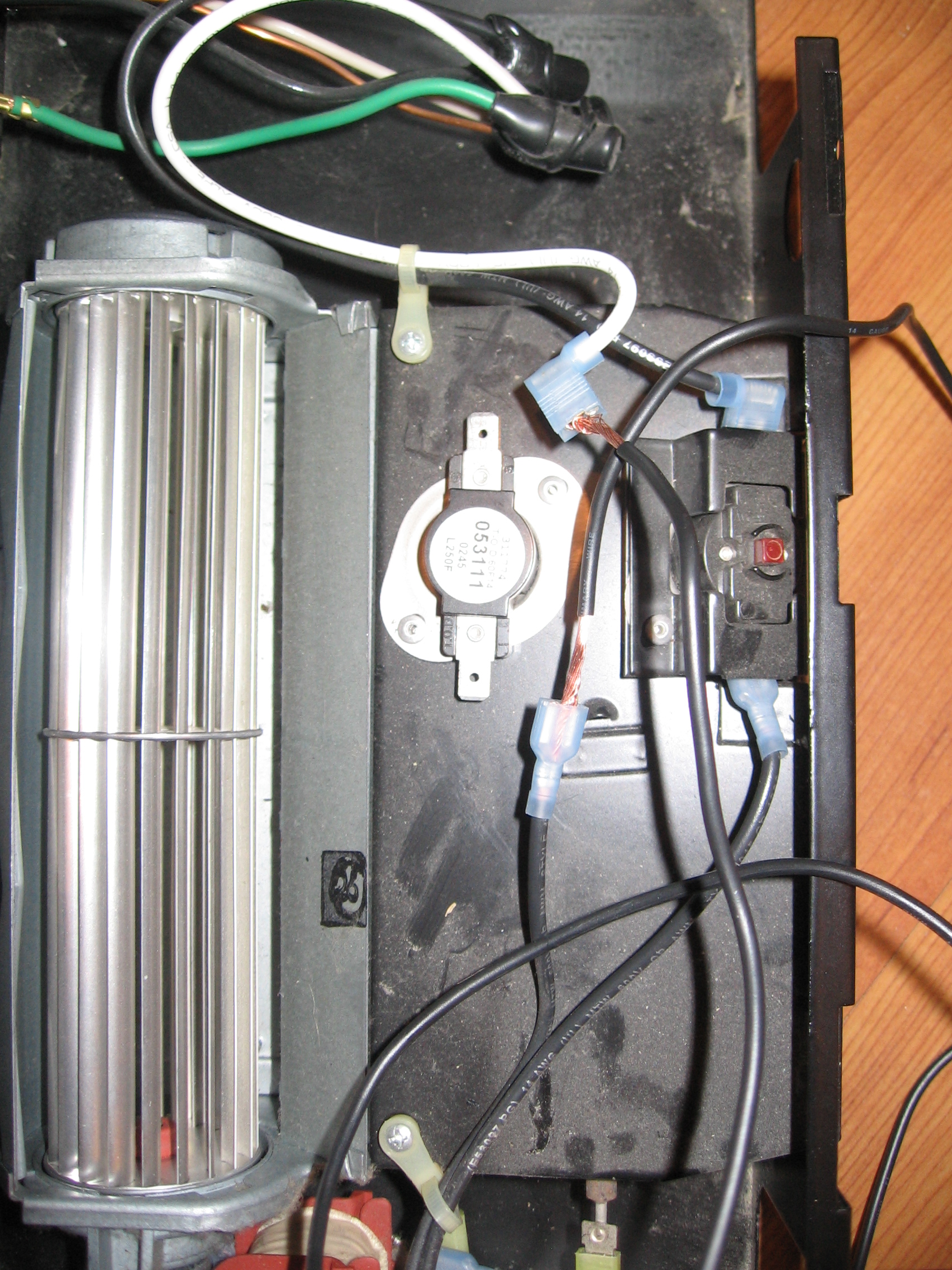

(02-18-2013 19:12)cmillsap Wrote: Tela and I just spent a few days in the coach in Las Vegas. The nites were cool enough that a little heat was needed. Since we were hooked to shore power, I decided to use the electric baseboard heaters instead of the hydronic heat. Well.....It seems to never fail with me. I can find the problem AFTER posting but not before. The thermostat in the bath does indeed control both heaters. I traced the problem to the heater itself. There is a little component in the heater that I don’t know what it is but it does not let the current past through it. It’s the little round white thangamagig in the center of the pic with the O53111 #s on it. Jumping it allows the heater to function. Anyone know what this is? Is it replaceable or do I just need to get a new heater? This is a Cadet Model UC heater. I guess I should call the manufacturer. Chuck Chuck & Tela Millsap 2003 Prevost Marathon XLII 2000 LXi #2 S/S (Sold) 2004 M380 D/S (Sold) 2000 LXi #1 N/S (Sold |

(02-18-2013 20:59)cmillsap Wrote:(02-18-2013 19:12)cmillsap Wrote: Tela and I just spent a few days in the coach in Las Vegas. The nites were cool enough that a little heat was needed. Since we were hooked to shore power, I decided to use the electric baseboard heaters instead of the hydronic heat. That look's like a thermostat to me! |

Yes, it's a snap disc thermostat. Available at lots of places including Graingers. Sometimes these Cadet's can get loaded up with lint and overheat. The snap disc then triggers shutting off the AC power.
Well Chuck, I'm glad you got it sorted out and thanks for taking us along for the ride!

(02-18-2013 22:35)davidmbrady Wrote: Yes, it's a snap disc thermostat. Available at lots of places including Graingers. Sometimes these Cadet's can get loaded up with lint and overheat. The snap disc then triggers shutting off the AC power. Well..... maybe we all learned a little bit about our heaters. I'm happy to see that BB went to the solid state relays in the circuits. My LXi had the old traditional relays with the open contacts in those circuits. Chuck Chuck & Tela Millsap 2003 Prevost Marathon XLII 2000 LXi #2 S/S (Sold) 2004 M380 D/S (Sold) 2000 LXi #1 N/S (Sold |

in my 90 i replaced all the electric cadet heaters. they are notorious for getting lint in and can catch fire easily. in fact there was a recall on them a few years ago.
you can get them at lowes btw. at least some of them. or online. they are easy to find. i found that the new ones might be a slightly different size. one was exact replacement and a couple of others required some "fitting" tom 2002 Two Slide Newell Coach 608 DD Series 60, Allison 6 speed |
