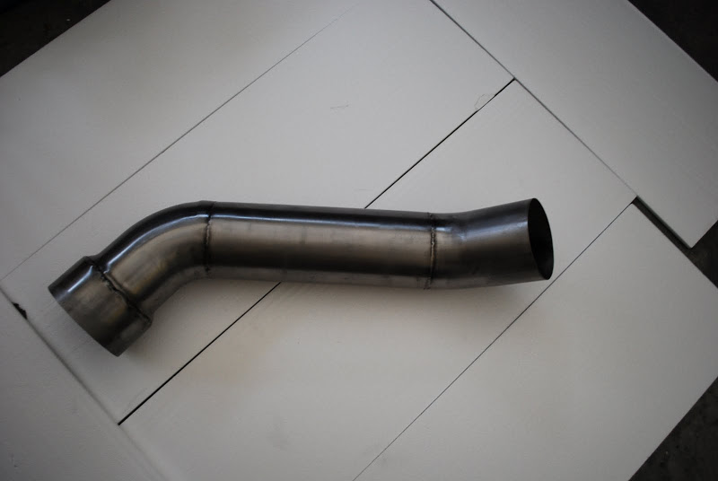

Folks,

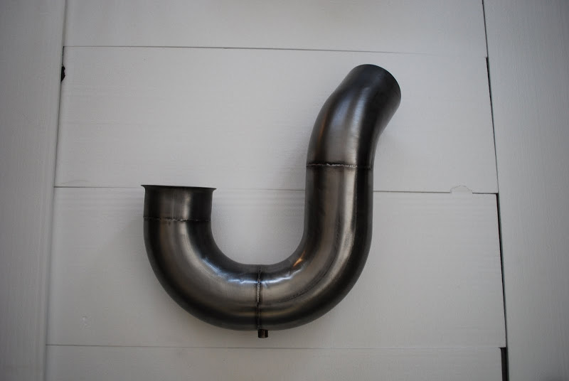

These stainless steel goodies are a drop in replacements for your existing OEM parts. They're available from: Roger at: http://www.bhtubes.com The material is 304 stainless, 16 gauge. These particular pipes have a brushed finish, and frankly could use a bit of cleanup. I'm sure Roger at BHTubes.com would polish them to a mirror finish if asked. The welds are beautifully stiched. The match between old and new is close to perfect. I use Westfalia's Triple-S flexible hose to connect the two. BHTubes also has replacement SS Steel exhaust tubes for the '95 thru '97 Series-60 equipped coaches. david brady, '02 Wanderlodge LXi 'Smokey' (Sold), '04 Prevost H3 Vantare 'SpongeBob' "I don't like being wrong, but I really hate being right" |

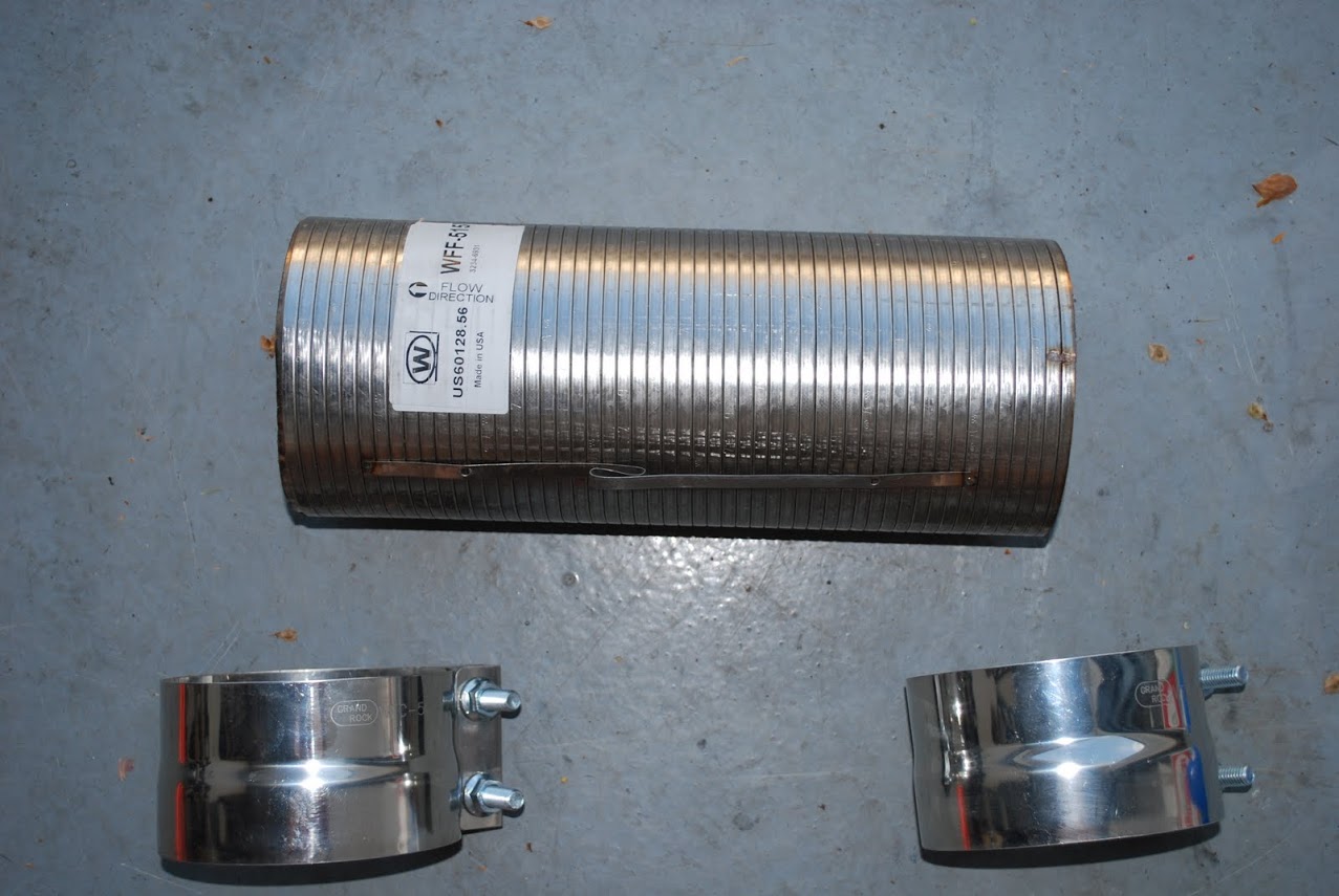

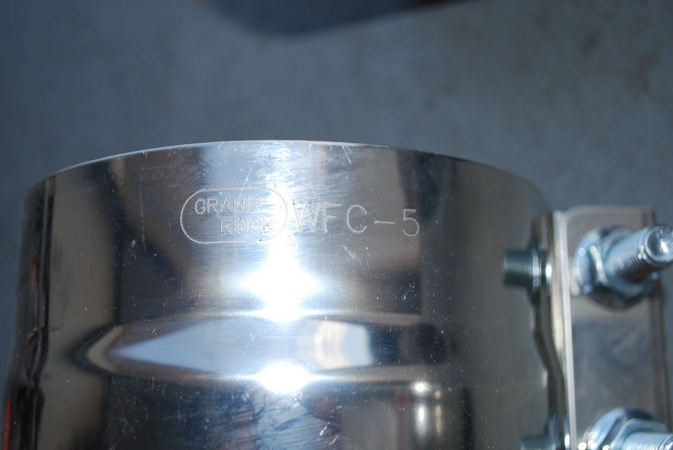

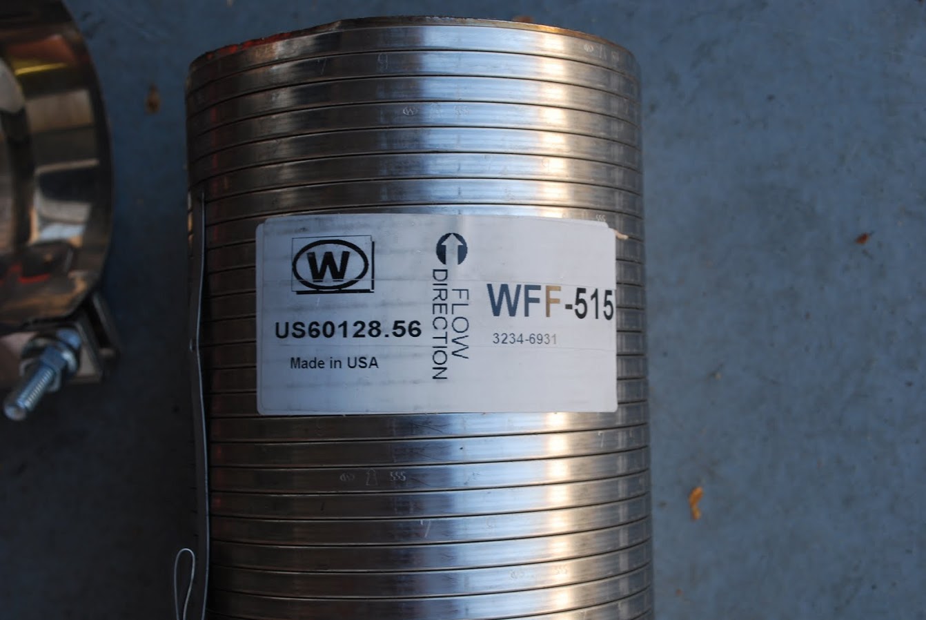

Folks,
The flex pipe and clamps I used are Westfalia Triple S pieces: Flex pipe: WFF-515 (2.5" overlap on each pipe, installed length is 15"), Clamps: WFC5 clamp (2). I run a Pittsburgh Power muffler. Back when I did my exhaust system I had Pittsburgh custom make a 51.5", 6" inlet/outlet muffler. They now carry it as a stocked item: http://www.pittsburghpower.com/product_i...108fe9675c david brady, '02 Wanderlodge LXi 'Smokey' (Sold), '04 Prevost H3 Vantare 'SpongeBob' "I don't like being wrong, but I really hate being right" |

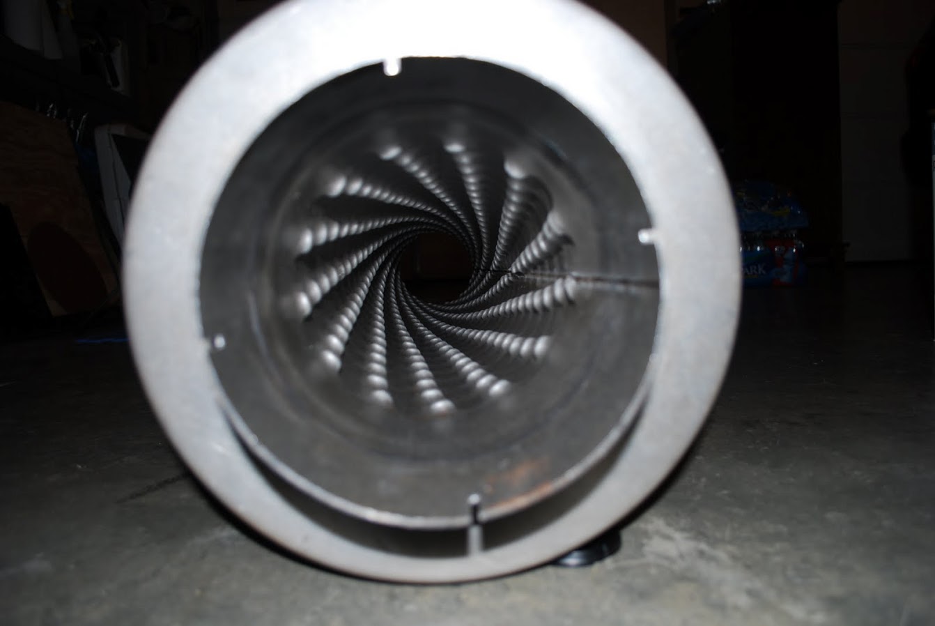

The clamp is complete, no flange assemblies required. You have the turbo, the s-pipe (both with flanged surfaces), and the Breeze V-Band clamp. No additional parts. I wonder if you're going to be happy with the muffler I used. The jake is pretty loud with that muffler; otherwise, it's acceptable. The noise police in California may have an issue with it. david brady, '02 Wanderlodge LXi 'Smokey' (Sold), '04 Prevost H3 Vantare 'SpongeBob' "I don't like being wrong, but I really hate being right" |

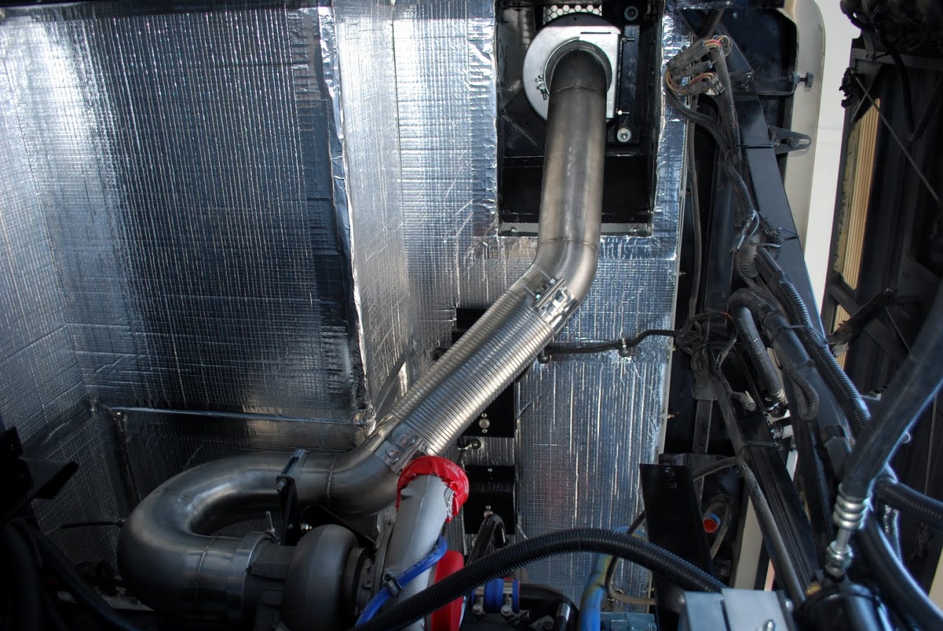

(03-19-2015 10:16)davidbrady Wrote: Chuck, Thanks again, David, I wasn't planning on replacing the muffler as I just replaced it last year with an original model muffler. I just wanted to be sure the distance from the bottom of your muffler was the same as it is with an OEM muffler. Any difference would effect the length of the flex coupling needed. After thinking about it tho, the bottom/intake end of your muffler must be located exactly where the OEM muffler was located, otherwise the tubes would not line up in a straight fashion as I see they do in the pics you posted showing the entire assembly. Chuck Chuck & Tela Millsap 2003 Prevost Marathon XLII 2000 LXi #2 S/S (Sold) 2004 M380 D/S (Sold) 2000 LXi #1 N/S (Sold |
03-19-2015, 11:01
RE: Stainless Steel Exhaust, '95 WB thru LXi
Any time Chuck,
![]() Yes, the Pittsburgh muffler is the same size as the OEM Nelson muffler which is the standard 51.5" long and 11.5" in diameter. All the pipes line up with either muffler. david brady, '02 Wanderlodge LXi 'Smokey' (Sold), '04 Prevost H3 Vantare 'SpongeBob' "I don't like being wrong, but I really hate being right" |
