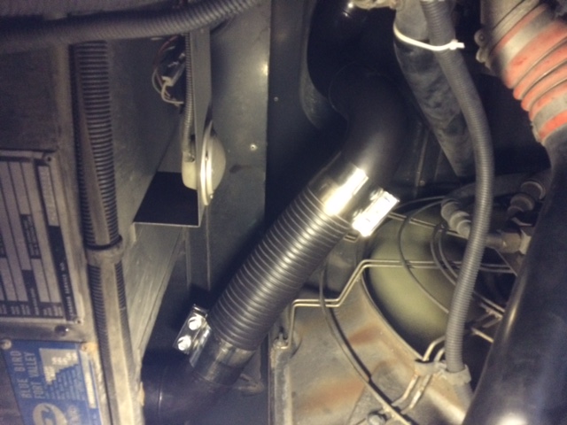

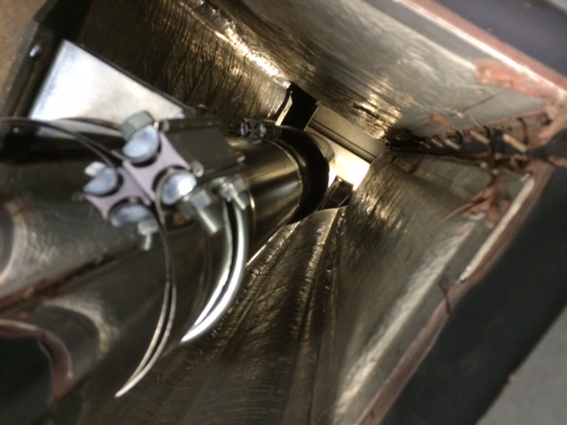

John, I recently purchased and installed a complete turbo to tip stainless steel exhaust system in my M380. It is ceramic coated to keep heat down and included a stainless steel "Aero" muffler, which has a significantly smaller diameter than the stock unit, allowing more air flow in the exhaust chase.
The system was custom built by A & W Productions in Texas. These are the people that fabricate exhaust for Peterbilt trucks. The person to speak with is a gentleman named Marshall Waters, and A&W's information can be found here.
http://aandwproductions.com/index.html
The price of the complete system for an M380 was just over $600.00 plus shipping.
FYI here are a couple of pics, first is looking down the chase with the Aero muffler in place and the second just shows exhaust routing through the engine compartment

That looks pretty good! That should really help with the bedroom heat the 380's see. What are your thoughts about the sound from the new muffler versus the old?
Thanks for both your inputs!
04-14-2016, 22:56
RE: Stainless Steel Exhaust, '95 WB thru LXi
The coach is a bit louder but not enough that it bothers me. I was actually hoping that it would be louder than it is!!
