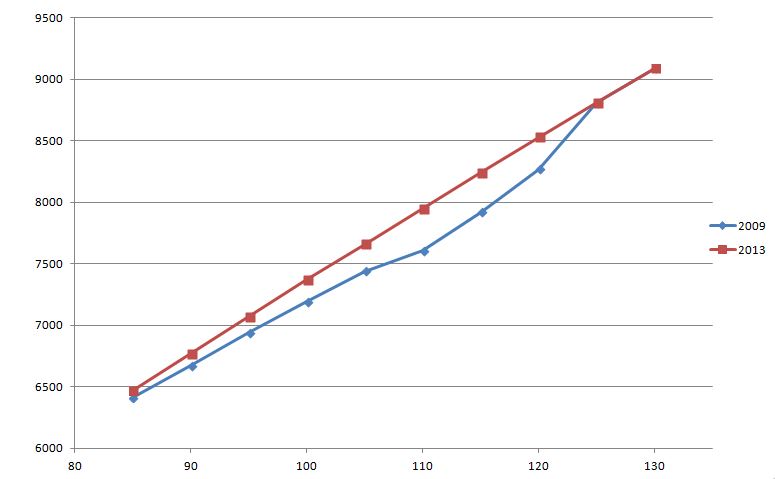

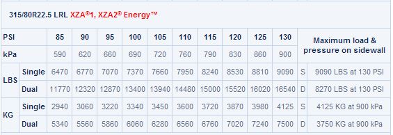

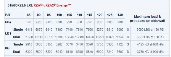

Has anyone else noticed that Michelin has changed their Load and Inflation Table numbers for the 315/80R22.5 LRL XZA1 and XZA2 Energy's? For example, if you need a 15220 lb load capability in 2009 you'd have to run 110 psi in your steer tire, whereas in 2013 you'd only have to run 104 psi.
The fact that the 2013 curve is linear makes interpolating easy. The formula for the steer axle is: PSI = (Axle Weight - 2740)/120. I'm at 14227 lbs on my steer, so doing the math puts me at (14227-2740)/120 = 95.7 psi. Which is great for me because I find that if the hot tire stays below 105 psi, the ride is MMMmmm Smooth! I run 95 psi on the steers and 85 on the drive and tags. Here's the table from 2009: Here's the table from 2013: Here I graphed the two for you: david brady, '02 Wanderlodge LXi 'Smokey' (Sold), '04 Prevost H3 Vantare 'SpongeBob' "I don't like being wrong, but I really hate being right" |

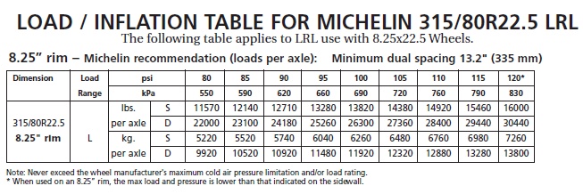

One cautionary point of note here since I just bought new front tires - the Load and Inflation Chart being referred to here is valid for the default 9.0" wide wheel. While I know most of the later model mid-90s onward have the 9" wheel, the earlier ones have 8.25" wheels. The Michelin 'alternate' acceptable 8.25" wide wheel has much lower load factors. The max load on that tire/wheel combo is 8,000 lbs at 130, going from memory. One of the Michelin Tire Application Charts has a footnote that basically says something like: Contact Michelin before installing 315/80R22.5 LRL XZA2 Energy on 8.25" rim. Of course the 8.25" rims are rated for anywhere from 7200-7300 depending on when manufactured! Since I was curious about that footnote, I called them. They just wanted to make sure users were aware there was a different Load and Inflation Chart for the 8.25" wheel and that the load ratings were much lower.
As I alluded to, it's all kind of a moot point for earlier Birds, since the axle and wheels are rated for 14,600/14,500 prior to mid-90s depending on which wheels you have. I went with the 315s anyway due to much better general availability versus 12Rs, they are about $60 each cheaper than the 12Rs, and the higher load rating (for safety), even if I don't get the full benefit of it. FWIW, Mike Bulriss 1991 WB40 "Texas Minivan" San Antonio, TX |

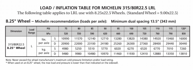

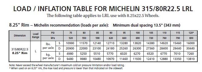

(05-12-2013 18:06)mbulriss Wrote: The max load on that tire/wheel combo is 8,000 lbs at 130The 8.25-inch rim is only rated for 120, so it is 8000 at 120. Michelin puts the 8.25-inch table in each book, and I happen to have 2007, 2010, and 2013 books on hand, so images for the 315s on 8.25-inch rims are attached. A cursory reading does not indicate any weight changes, except 75PSI values were added between 2007 and 2010. They also changed the minimum spacing from 13.2 to 13.5 inches between 2007 and 2010. My drivers have 13.0-inch spacing. I would not have put 315s on there, but Chuck did, and I'm not going to replace new tires, so I run 100PSI on them when 80 is nominally enough. As I recall, Shane has been doing that for years. Don Bradner 2004 M380 Double Slide 1990 WB "Blue Thunder" Sold My Location |

It probably isn't an accident that they raised the separation minimum at the same time they added a lighter weight/pressure (75PSI). It would imply that higher pressures need less separation, but it is hard to know what pressure is correct for my 13.0 inches. When I get down there and look at the bulge there is about 1/4-inch of separation, which likely means they touch when I hit a bump.
I've got my Truck Systems pressure monitors to let me know that I don't get down on pressure. Don Bradner 2004 M380 Double Slide 1990 WB "Blue Thunder" Sold My Location |
