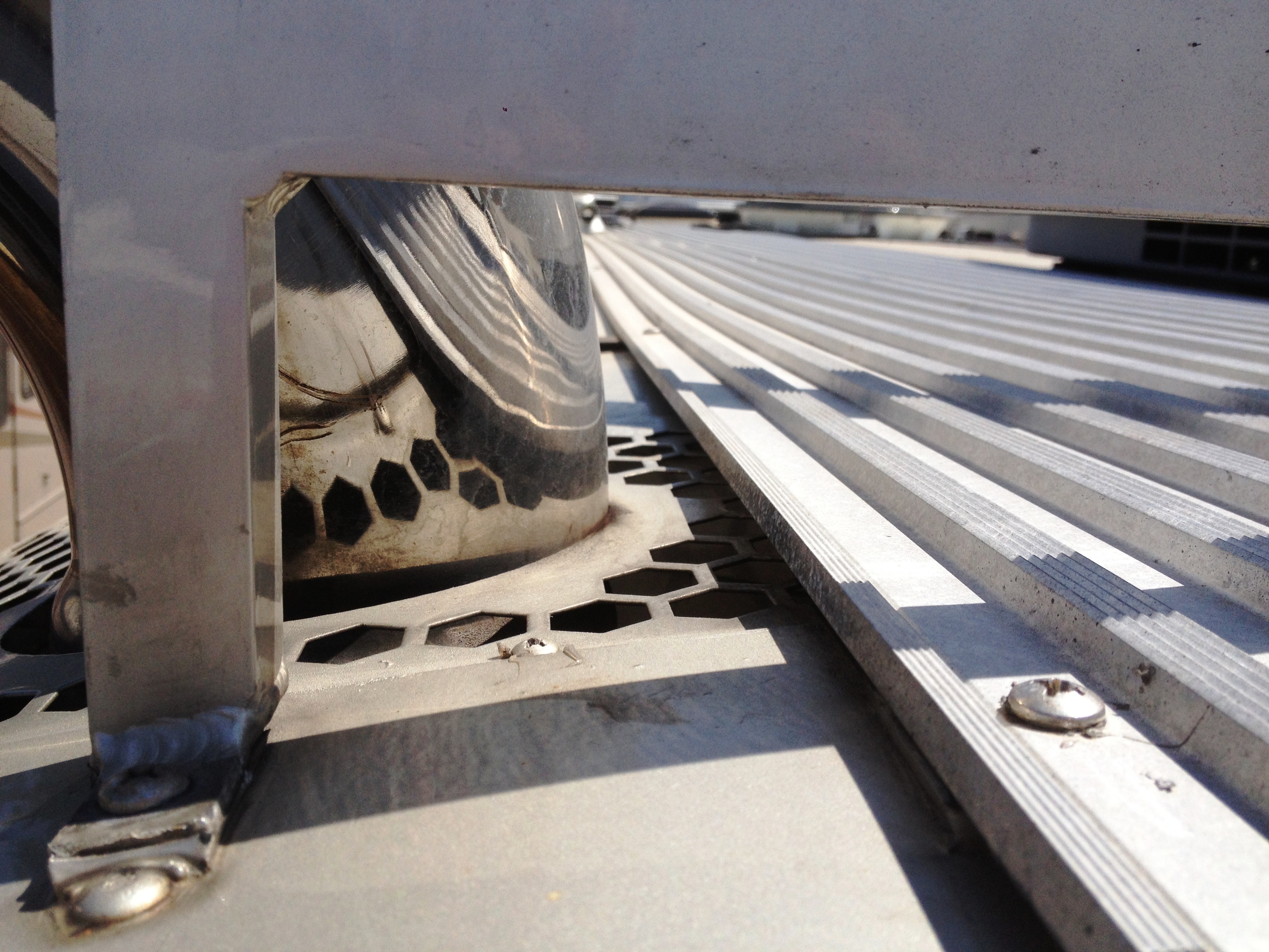

EDIT! Edit! They sent me a photo of the preforated plate. It is not the goat rails! It is the corrugated walkway running over about 4"s of the preforated plate. Should I let them cut out a section of the corrugated walkway or is thery another way to get the preeforated plate off so they can get to the top muffler hanger?

06-13-2013, 19:24
RE: Muffler Removal
Heres a photo showing the walkway over the access plate
06-13-2013, 19:24 (This post was last modified: 06-13-2013 19:58 by davidbrady.)
RE: Muffler Removal
Chuck,
That's right the perforated plate is slightly obscured by the corrugated walkway. I'd let them notch a section out of the walkway. They should be able to do that easily with an angle grinder or a skill saw with a cutting blade for aluminum.
While in there have them grind off a sliver of the perforated plate so it's not rubbing up against your exhaust stack. :-)

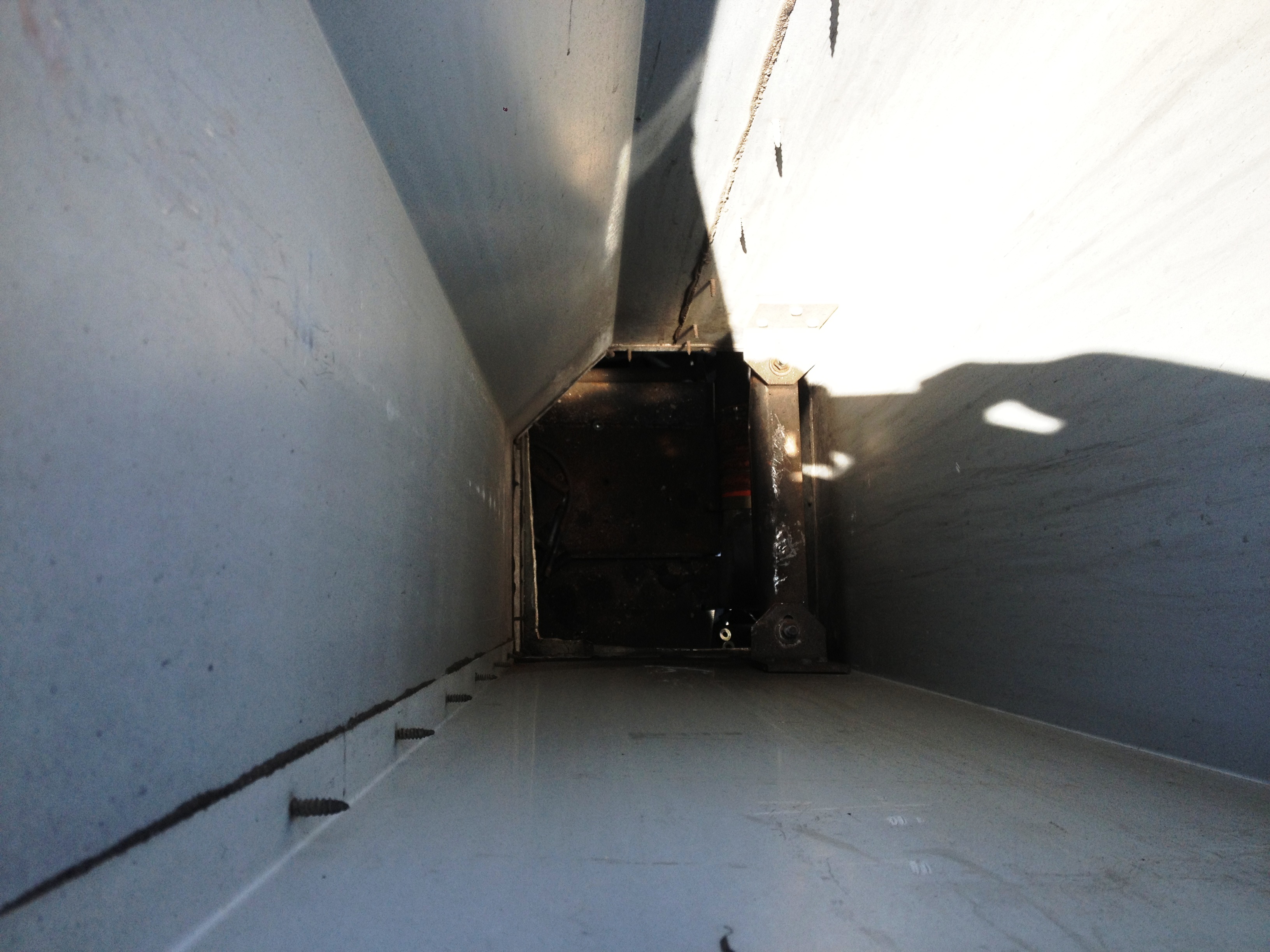

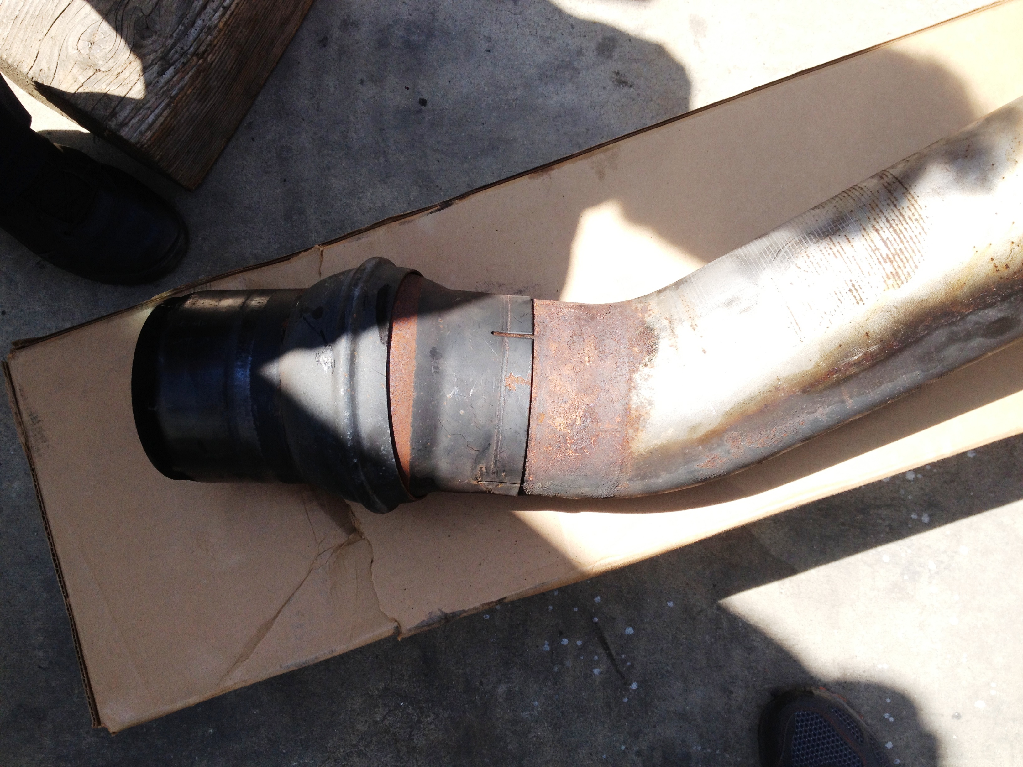

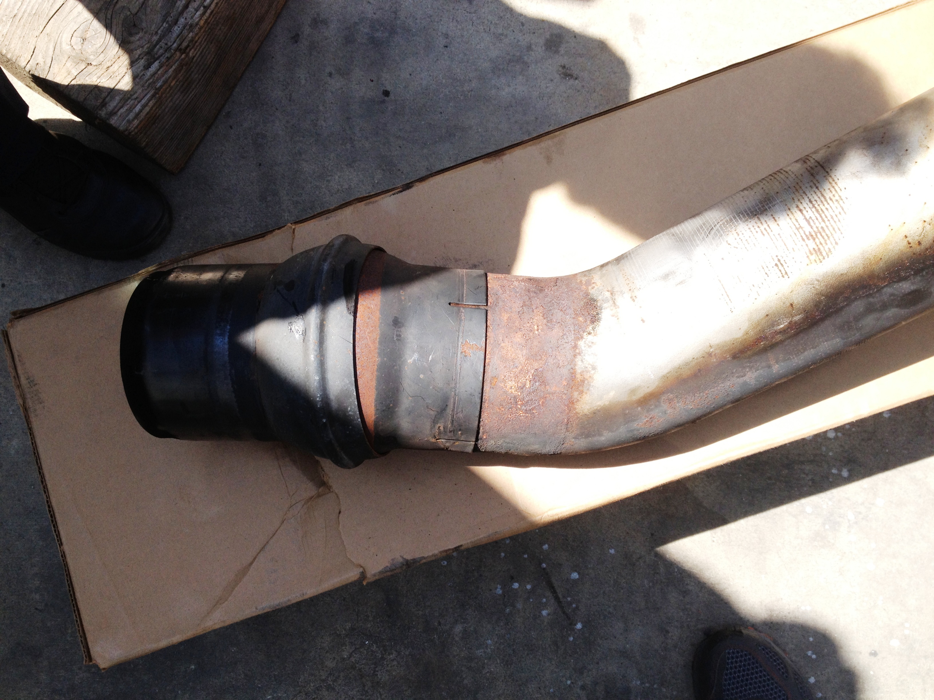

İmage İmage The mechanics are suggesting using Flex pipe in place of the pipe slip union which should be OK?
The muffler chase walls have no insulation on them. Is this the way BB did them originally. While the muffler is out, should I have the walls insulated with the same insulation that covers the engine bay surfaces or is it not needed?
06-14-2013, 18:28
RE: Muffler Removal
It's looking good Chuck!
Yes, definitely go with flexpipe, the original double-ball socket flex never worked very well. It develops rust which prevents movement and it inevitably leaks where the cup and ball sockets overlap.
I wouldn't insulate the engine walls. If you open a cabinet in the interior you'll see that BB covered the exterior of the chase with blow-on expandable insulation. With no insulation there will be an air gap between the muffler and the interior walls of the chase. After a hot run the chimney that the air gap creates allows for efficient ventilation and cooling of your engine compartment. I've been on my roof after a hot run and the wind (convection currents) blows out the top of the chase as if there's a fan running!
