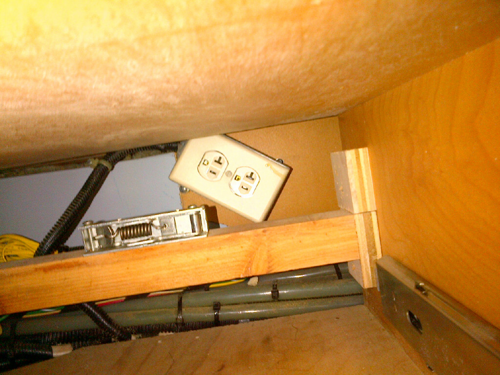

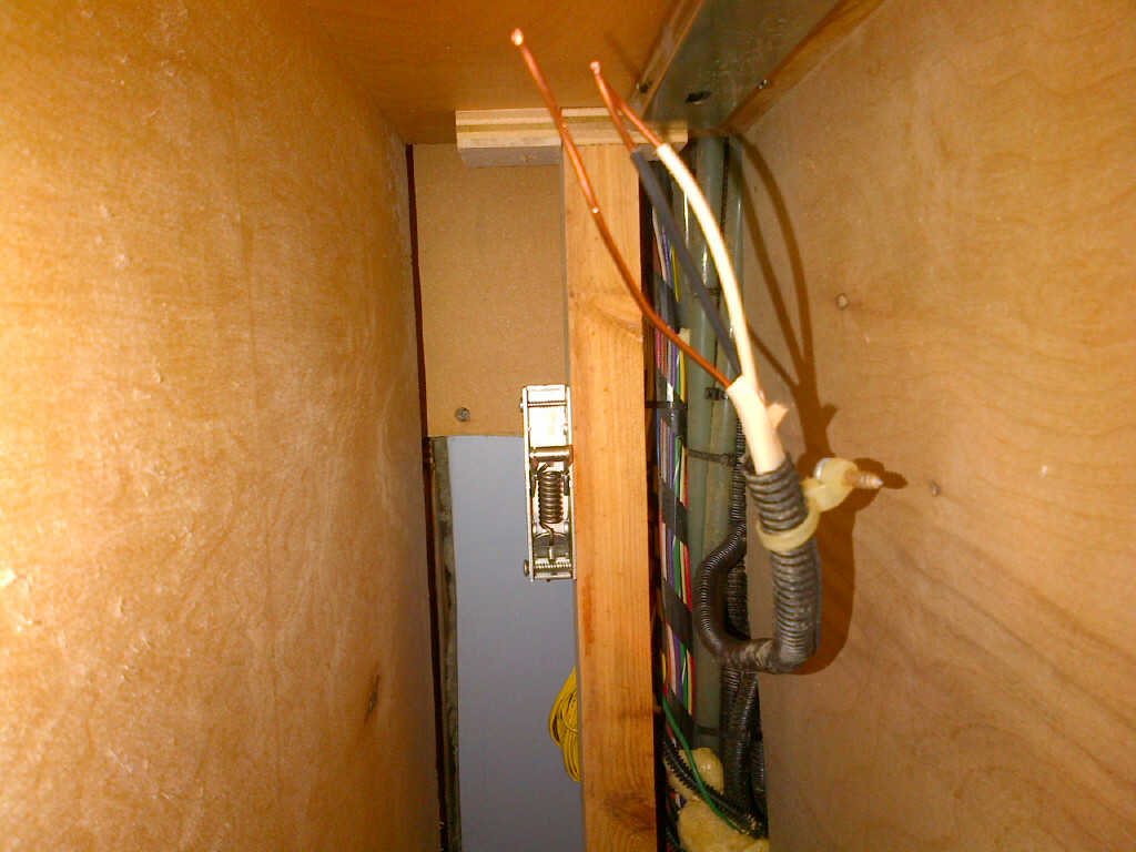

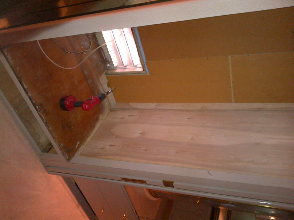

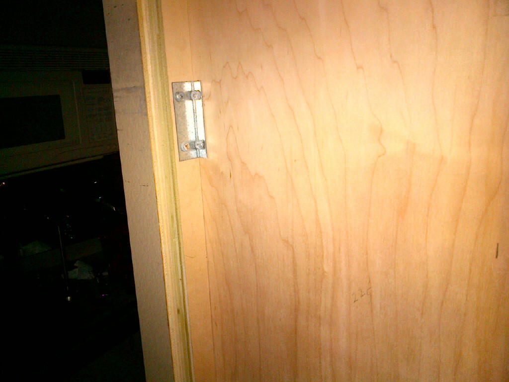

Made more progress on refer replacement today. Moved electrical outlet to below deck (in rear of slide out drawer). Capped off gas outlet, and removed plywood box around access door. Also, took out top cabinet so I can mount fridge on top of drawer space. İmage İmage İmage İmage

It looks really clean Corey. Thanks for the photo update. How much vent room on either side of the cavity will the RF197 leave you?

Concerning the vent room on the sides, the new fridge wouldn't fit in the exact cavity left bu the Dometic. It is about .25" wider and 3.5" taller (as I recall). Because there are actually two boxes built for the Dometic (to create the aforementioned sealed box), removal of the inner box gave me and extra 3" to play with (this is the cavity you see in the previous pics). Therefore, I expect 3" -.25" = 2.75"/2=1.375" of air space on each side of fridge. There new fridges seem to do all their cooling and exhaust from the front/bottom of the unit, so I feel there is no issue there. The extra height will be gotten from the removal of the top little cabinet (it was useless anyway). Here is a close up of the front of the cabinet that shows the space gained on one side (with the inner box, the plywood was flush with the side of the opening). İmage There will also be some air space in the rear. The biggest question mark left is how to secure it in its new nest????????????HuhHuhHuhHuhHuhHuh
