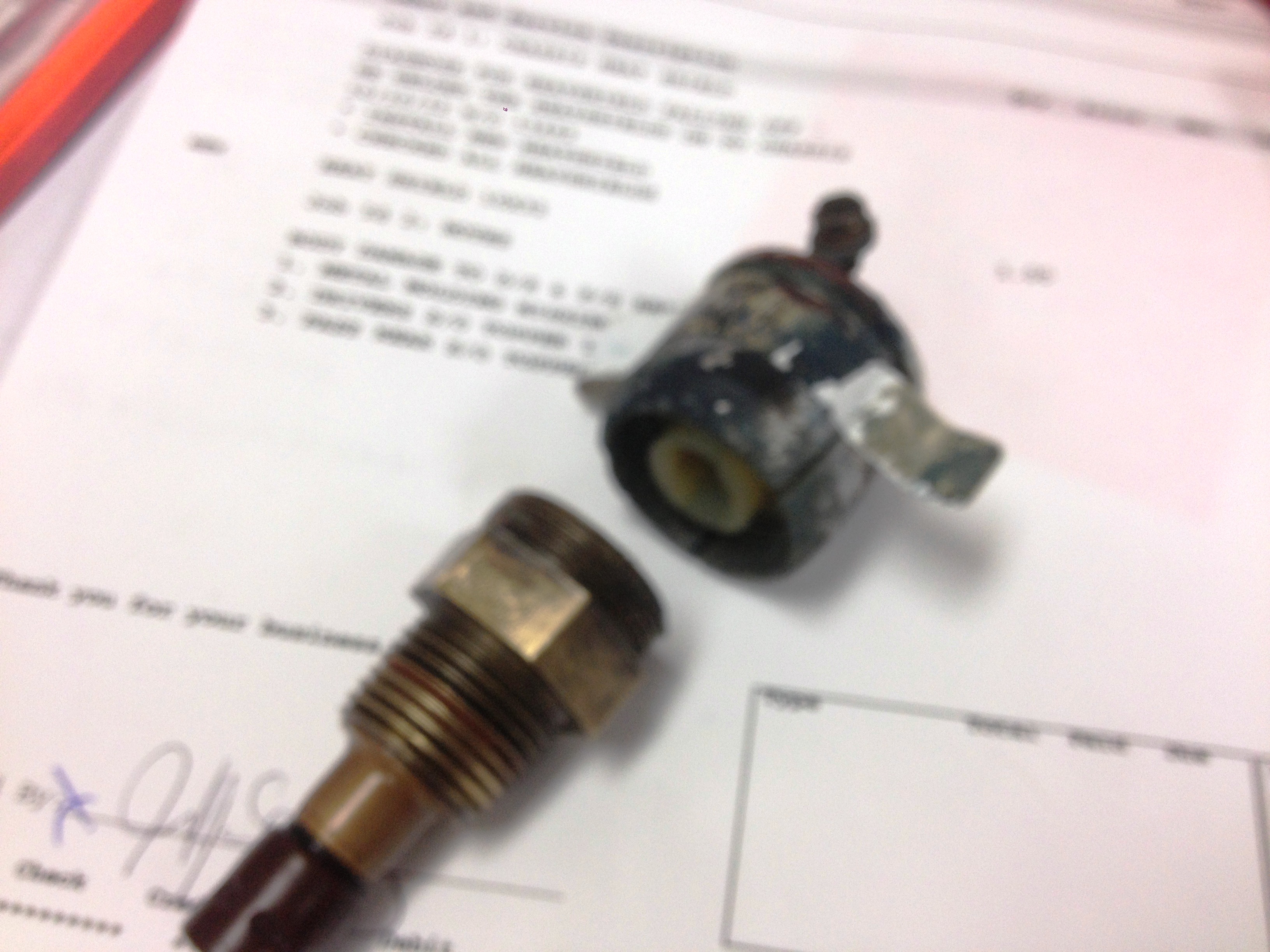

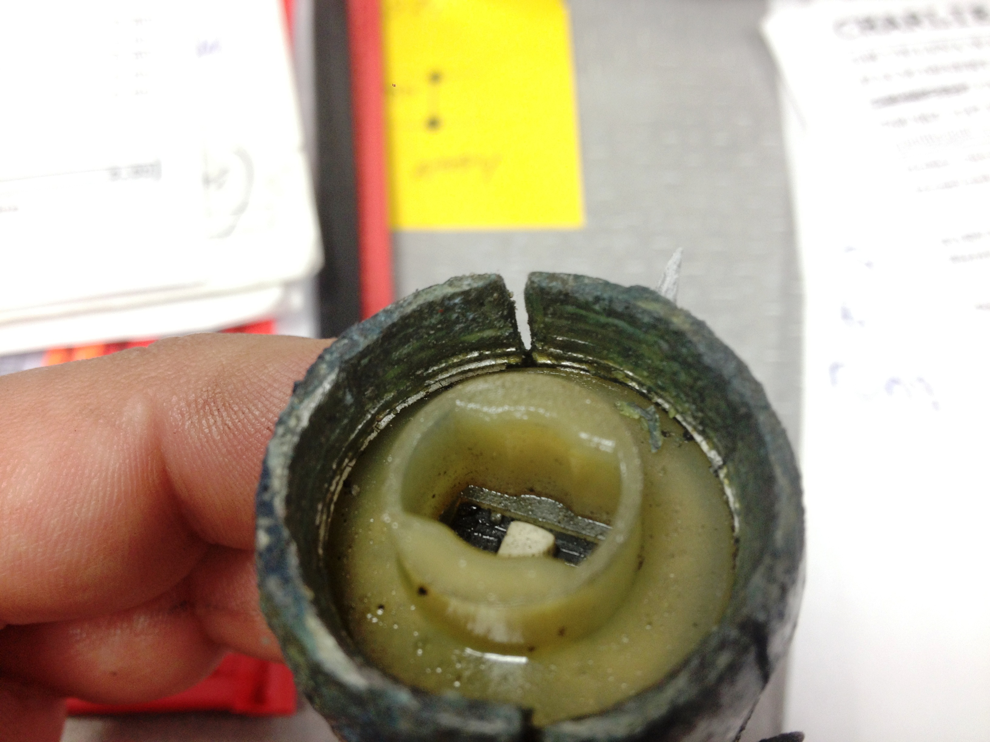

We have been searching for the 160* sensor that is located on the bottom of the blue hyd oil reservoir. It has two lead wires that connect to a terminal board in the engine compartment. The wires then disappear into a wiring harness. We believe it to be the hyd oil overheat alarm but are not sure exactly what its function is. Connectiing the wires (at the terminal) that the sensor is normally wired to does not activate any warning lights on the dash. Nor does disconnecting those same wires activate any warning lights.
Can someone tell us what that sensor does and where we can get a replacement? It would be very much appreciated.

Finally! With David's help we found a source for the Hydraulic Oil Temperature Aquastat/Switch/Sender. This part is attached to the bottom of the Hydraulic Oil (Blue) tank. It turns the Hyden Fan on when the hydraulic oil temperature reaches 160*F and turns it off when the oil temperature is reduced to 153*F. It is manufactured by Index Sensors and the part # is 8037090P. The part has 1/2" NPT threads. It has 3 leads that make it capable of being used either as N.O or N.C.
This particular sensor is not a stock item and is built to order. There is a 2 weeks lead time from the manufacturer. The price is $169.
We were fortunate to find that Peterbuilt happened to have one in stock in their parts warehouse; so we will receive it overnight.
