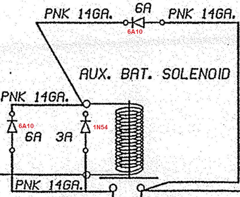

Mike, Here's a wild guess. Since the tech isn't a Wanderlodge expert it's possible that he may not have wired things up properly. You said he replaced a solenoid. I suspect the solenoid he replaced is the 'aux batt' solenoid. There are two diodes on that solenoid (actually three but one is for flyback current) that allow the dash switch or the engine start circuitry to enable the 'aux batt' solenoid. If he failed to wire in the diodes or if they're reverse biased then the solenoid won't be turned on as it should. When the engine is started the chassis batteries act thru one of the diodes to turn on the solenoid thereby connecting the house battery to the chassis battery banks. Here's what I'm thinking. The 50DN alternator sense wire may be wired to the chassis batteries, but the alternator charges the chassis batteries thru the 'aux batt' solenoid. If the solenoid isn't automatically activated while you're driving (aux batt LED on the dash is off), then the 50DN is always reading a low voltage. Since it's reading low, the 50DN voltage regulator cranks up the field current which results in the 50DN putting out excessive voltage. Guess where all this voltage is going? That's right, to the house battery bank. In short, your 50DN may be boiling your house bank because it's using the chassis bank to sense voltage but the chassis and house banks aren't connected due to incorrect or missing circuitry at the 'aux batt' solenoid; hence, all the 50DN power is going to the house bank with no voltage regulator feedback. david brady, '02 Wanderlodge LXi 'Smokey' (Sold), '04 Prevost H3 Vantare 'SpongeBob' "I don't like being wrong, but I really hate being right" |

Here's what the diode configuration around the 'Aux Batt' solenoid should look like. I penciled in the diode part numbers in red: You should be running a Delco Remy voltage regulator part number: 19020413. I see now that this part number has been superseded by: 10503807 Here's a Delco Remy document, from our Document Library, on retrofitting the 10503807 Voltage Regulator: Delco Remy 50DN Voltage Regulator. Here's a document from our Document Library that shows how to test the Alternator: Series-60 50DN alternator test. Here's a document from Blue Bird (also in our Document Library) that suggests a modification to the voltage regulator wiring: Voltage Regulator Wiring Modification. The new voltage regulator, 10503807, is five wire: Field, Ground, Battery, Ignition, and Sense. The relay in this document is no longer necessary since there is a relay built-in to the voltage regulator for the VR's Ignition terminal. Notice how this document suggests moving the Sense/Battery wire from the chassis battery bank to the coach (house) battery bank. George Morris (Ex Blue Bird employee and Wanderlodge expert extraordinaire) suggests that the Battery and Sense leads be connected to the first insulated stud on the aluminum heat shield where the alternator output connects directly. It's best that this connection be made thru a fuse or a 15A circuit breaker. For better or for worse the 'Aux Batt' solenoid is the original Wanderlodge configuration interfacing the chassis and house battery banks. Someday it'd be fun to review this setup and to possibly isolate the banks better with Battery Isolators, or similar technology. A Battery Isolator will allow the Xantrex chargers or the 50DN alternator to charge both banks but it won't allow one depleted bank to discharge the other bank. There's definitely room for improvement over the original design using standard and available technology. david brady, '02 Wanderlodge LXi 'Smokey' (Sold), '04 Prevost H3 Vantare 'SpongeBob' "I don't like being wrong, but I really hate being right" |

Two votes for the new regulator not being rewired properly to retrofit the bird's electrical system, I believe David may have nailed your initial issue. This has been seen before. Also, if you and he (your mechanic) have time I'd disconnect each battery both the chassis(group 31"s) and the house (4D's) and load test each one as well as meter each one for voltage. Each cell of a battery you loose will drop you 2 volts per cell/batt......... overcharging batteries, even new, will cause them to prematurely fail and short inducing new issues you did not have before and cause both you and he to "chase your tail", install more parts, etc......................good luck and sorry you missed you special trip.......it is a bummer!
