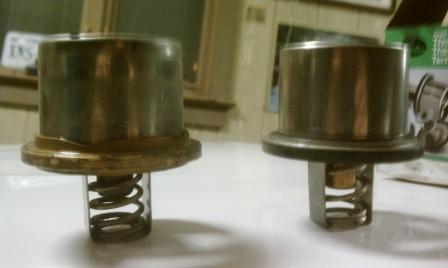

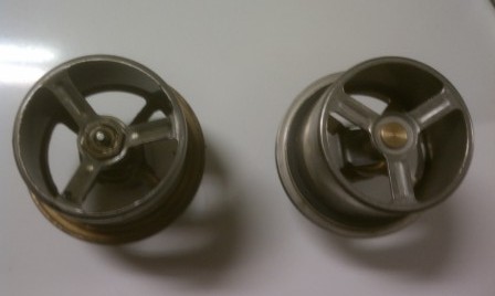

Weir Stat thermostats - markusfmeyer - 02-18-2013 22:47 Anyone here bought Weir Stat thermostats? I have been searching, found supposed part numbers, but when they arrived, they say Gates on them. I was surprised when I pulled the old ones out, they say Weir Stat on them, so were already changed at some point in time. But I can't seem to locate genuine new ones? RE: Weir Stat thermostats - davidbrady - 02-19-2013 00:04 Markus, I think Gates makes all the Weir-Stat thermostats. How do the new ones compare to the ones you removed? RE: Weir Stat thermostats - markusfmeyer - 02-19-2013 00:09 David, I will have to take pictures but they don't seem the same. For one, when I put the new ones in the hole where the old ones were, they wiggled a little. The old ones almost "locked" in place. Plus the insides seemed different, but I don't remember exactly what it was, will have to post side by side pics. I am considering reusing what I have, since they were obviously not original and say Weir Stat right on them, but with no part numbers. RE: Weir Stat thermostats - davidbrady - 02-19-2013 00:40 Markus, Gonefishen, over on the dieselenginetraders site, says: "To my knowledge all thermostats sold are of the 'Weir Stat' type. The only stat used are the older ones on the 53 series, 110 series, and the rapid warmup stat used on some 71/92 series and the inline engines. BTW a 92 stat works on the Series 60 and vise versa". So the 92 and S60 tstats are interchangeable. According to those guys this is the part number: 23503825 http://www.ebay.com/itm/Detroit-Diesel-180-Degree-Thermostat-Part-23503825-/300558649940 RE: Weir Stat thermostats - davidbrady - 02-19-2013 10:34 Markus, this came from here: http://www.stant.com/Parts-Locator/ I searched on DD part no: 23503825 RE: Weir Stat thermostats - davidbrady - 02-19-2013 15:04 Markus, in that ebay ad I posted earlier there's another part number listed: 4R313-403 If you look closely at the pics in the ad the tstat does have "Weir-Stat" stamped on it. RE: Weir Stat thermostats - markusfmeyer - 02-19-2013 21:49 (02-19-2013 15:04)davidmbrady Wrote: Markus, in that ebay ad I posted earlier there's another part number listed: 4R313-403 David - yes, I see that now. But, I also see it looks just like the ones I got, that don't say Weir. Hm.... Also, following this link, the S60 and V92 don't list the same part numbers: http://www.gates.com/catalogs/fleet/DetroitThermo.pdf I dunno. Here are pictures of the "old Weir" I pulled out and the "new Weir" side by side. There are differences in each picture, can you spot them? RE: Weir Stat thermostats - davidbrady - 02-19-2013 22:22 Hey Markus, Yes I see some obvious differences at the pin and the collar. On the old one the Weir's are formed into the collar. The collar on the new one doesn't appear to have any weirs. On the new one, are the weirs on the barrel? Weirs are just notches. Can you identify any weirs on the new one? Maybe a close up of the inside of the barrel in the vicinity of the collar. Standard-Thomson invented the Weir-Stat. They filed a patent on it which I'm sure is long expired. Gates bought Standard-Thomson. 'Weir-Stat' is a copyrighted name. Stant also makes Weir stats but probably can't use the 'Weir-Stat' name. I'm sure others make them too. RE: Weir Stat thermostats - markusfmeyer - 02-19-2013 23:01 I think I see notches in the picture. RE: Weir Stat thermostats - davidbrady - 02-20-2013 00:34 This is a Gates 33578, right? Yeah, those are the weirs - they're stamped into the side of the barrel. It's a Weir! The Gates catalog talks about the bottom collar. It's three pieces, two rubber rings and a bead. The bead get's cinched down between the rubber seals. Sounds like the little bit of play that exists (side to side motion at the collar) is so that the barrel can ride concentrically within the upper rubber seal (self centering), also the three piece collar probably flattens out some as it gets clamped into place. Use them! They're good!
