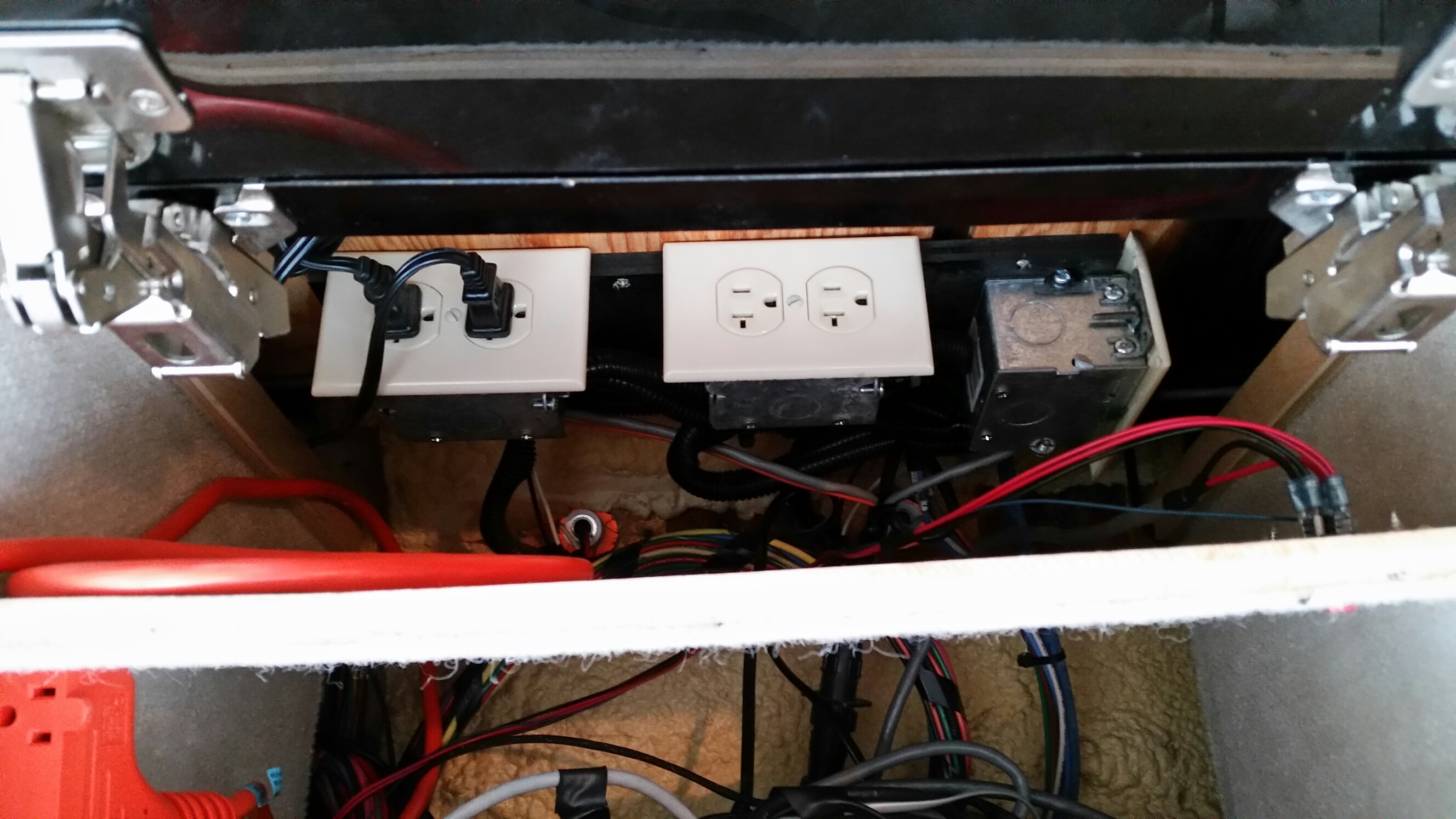

Thanks everyone,
One of the problems with replacing the Audio & Video components while doing an update is finding where they are plugged in. Here’s another bit of information that may be helpful to others who intend to update their audio & video components. The 120vac outlets that power everything are hidden behind the ceiling of the center compartment. Remove two screws in the rear panel and remove it, then the ceiling panel will slide toward the back of the compartment and down. See Pic.
