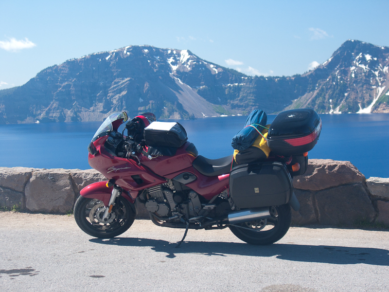

I also found a photo of one of my previous bikes, a 1996 Triumph Sprint 900 triple, at Crater Lake. Both of these photos are from 2005 on my way down to Laguna Seca for the return of MotoGP. I was confused initially because I've gone to Laguna Seca 3 times and I first thought these were from my 1999 trip to see World Superbike.
