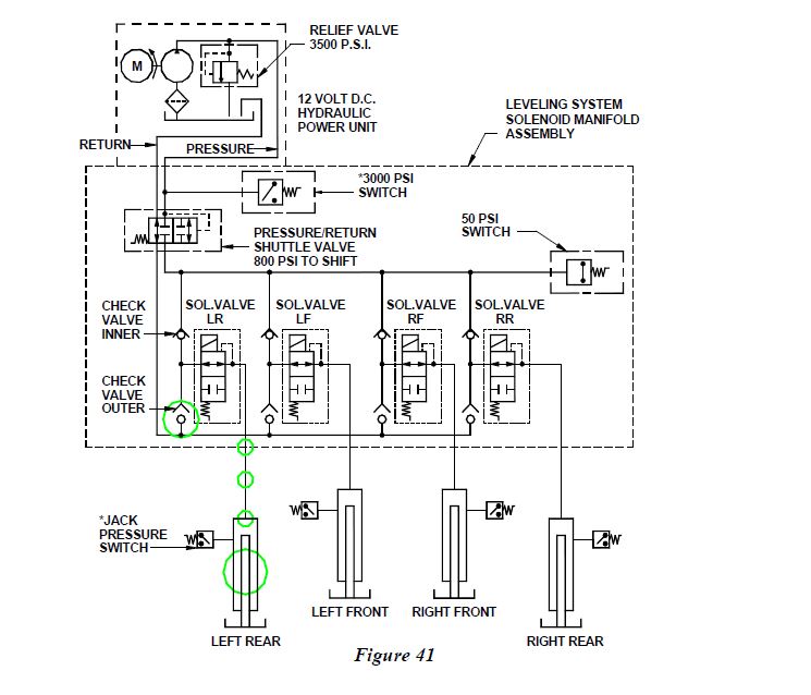

It seems odd that all four solenoid valves would fail simultaneously. The only other valve that's common to all four jacks is the Pressure/Return Shuttle Valve as shown here:
I guess I could piece together a scenario to explain the failure. If you had the air suspension raised and you deployed the jacks to the extent of illuminating the excessive slope led, and if the fluid level in the reservoir were already low, maybe you sucked some debris in from the reservoir bottom and the shuttle valve clogged and malfunctioned. I know, lots of guessing. I'll see if I can dig up a part number for the shuttle valve or maybe it can be removed and cleaned. Remember when you check the fluid level in the reservoir all the jacks and the slide need to be retracted. I think you've already gotten the hint to lower your suspension before deploying the jacks. The reverse is true too: air up your suspension before retracting your jacks. This prevents the bus from dropping onto it's bump stops as the fluid is pushed out of the jacks. david brady, '02 Wanderlodge LXi 'Smokey' (Sold), '04 Prevost H3 Vantare 'SpongeBob' "I don't like being wrong, but I really hate being right" |

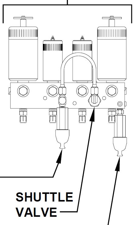

The shuttle valve is part number: RAP7964 and the price should be around $54.00. If you look at the HWH manifold with the solenoid valves, the shuttle valve is at the top and looks like a hex head. I'll dig up a pic. A little more on the shuttle valve: The shuttle valve is located on the leveling system hydraulic manifold. (See MANIFOLD HYDRAULIC) Fluid flows from the pump to the manifold, through a fitting on top of the manifold, through a U shaped tube to a fitting on top of the shuttle valve, then into the manifold to extend the jacks. The fluid flows from the manifold through the shuttle valve back to the pump when retracting the jacks. The shuttle valve is a hydraulically actuated valve. When the pump is running, the shuttle valve shifts to allow the the fluid into the manifold. At the same time, the shuttle valve closes the path for fluid return to the pump. It takes approximately 800 p.s.i. to shift the shuttle valve. When the pump shuts off, the shuttle valve should shift back to the off position. This will allow fluid to flow from the manifold to the pump when the jacks are retracted. The shuttle valve is a replaceable part. david brady, '02 Wanderlodge LXi 'Smokey' (Sold), '04 Prevost H3 Vantare 'SpongeBob' "I don't like being wrong, but I really hate being right" |
