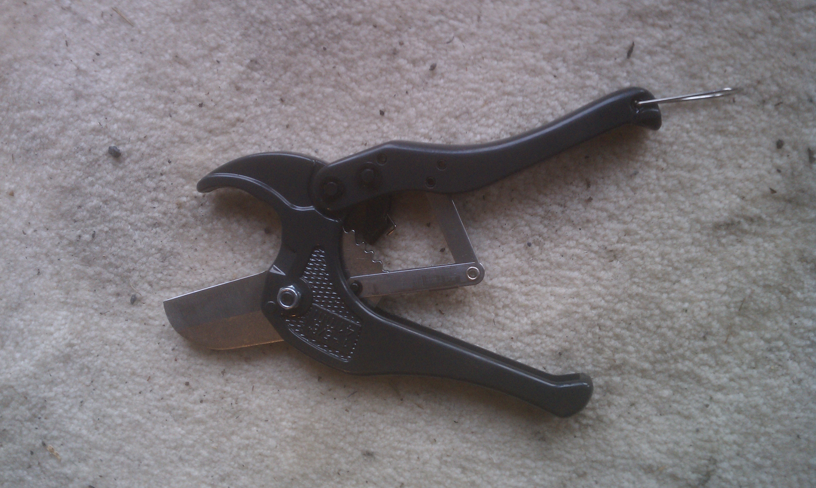

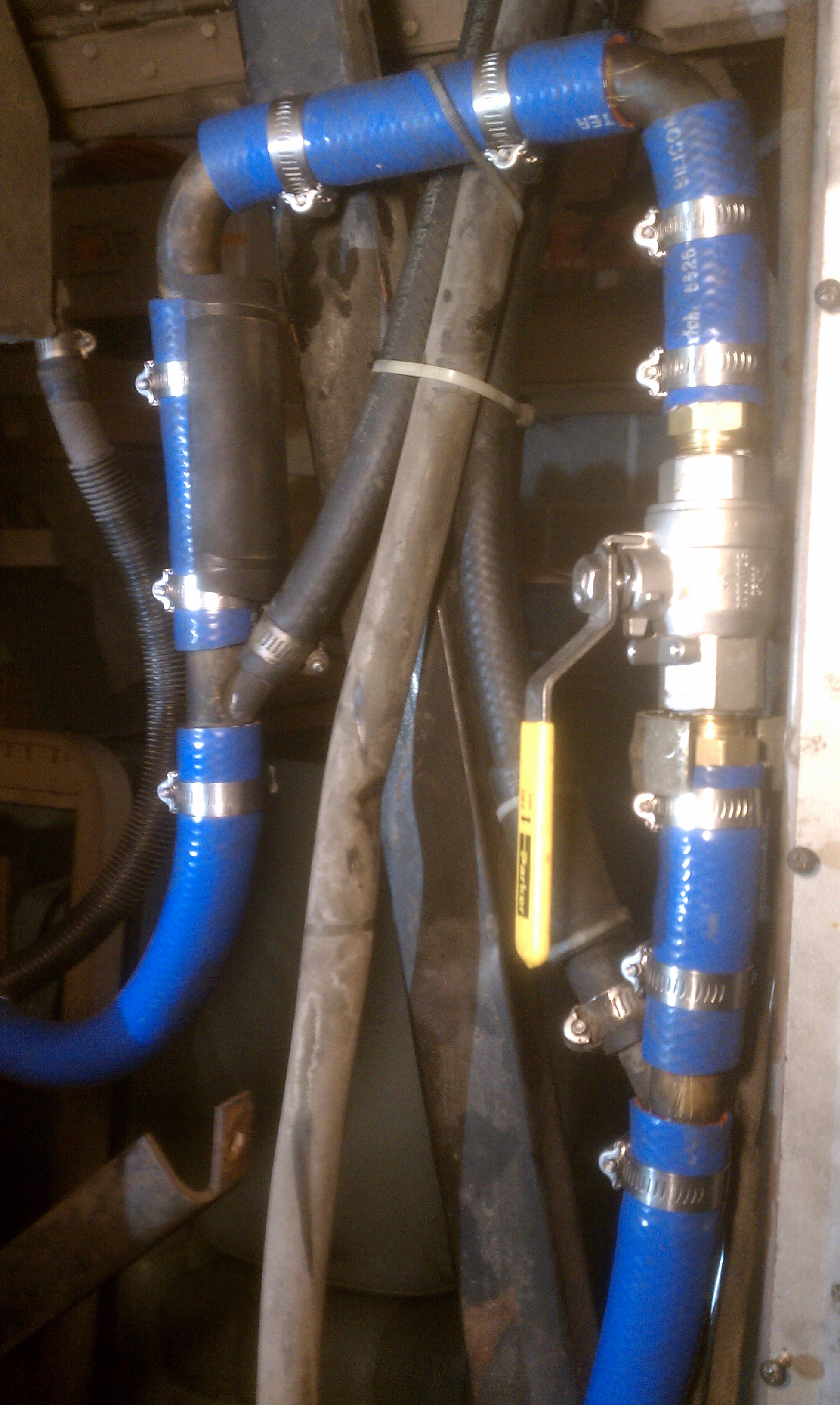

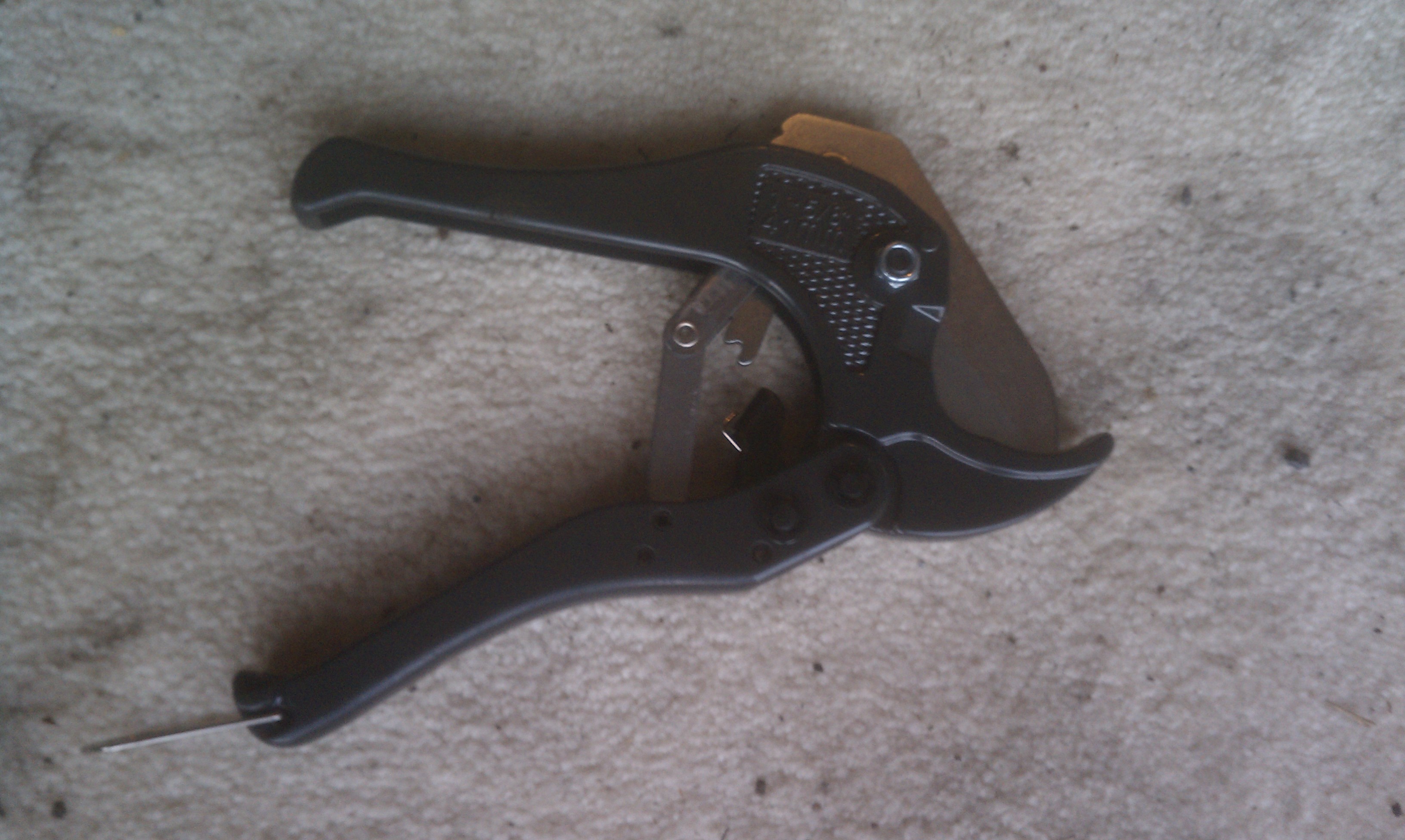

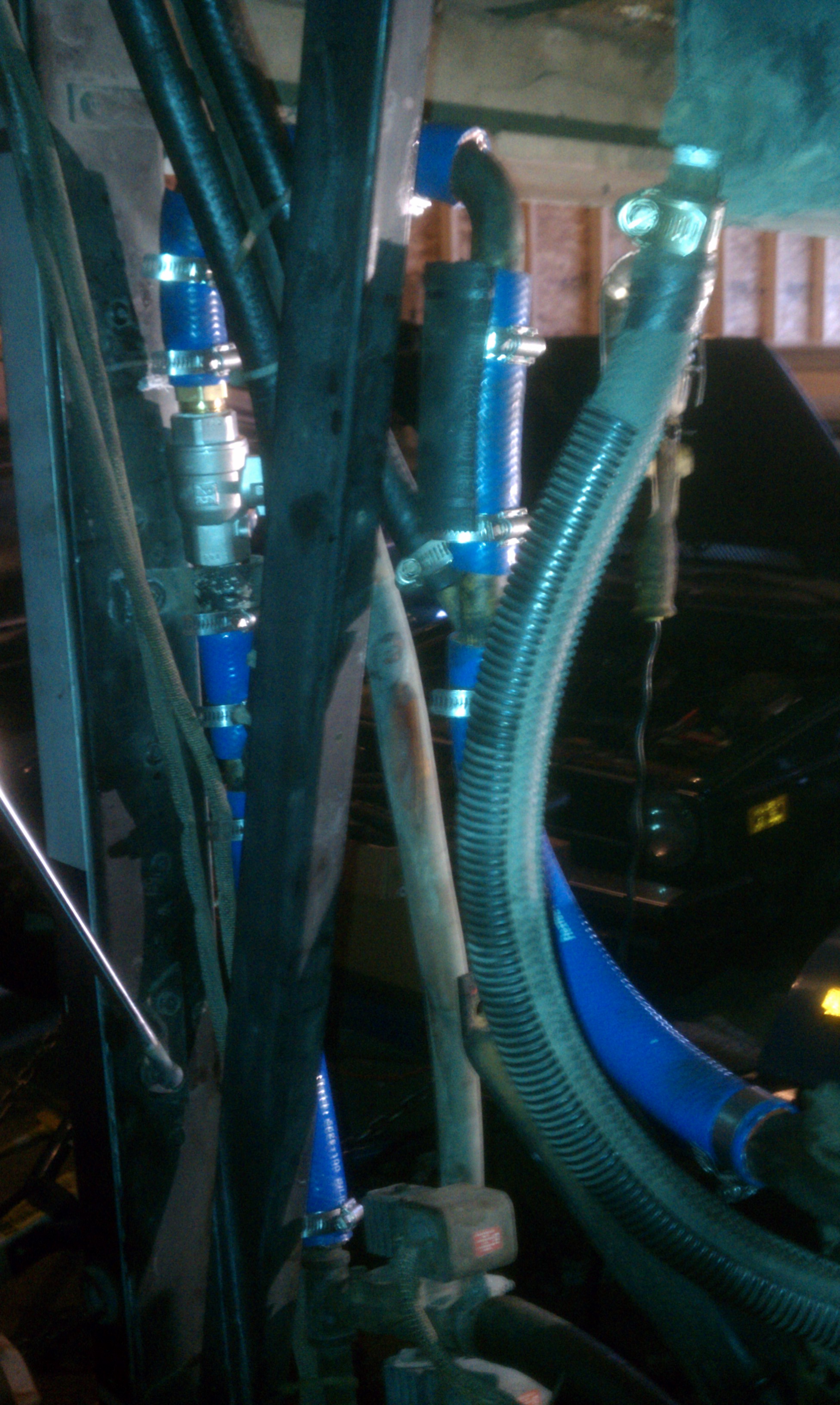

Started replacing some chassis heater hose and one of the associated valves today. Bought a tool to make cutting the hose easier than slicing with a razor knife.
İmage İmage İmage İmage İmage
