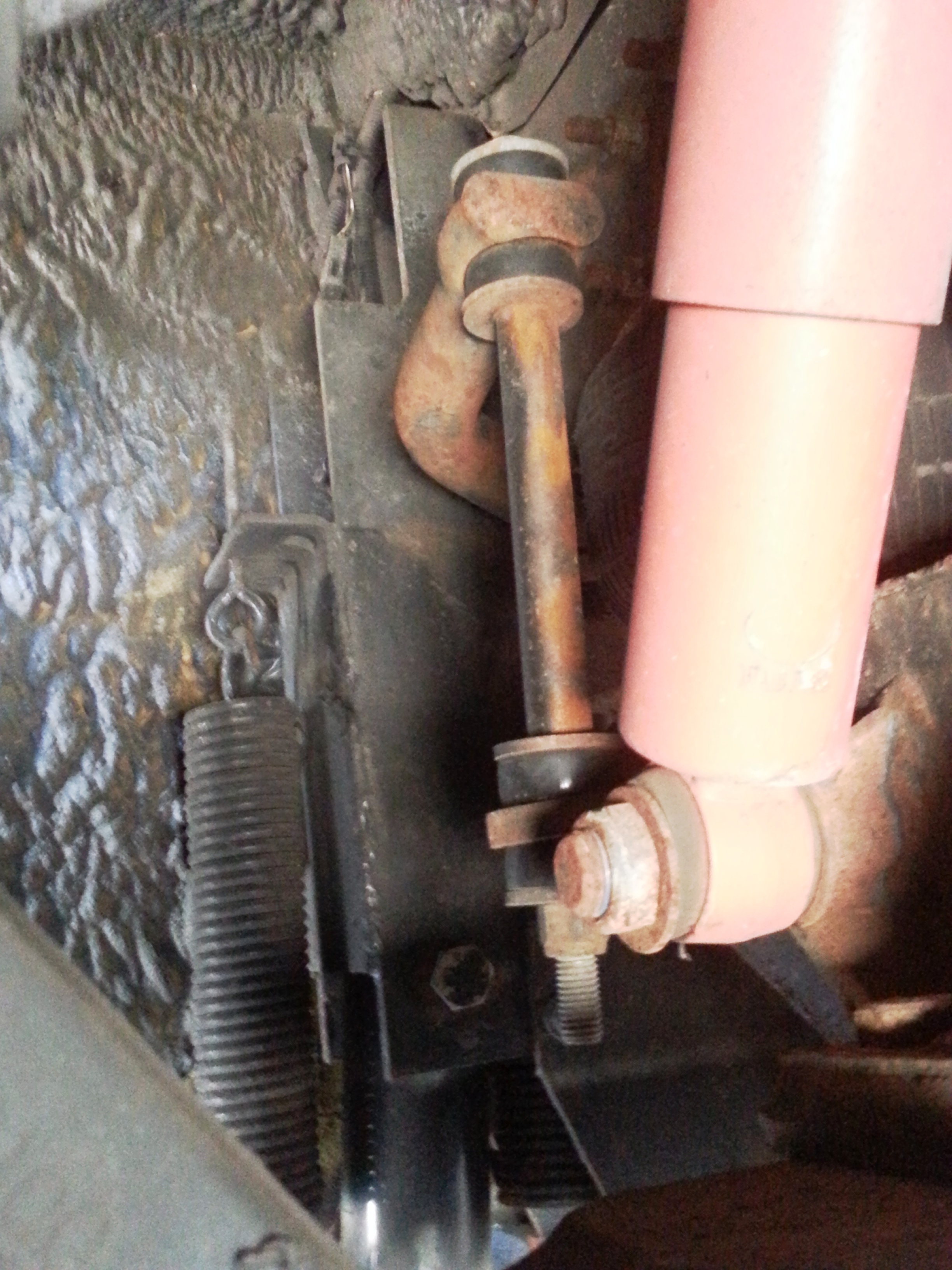

Oh Hell, David, we bounced all the way across the country. It about wore us both out. I believe the big anti-sway bar is still on the coach. See the pic below and tell me that is the rascal. The coach probably needs new shocks too.

Yup, that's the one Chuck. It's gotta go. After it's gone the handling is a slightly looser though no different from any other Wanderlodge Wide Body, but the ride improvement is dramatic.
Right off the bat I can see that your shock bushings are sacked.
We're going to have to dial it in for you Chuck. Smile The shock adjustment and bushings, tire pressure settings, the ride height needs to be tweaked, and the tag axle air pressure needs just the right touch for the icing on the cake. Been there done that! Finally, when I free up some time a set-up of auxiliary air tank reservoirs for the steer axle air springs is in the works, prevost and newell style.
