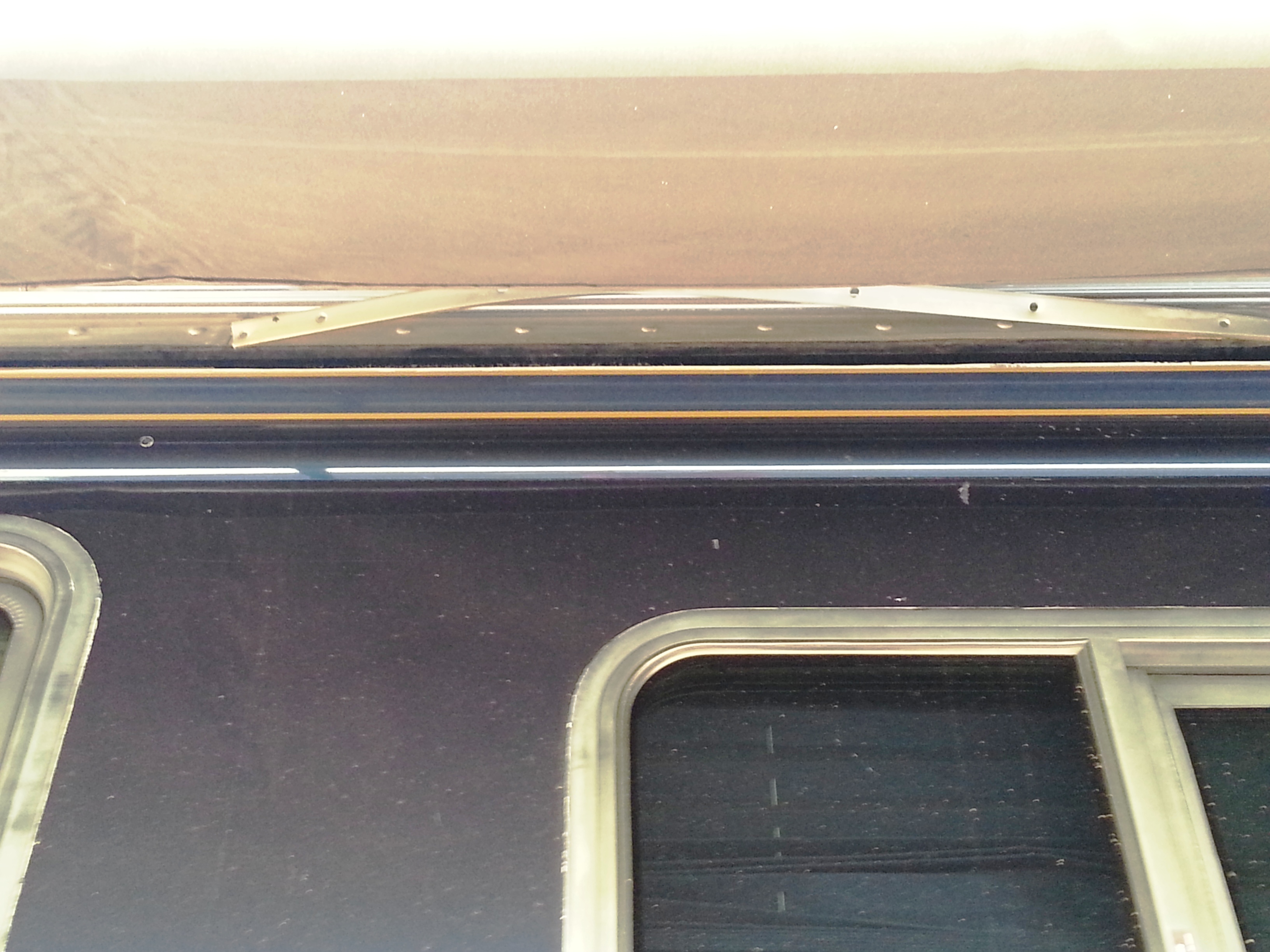

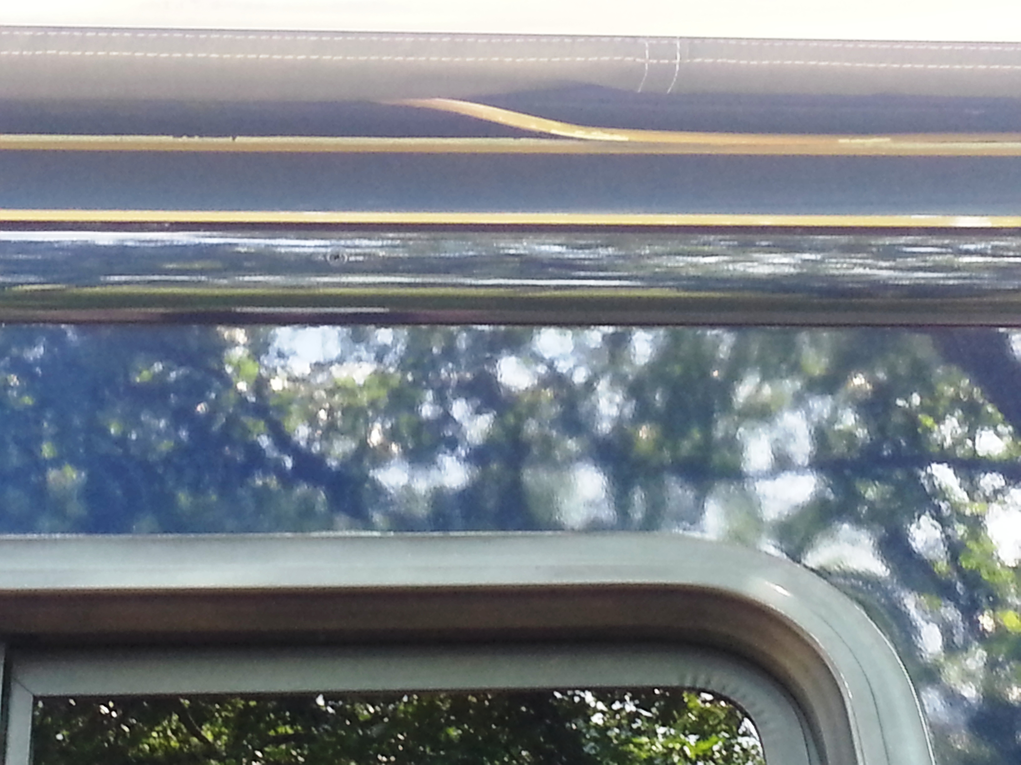

Well, on our way home from picking up the coach, we noticed the problems shown in the pics below after retracting the slide this morning. Anyone have any insight as to what has happened here? I went on top and pushed the aluminum strip back flush. I didn't mess with the other problem shown in pic 2.
BTW, the slide seal is ok and inflated.
The slide was worked on at Parliament just before we picked it up. They replaced the two hydraulic slide cylinders with new ones from HWH.
İmage İmage

I don't know what that aluminum piece is. There are three aluminum sections that bolt to the top of the interior of the slide that act as a stop when the slide is extended, but the cross-section is different from what I'm seeing on your photos. Each of the three pieces is about 3' long but they don't have the 90 deg bend that I'm seeing in your pic (or that I think I'm seeing). Is the aluminum piece in your picture painted?
On the second photo it looks like there's a piece that's bent upward and painted gold. Is that piece aluminum or plastic? It almost looks like someone added an additional layer of trim to the top edge of the slide. I need more info.

The aluminum piece is very thin and has a radius. I was on top again this morning trying to get a better look. It appears the slide's corner trim piece is broken at about the awning pull down strap and has been bent backward under the rolled up awning? I think it is about an inch wide.

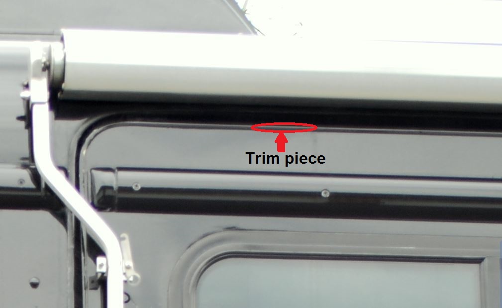

Is it the trim piece that's circled in my attachment below that pulled off? It'd be pretty tough to pull that piece off, but I suppose if the awning caught an edge it might be possible. How did the dislodged aluminum strip occur?
Thanks Chuck,
I see. It looks like the awning caught the trim piece and pulled it away from the slide body. It may have occurred during a slide retraction with a fully extended awning. The awning caught the trim and dislodged it. For folks who don't know, the awning arms are attached to the outside face of the slide body, so the awning extends automatically with the slide. This forms an awning "topper" that protects the roof of the extended slideout body. From that position, a user can go outside to grab the awning loop to further extend the awning into it's fully deployed position.
Chuck,
I would probably get on the phone with Zip Dee to see if they have a service location near where you are. Maybe they can unroll the awning to dislodge the aluminum strip. Then you can unscrew the aluminum trim strip and remove it.

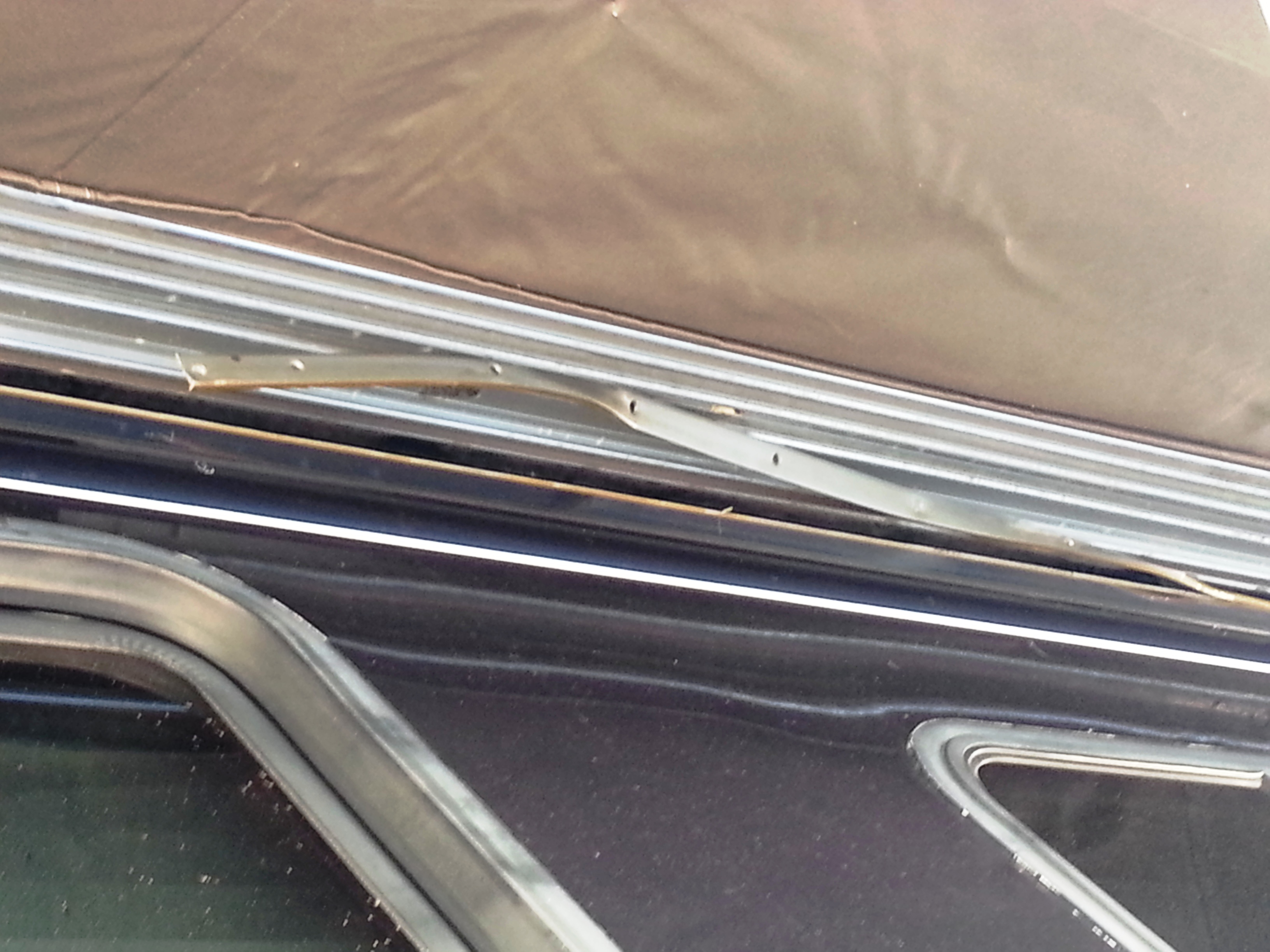

Chuck . I have started the repair on my LXI with the same issue . The first part involves removing the arms that support the awning . I removed one at a time . when removing the screws, Start in the middle where the 2 pieces join together . you need to start on the end so you can move the trim away from the screws which are still in place .
this is as far as I have made it , there seems to be some sort of epoxy under the trim. it looks like the end wall is joined together creating a seem .
so I plan to flatten out where the trim tore thru the screws , so the screw will hold it down firmly along with the epoxy.
any ideas on what adhesive should be used ?

Definitely a humidity curing urethane based product like Sikaflex 221. Have you checked your awning for excessive sag in the center? I can't quite grasp how the awning latches onto the slide body corner trim. I imagine new corner trim is available from HWH. Maybe you can get it w/o holes drilled so that you can place your own.

(05-09-2013 20:35)al perna Wrote:  Chuck . I have started the repair on my LXI with the same issue . The first part involves removing the arms that support the awning . I removed one at a time . when removing the screws, Start in the middle where the 2 pieces join together . you need to start on the end so you can move the trim away from the screws which are still in place .
Al,
Thanks for the information. Once the arms are detached from the slide body; did you completely remove the arms from the roller or were you able to swing them up and away from the slide to allow the slide to be extended without the awning extending also? I was concerned about detaching the arms due to the spring tension on the roller.
It sure appears that if the slide is retracted with the awning fully extended; the awning material applies pressure on the slide top corner trim piece. It's obviously enough pressure to tear that trim piece from the slide. I extended the awning with the slide retracted this morning and watched as the trim piece unrolled from between the rolls of the awning material.

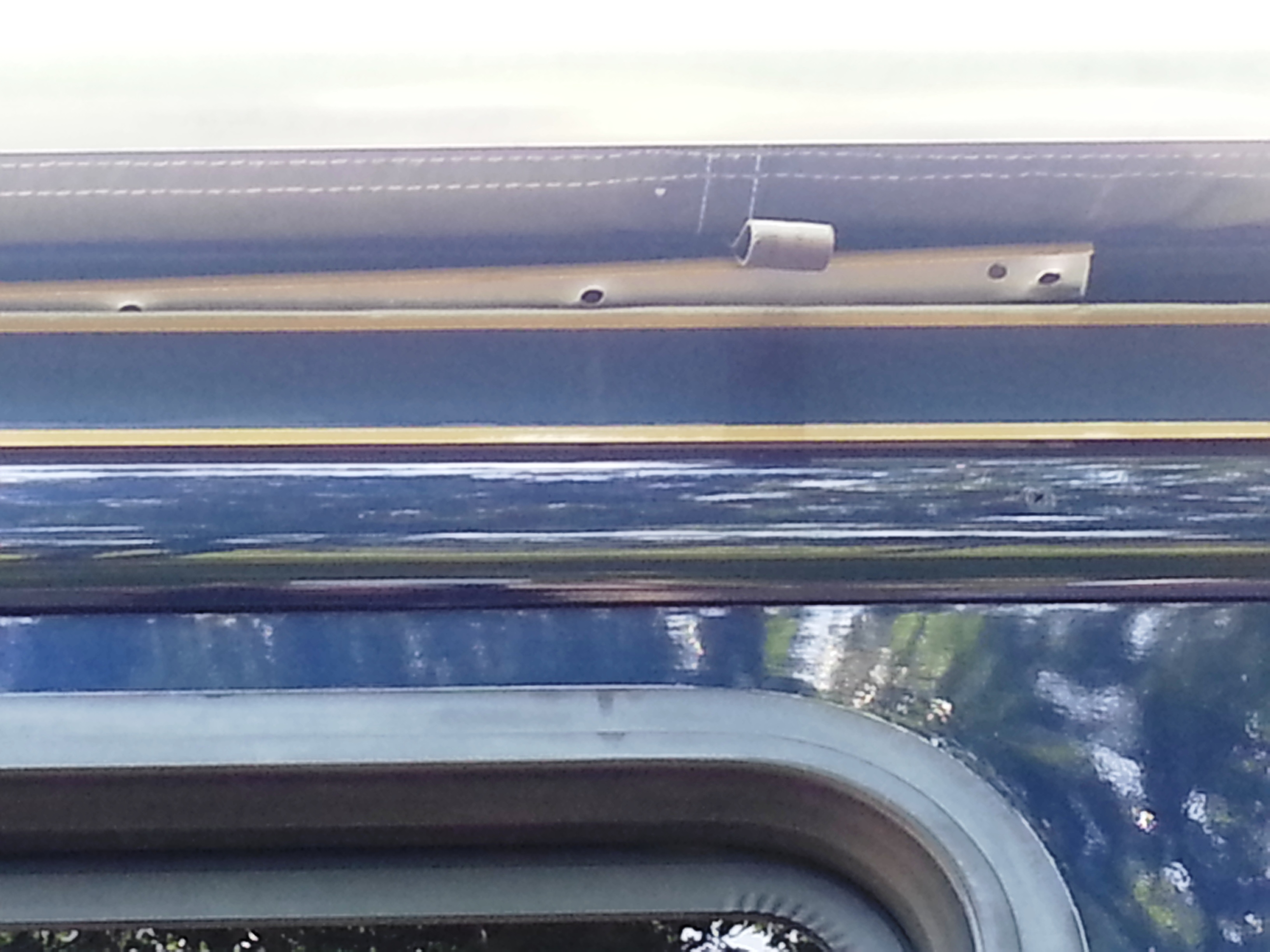

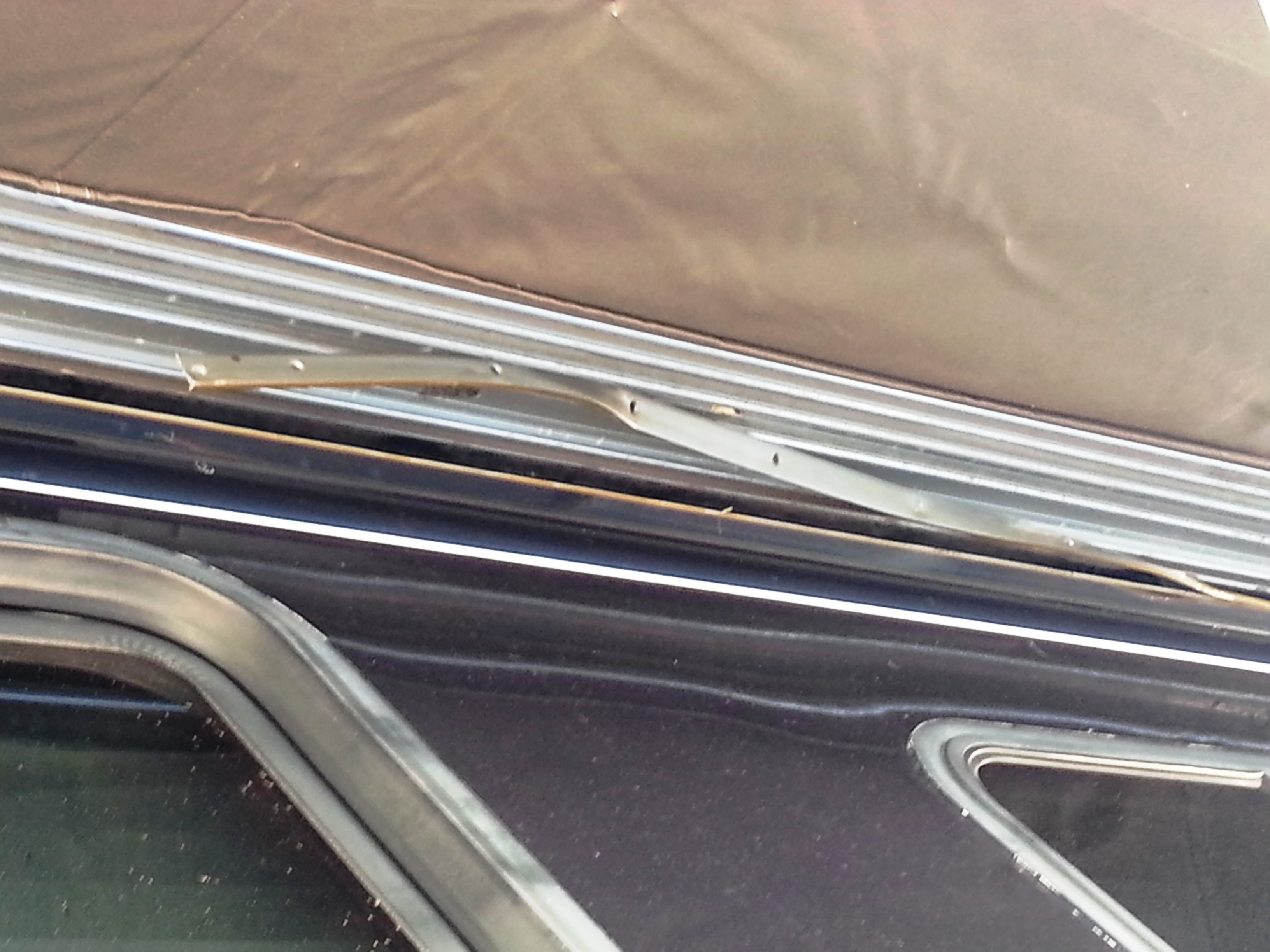

Below are better pics of my slide trim damage after I unrolled it this morning
Funny thing tho, I didn't notice it when I inspected the coach before I bought it and I had never extended the awning; just the slide only. It was probably done some time in the past and the PO didn't even realize it.
As regards the proper adhesive, David says to use Sikaflex221 in a previous post.
Al, I suspect if you are able to straighten the original trim piece; it probaply will require new screws in new screw locations?

See the more recent photos of the trim damage which I posted below.
You know, I don't think I ever read a post describing this issue as a way to potentialy damage your slide.
I am surprised that this issue is not a common occurance as many owners may not be aware that they must first retract the awning extension before retracting the slide.
İmage İmage
