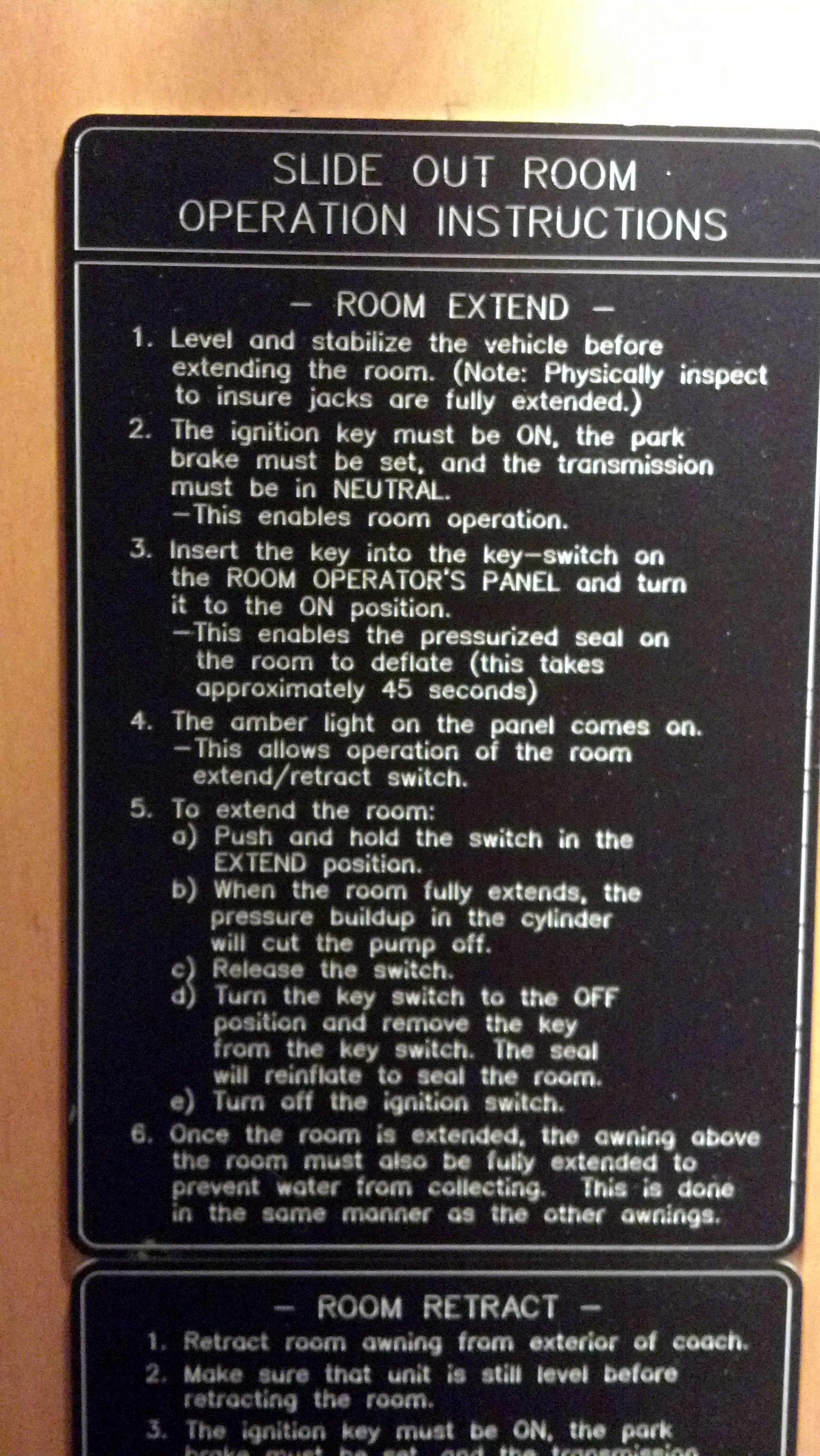

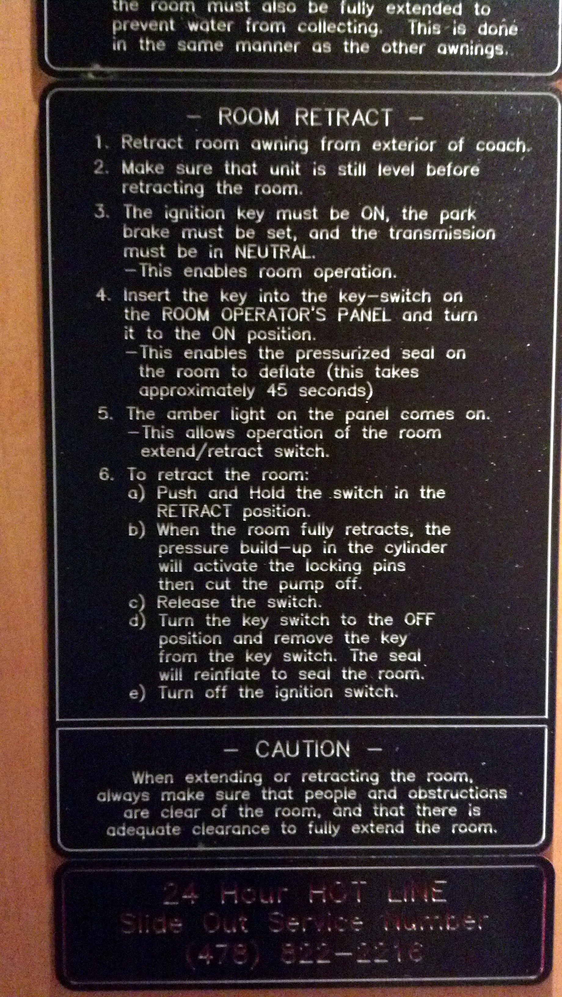

05-31-2013, 13:44
Post: #30
RE: Slideout Issue
Here's the HWH slide operation instructions that are posted on my pantry door, behind which are the HWH controls. Note instruction (1) when retracting the slide:
