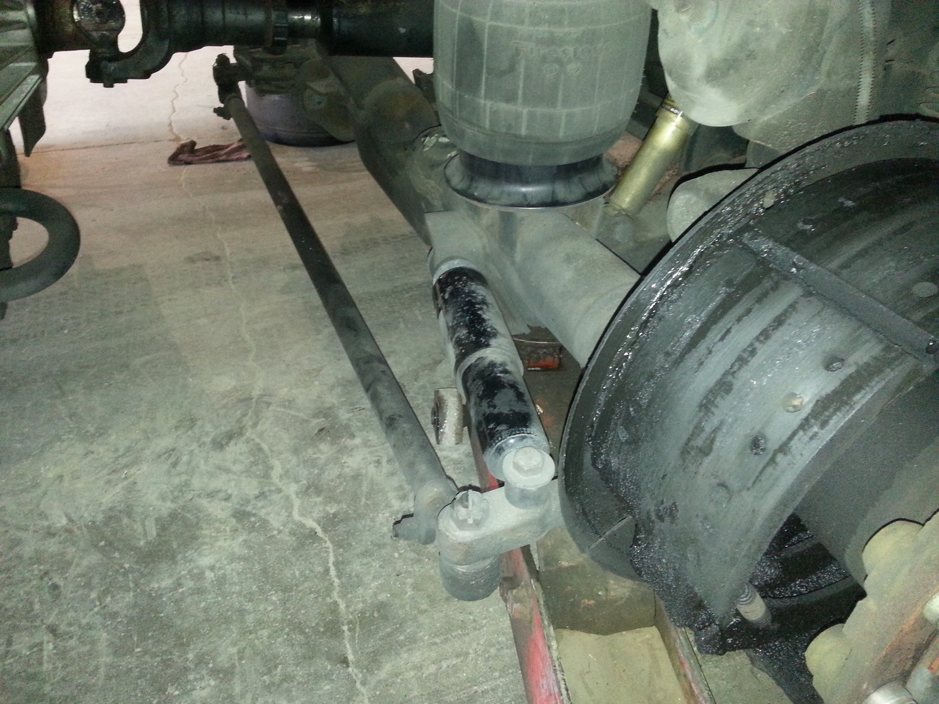

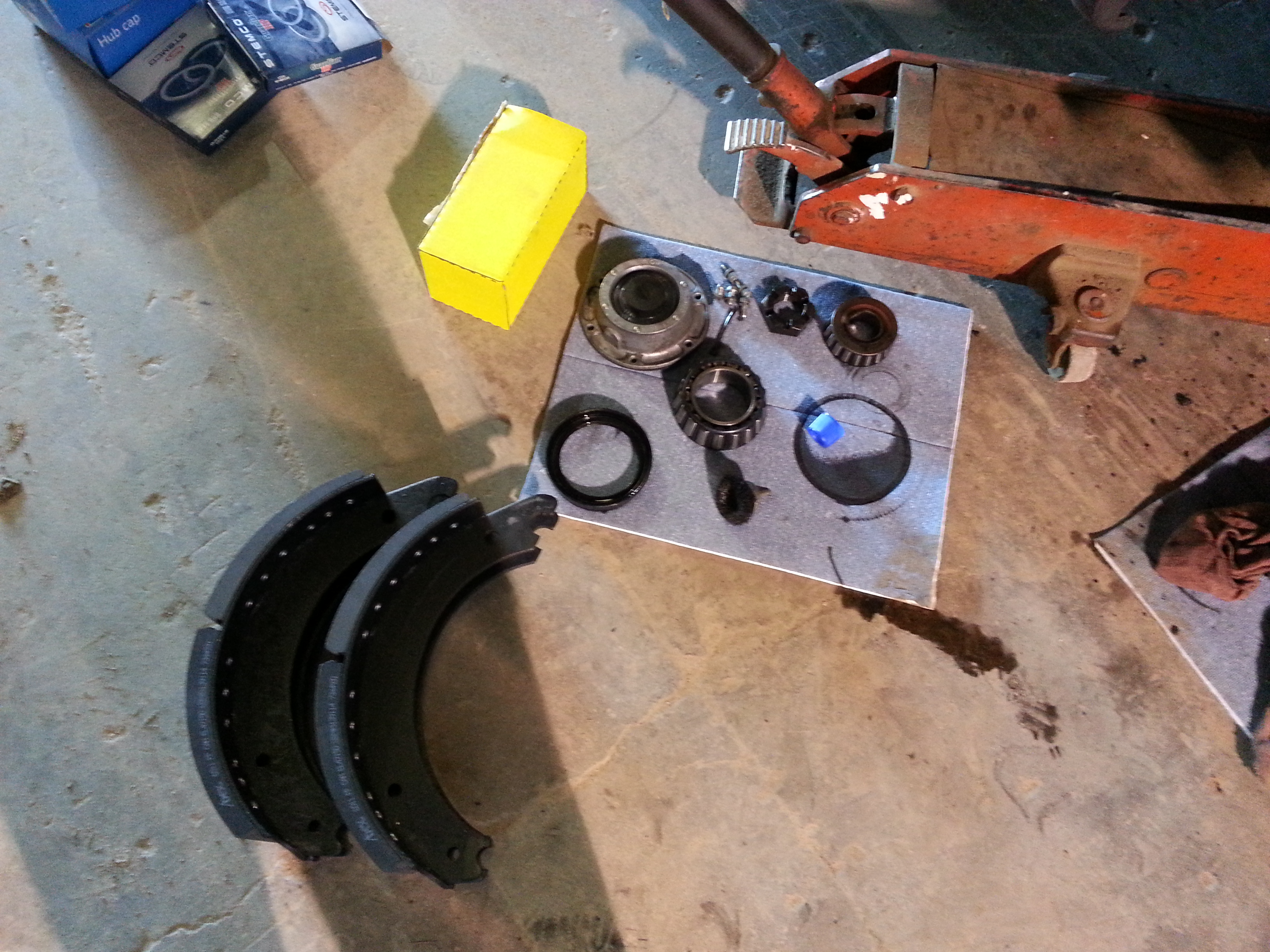

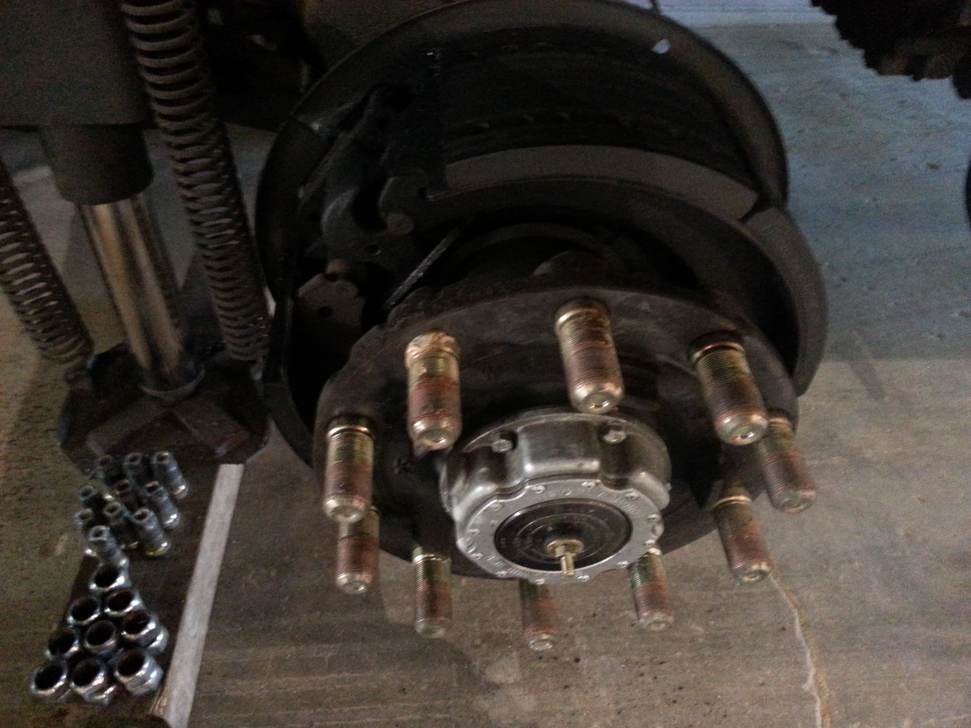

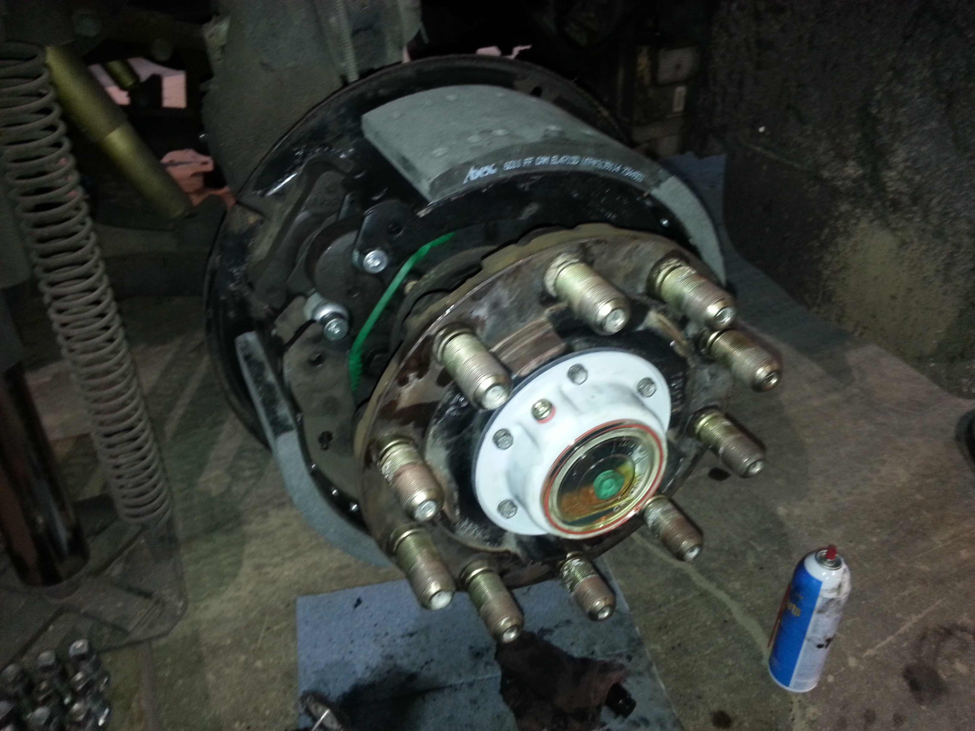

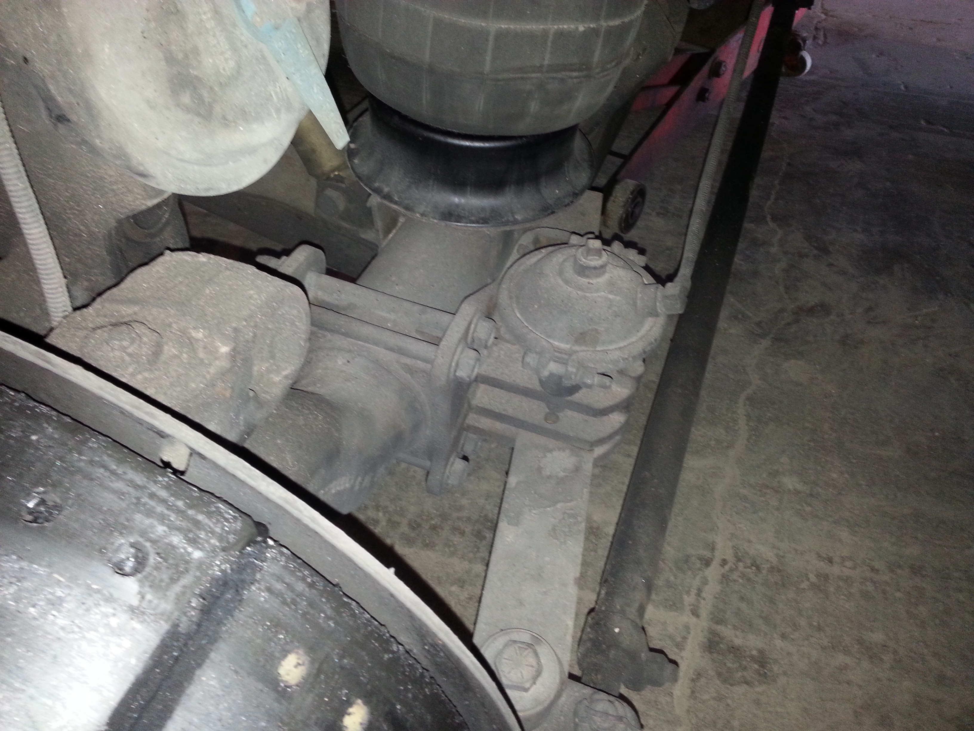

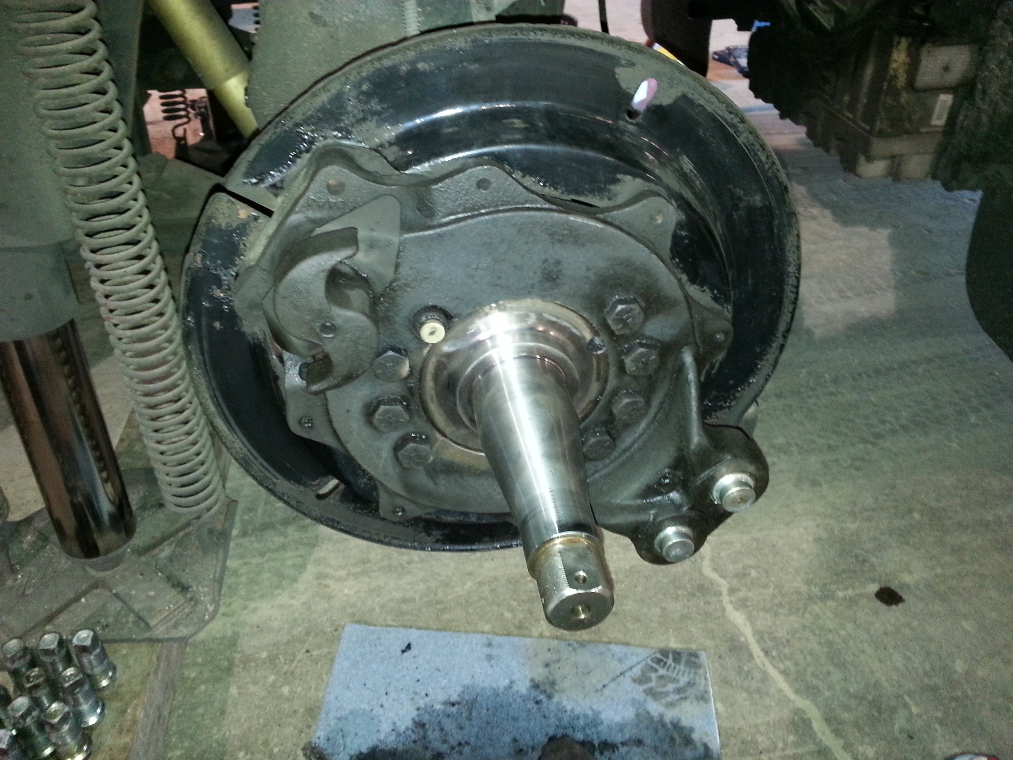

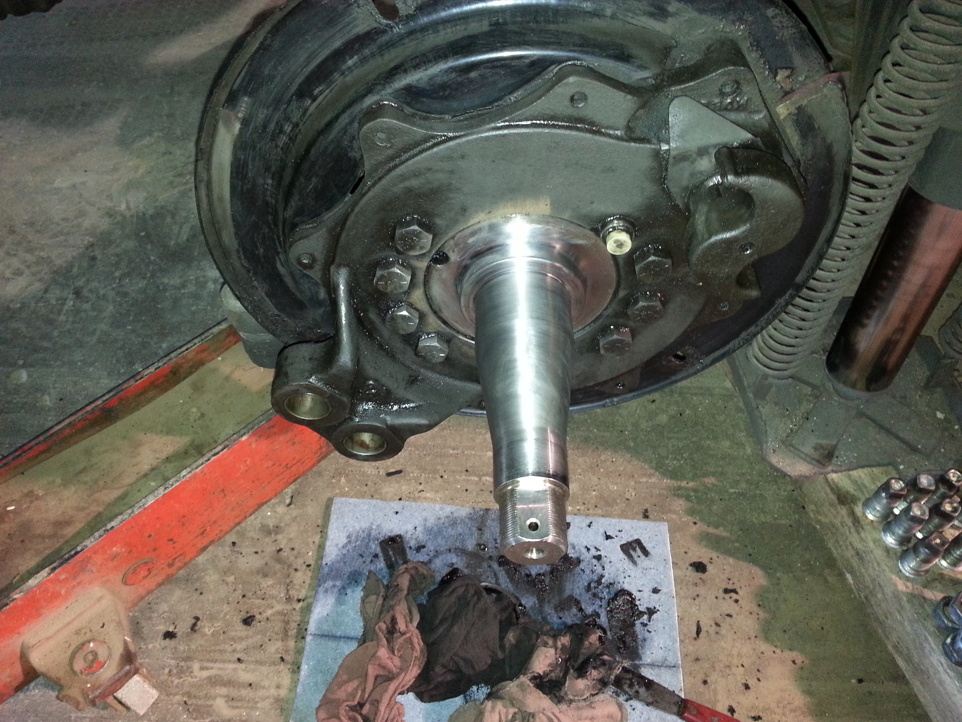

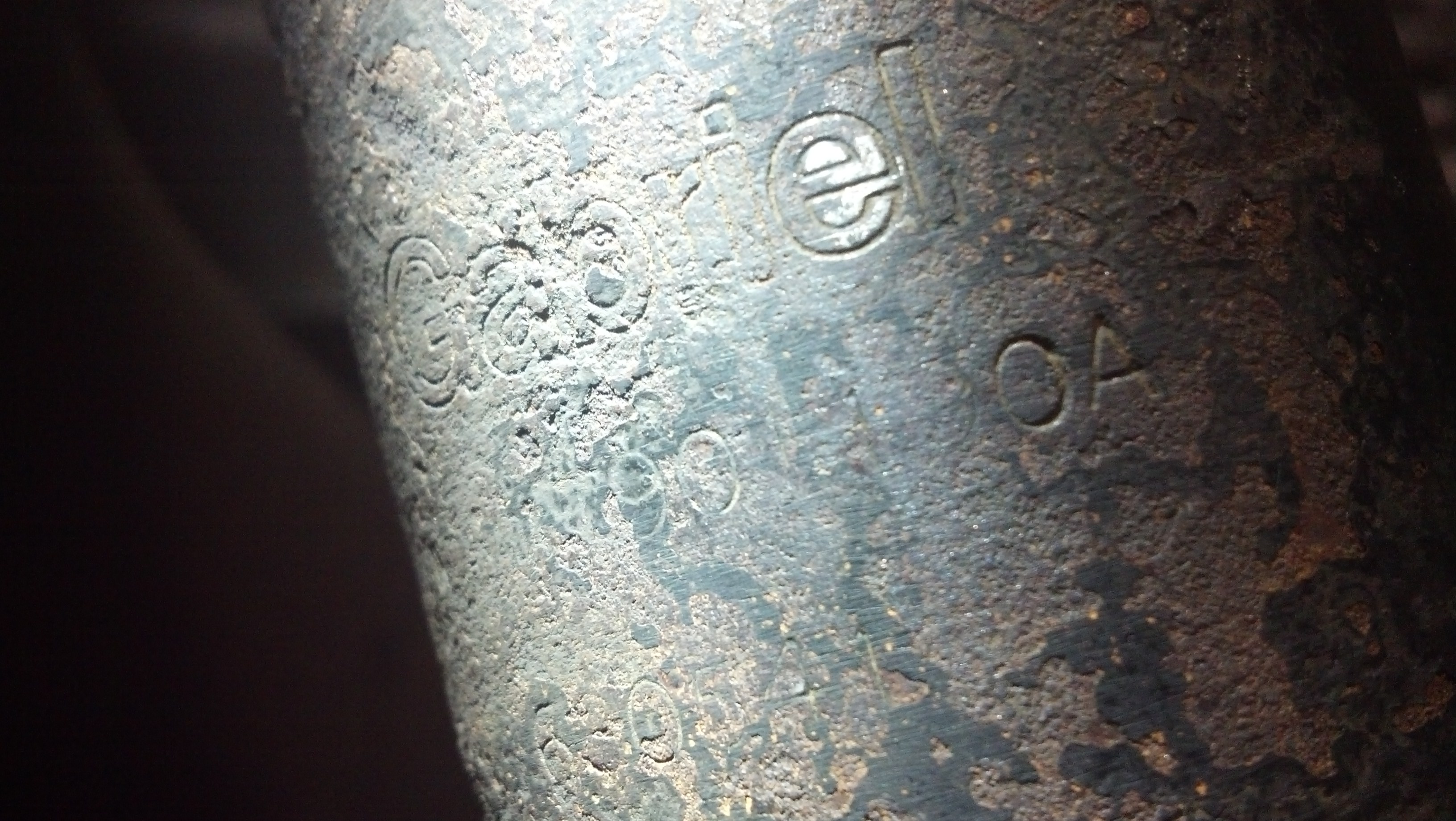

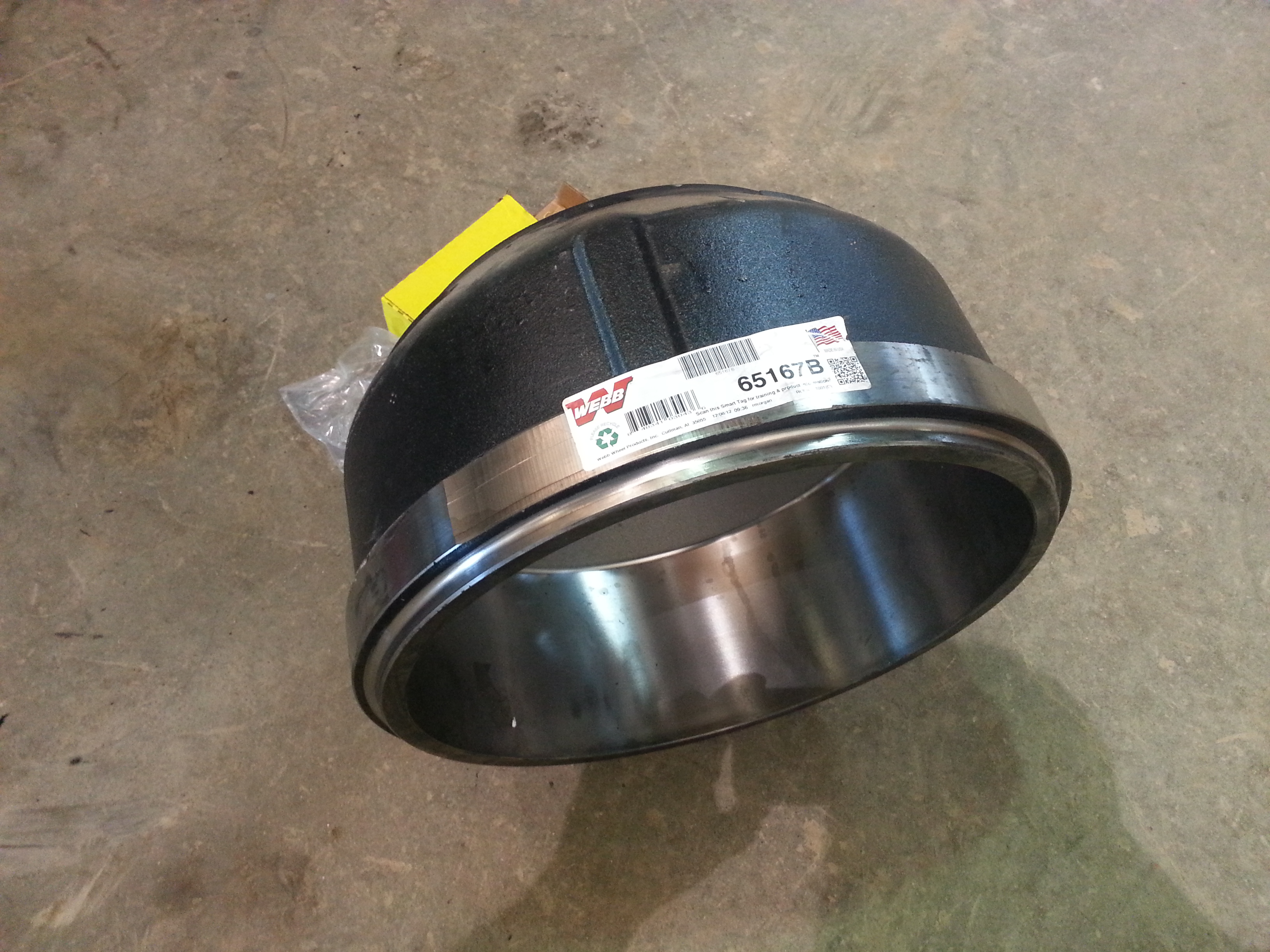

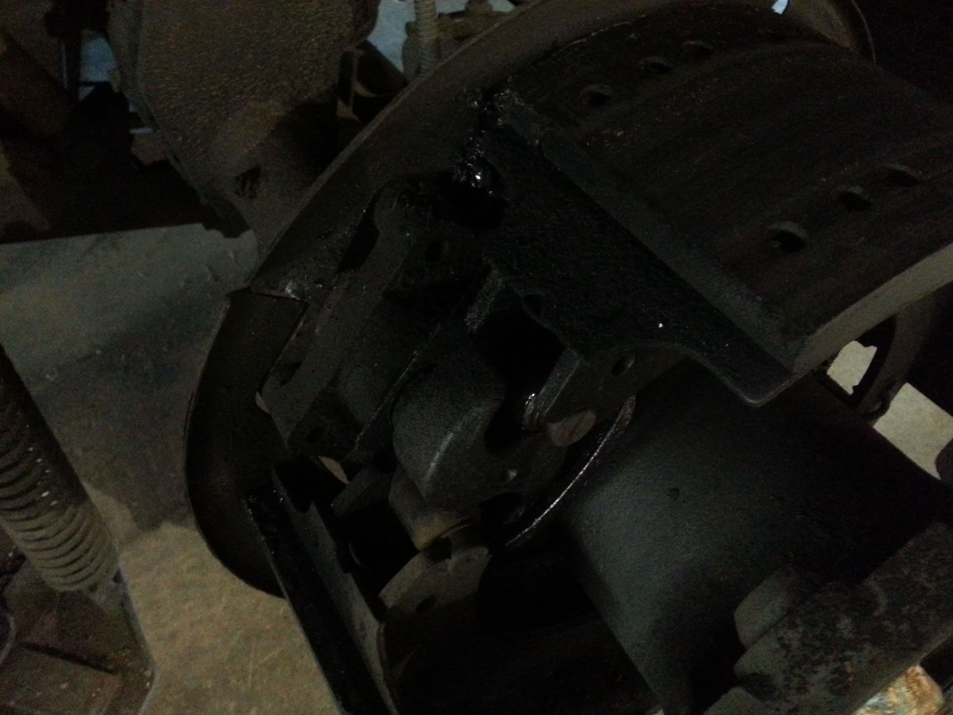

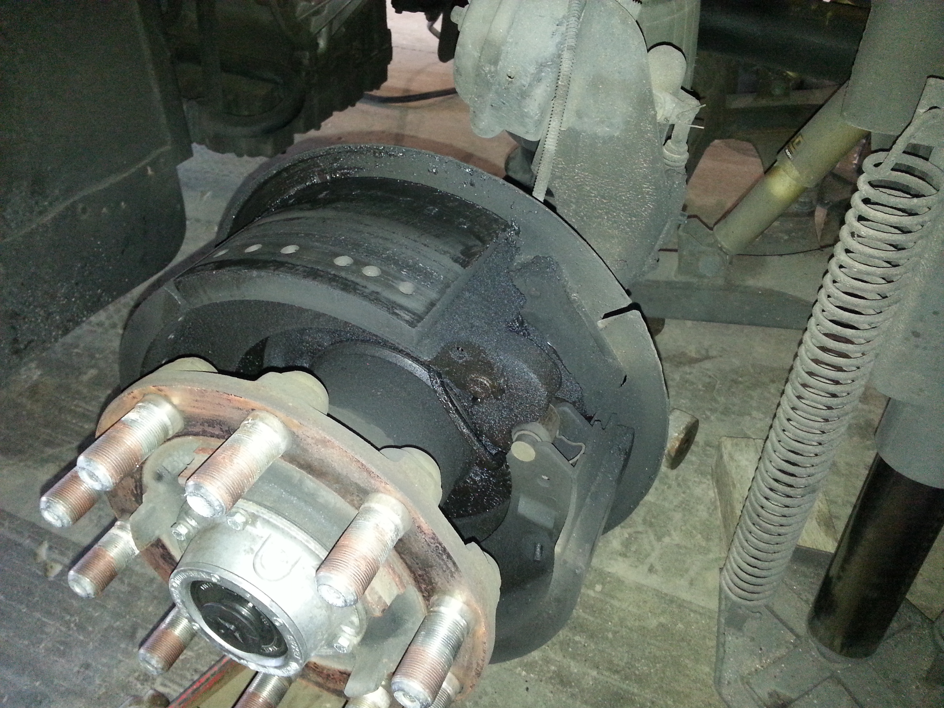

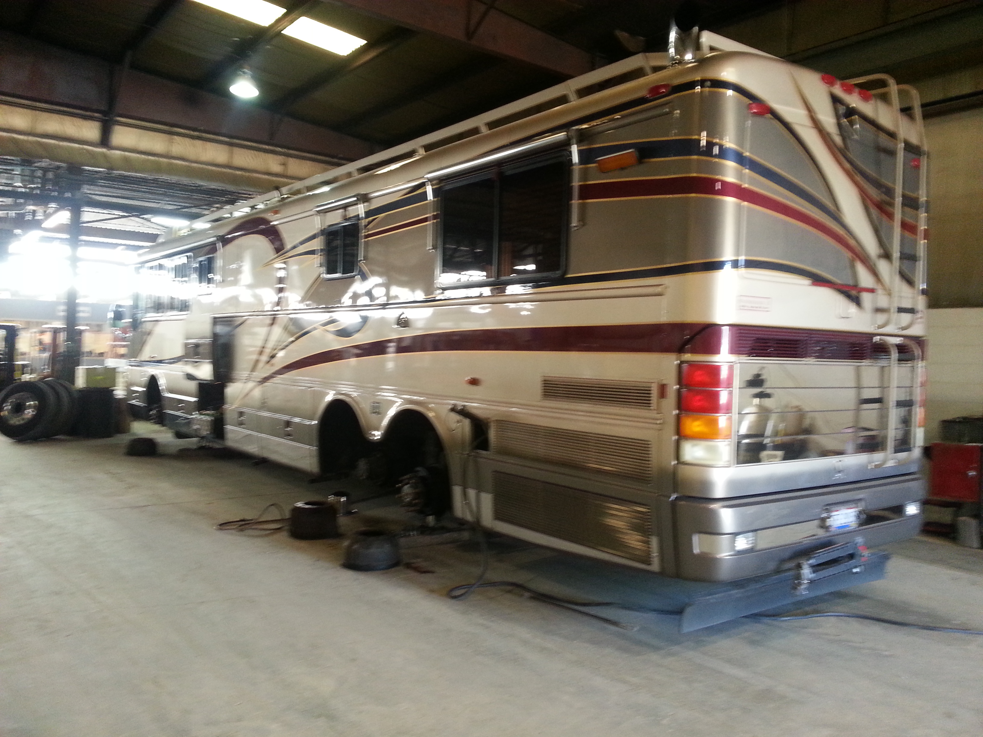

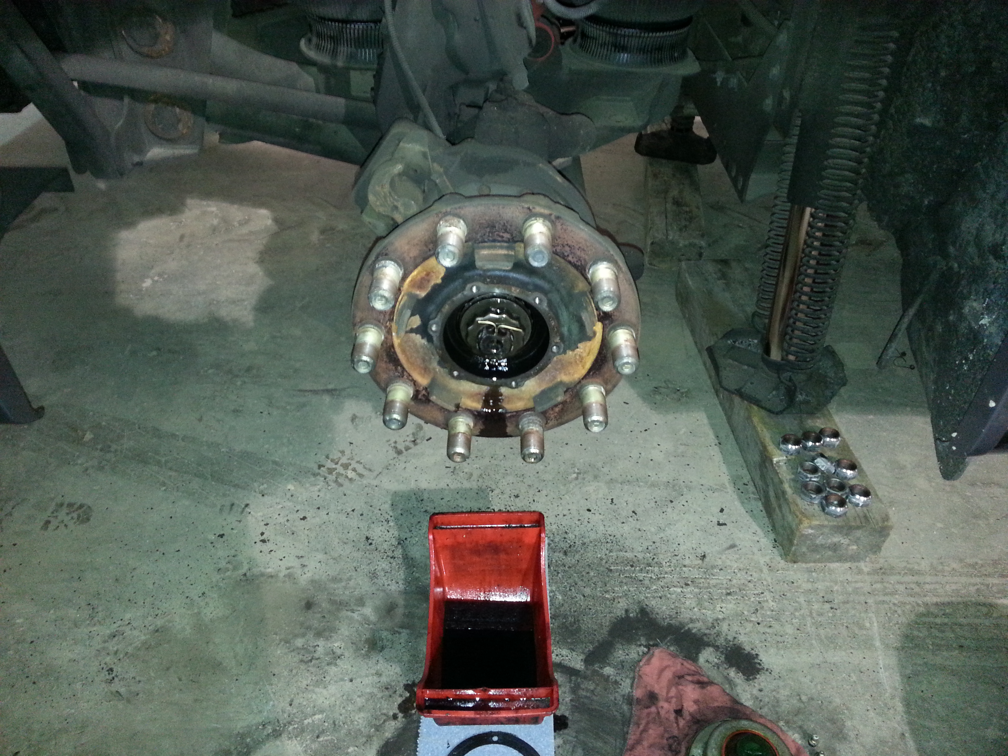

started working on the bus today going to replace the tag seals they were leaking tag shocks a stabilizer new steer tires brakes and new drums on the steer and tag
İmage İmage İmage İmage İmage
Here are some more pics
İmage İmage İmage İmage İmage İmage
İmage İmage

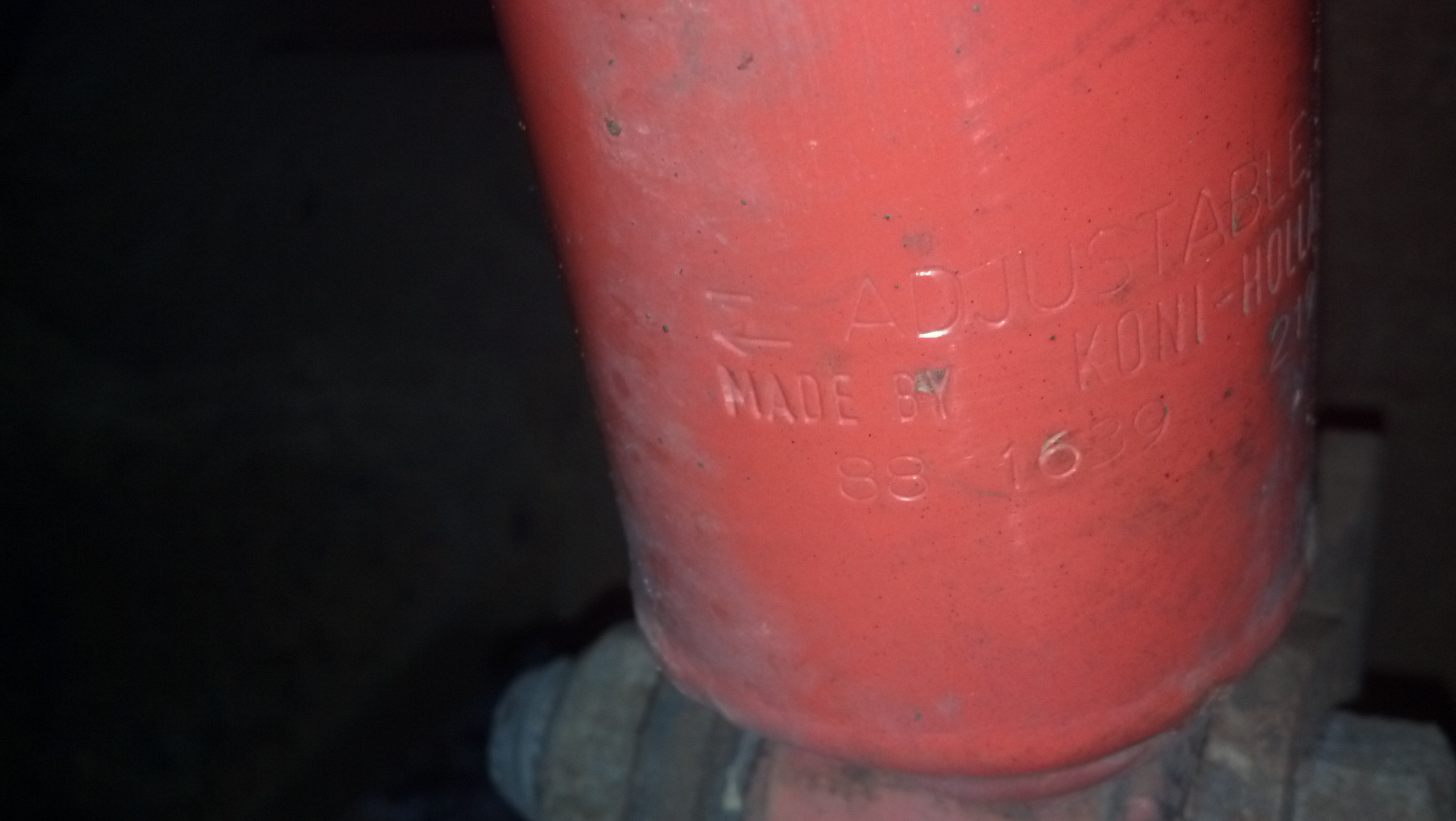

Just got off the phone with koni they said the steerable tag shock number is koni 8805-1015 drive shocks 9005-1025 and steer 90-2497 sp1 not sure if these are right but that's what they are telling me the stabilizer shock number and make is arvin meritor /gabriel fleet line 85316 shock absorber

Hey Rick,
That's great progress - thanks for sharing it with us.
During the WaGu Asheville rally we crawled all over Al Perna's coach searching for steer axle part numbers.
For the steer tag axle shock we have Koni pNo: 88-1639,
For the steering stabilizer we have Gabriel pNo: 630541
For Hub piloted steer axle:
Hub and Cup assy: Webb 25231-3T
Brake Drum 16.5 x 6, Webb 65179B
Oil Slinger Webb 73615
90-2497SP1 is definitely correct for the steer axle. I find mine ride and handle best when set on full soft.
pNo on the Gabriel Steering Stabilizer
pNo on Koni Shocks
Thanks to Arcticdude, Al, Gregg, Corey, and Chuck for pulling these pNo's together. :-)

In looking at the tag shock picture, I see it's an adjustable shock. Has anybody played with the settings there?
