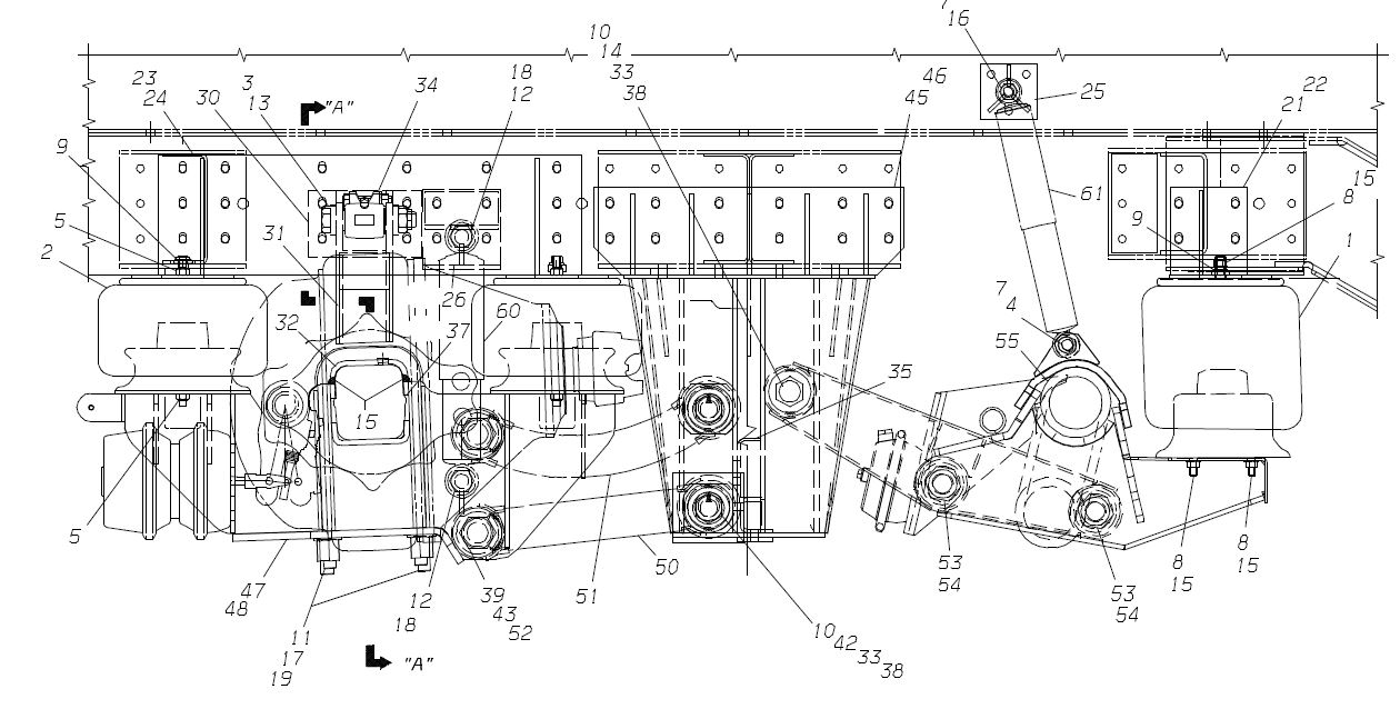

For my LXi:
It's a little difficult making out the drive axle shock; it's item number 60. The drive axle shock is on the inside of the frame rails. The steer and tag axle shocks are on the outside of the frame rails. david brady, '02 Wanderlodge LXi 'Smokey' (Sold), '04 Prevost H3 Vantare 'SpongeBob' "I don't like being wrong, but I really hate being right" |

09-26-2013, 21:53
(This post was last modified: 09-26-2013 21:54 by hagcam.)
RE: Why cheap shocks might be better
David
I just changed the tag and drive shocks on Rob's 99 LXI, and they were both mounted inboard of the frame rails. The steers are outboard. I don't know if yours are the same. I also changed the shocks on my 96 and they are all mounted outboard of the frame rails. Peter Haggins Courtenay BC Canada 96 42'WB mid-door "R"B&B |
09-26-2013, 23:18
Hey Pete,
Hmmm, I wonder what tag axle Rob is running. Is it a steerable tag? Is his bus a 41' or a 43'? It's sketchy but my records show: 41' ending with CSN 10000201, two suspension hangers, shocks mounted outboard on both the drive and the tag, 43' ending with CSN 10001469, two suspension hangers, shocks mounted outboard on both axles, 41' starting with CSN 10000202 ending with 10052120, single combined drive/tag hanger, shocks inboard on the drive and outboard on the tag, 43' starting with CSN 10001470 ending with 10052809, single combined drive/tag hanger with steerable tag, shocks inboard on drive and tag, 43' starting with CSN 10062750, single combined drive/tag hanger with fixed tag, shocks mounted inboard on drive and outboard on tag It's very interesting. I haven't identified an LXi tag axle setup, other than the steerable tag, that has the shocks mounted inboard of the frame rails. david brady, '02 Wanderlodge LXi 'Smokey' (Sold), '04 Prevost H3 Vantare 'SpongeBob' "I don't like being wrong, but I really hate being right" |

(09-26-2013 15:37)Arcticdude Wrote: I hadn't paid much attention to the orientation differences from front to rear. Something ELSE to look at! John, I bet we could mount a drive or tag axle Koni FSD shock to our steer axle. We have doubled up (stacked) c-channel frame rails above our axles. I don't see why an additional shock mount couldn't be mounted in a vertical position on our steer axles similar to how it was done on our drives. Once I get under the bus to check things out the reason for why it wasn't done might become crystal clear, but on paper (see above drawings) it looks feasible. That'd be a pretty slick upgrade! You can see how my upper steer axle shock mount is simply bolted on: david brady, '02 Wanderlodge LXi 'Smokey' (Sold), '04 Prevost H3 Vantare 'SpongeBob' "I don't like being wrong, but I really hate being right" |

Rob's is a steer tag, shocks mounted inboard. Randy changed his as well, he has a steer tag and they were also mounted inboard. So based on a sample of two coaches, I assume that the steer tag axles have their shocks mounted inboard.
I had incorrectly assumed that all lxi s were that way. Learned something new. Thanks. Peter Haggins Courtenay BC Canada 96 42'WB mid-door "R"B&B |
