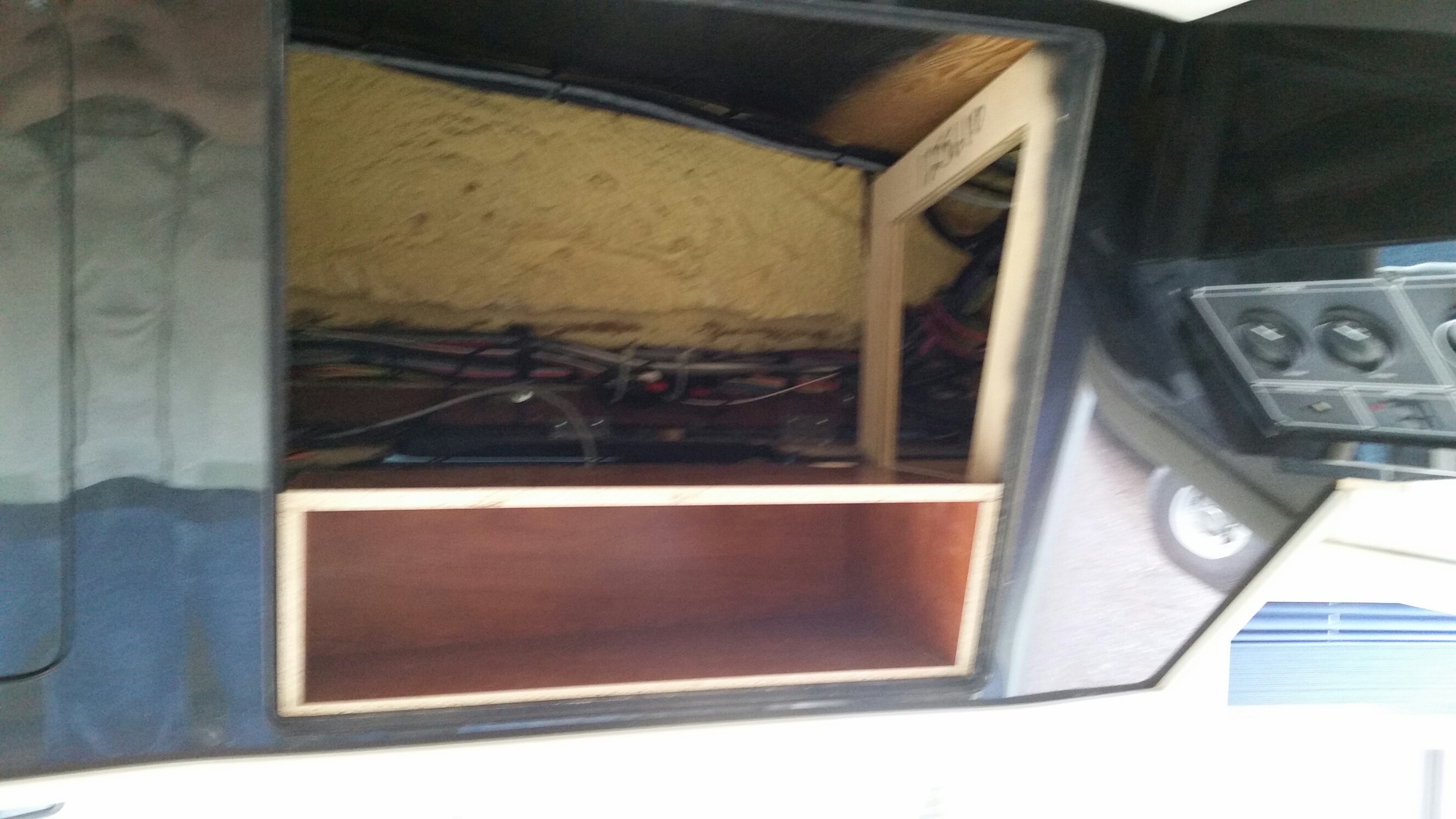

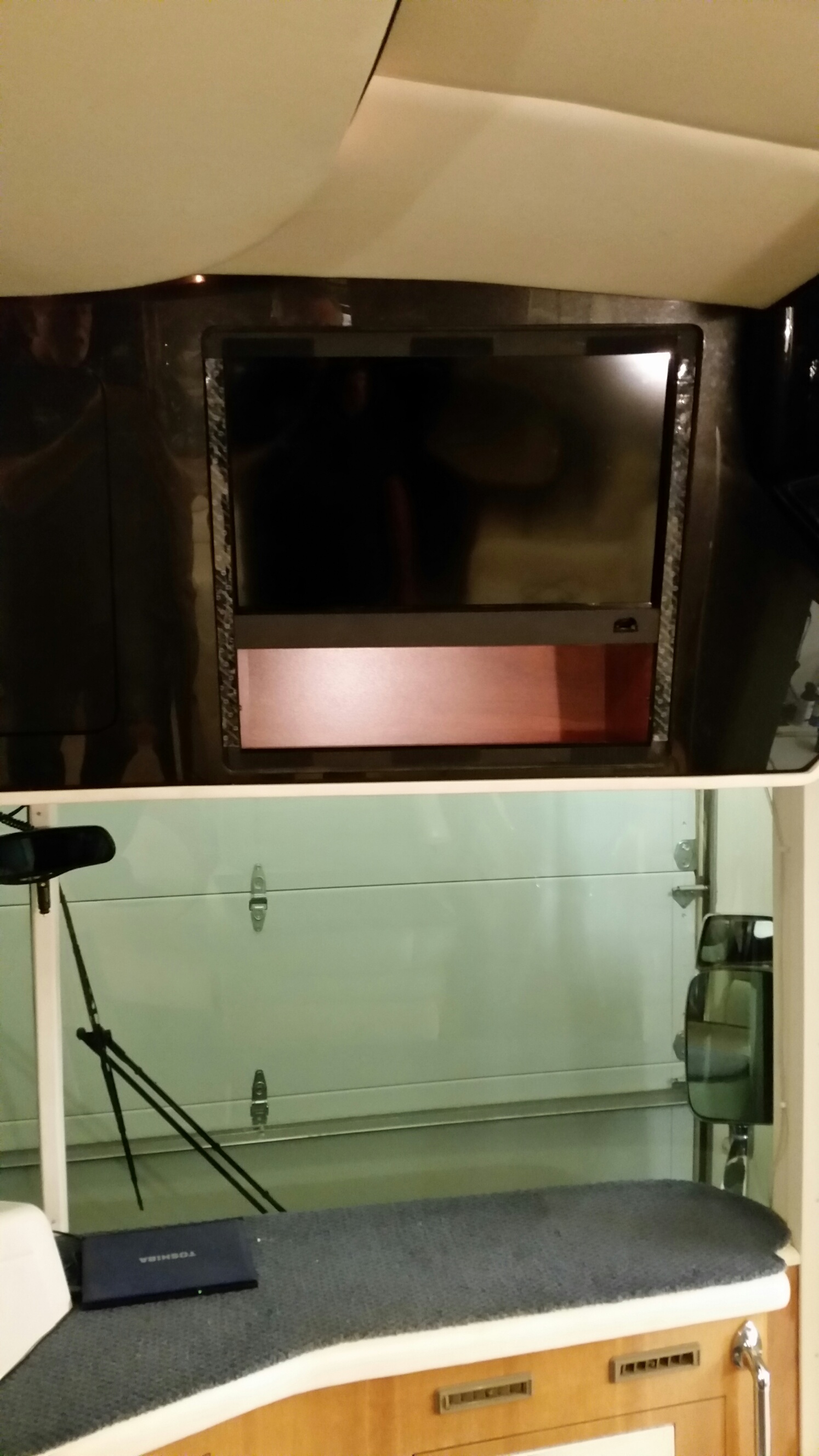

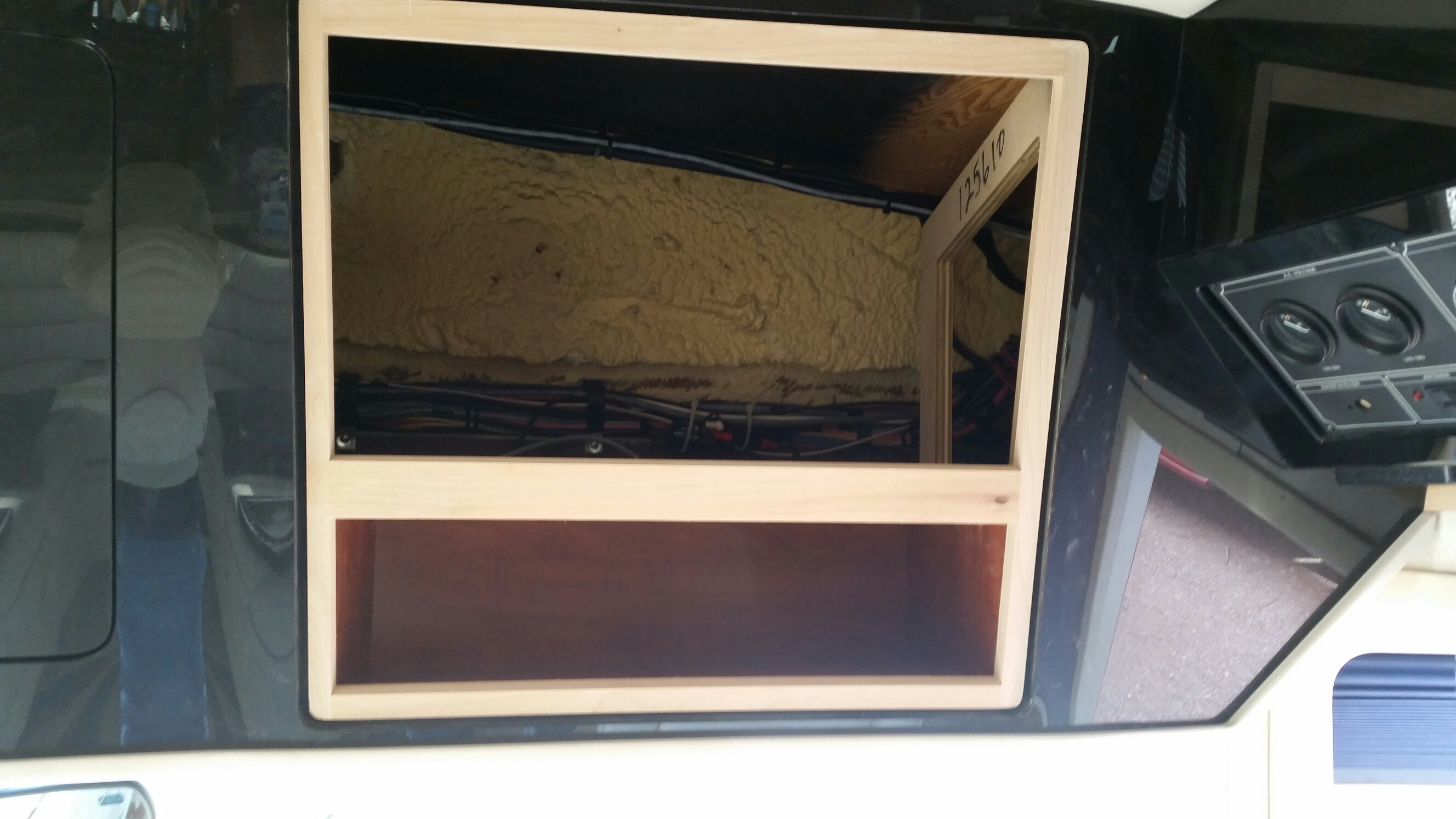

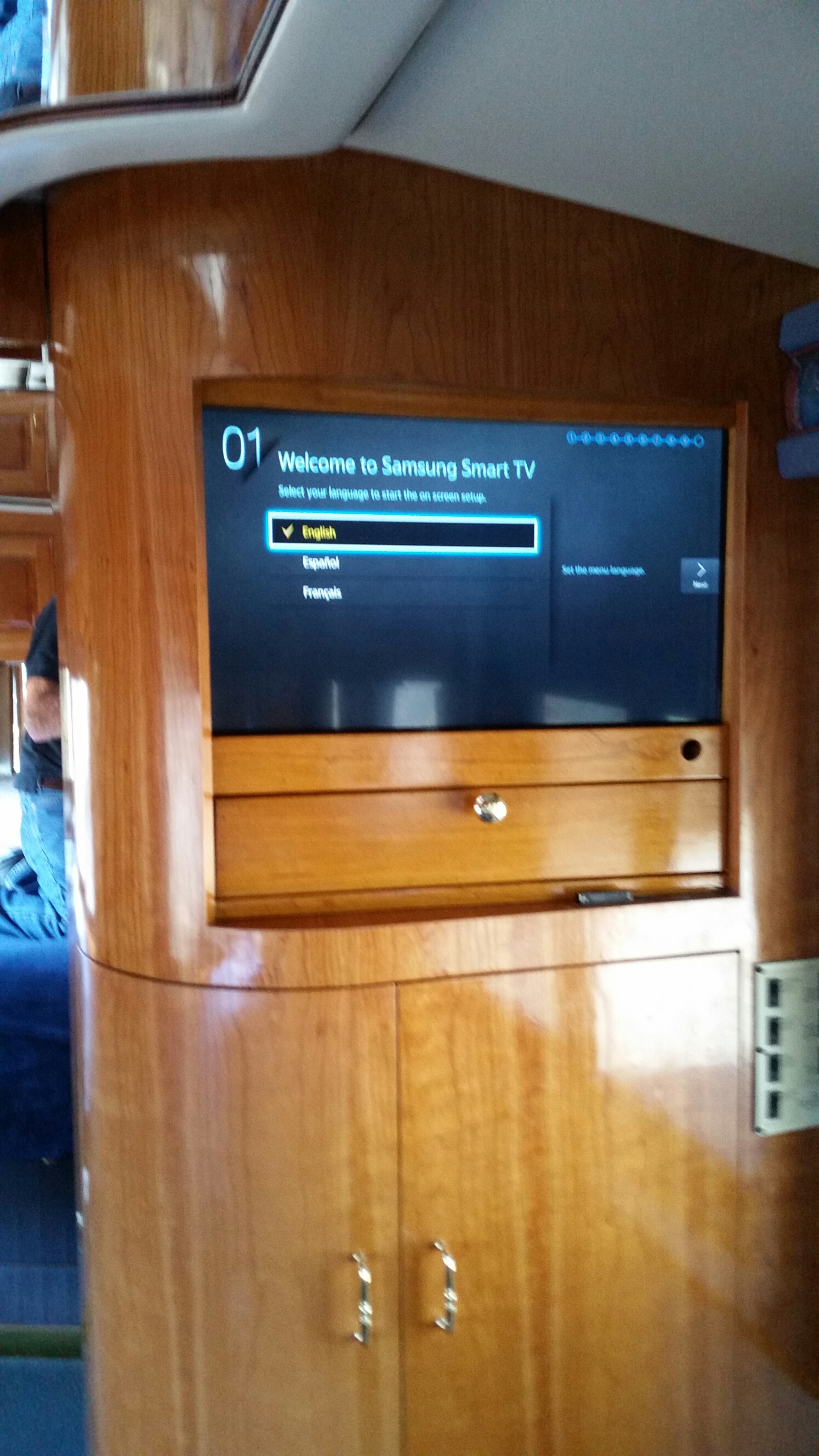

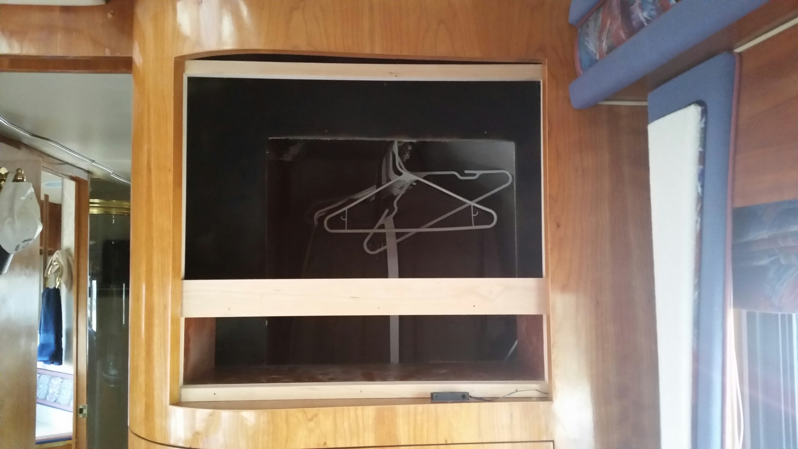

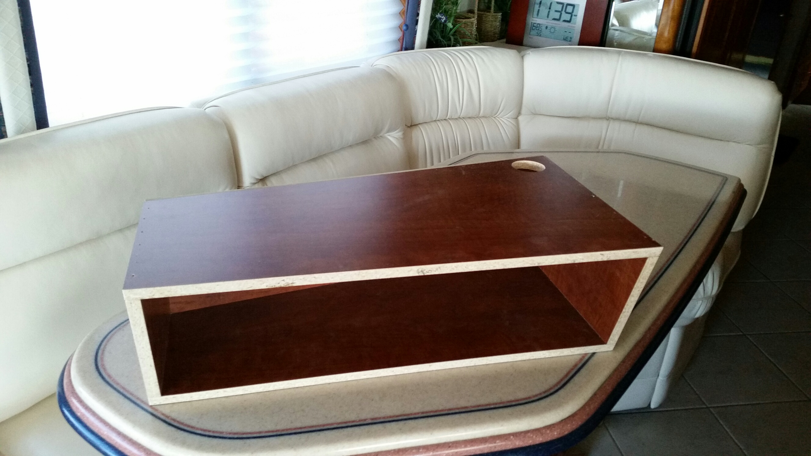

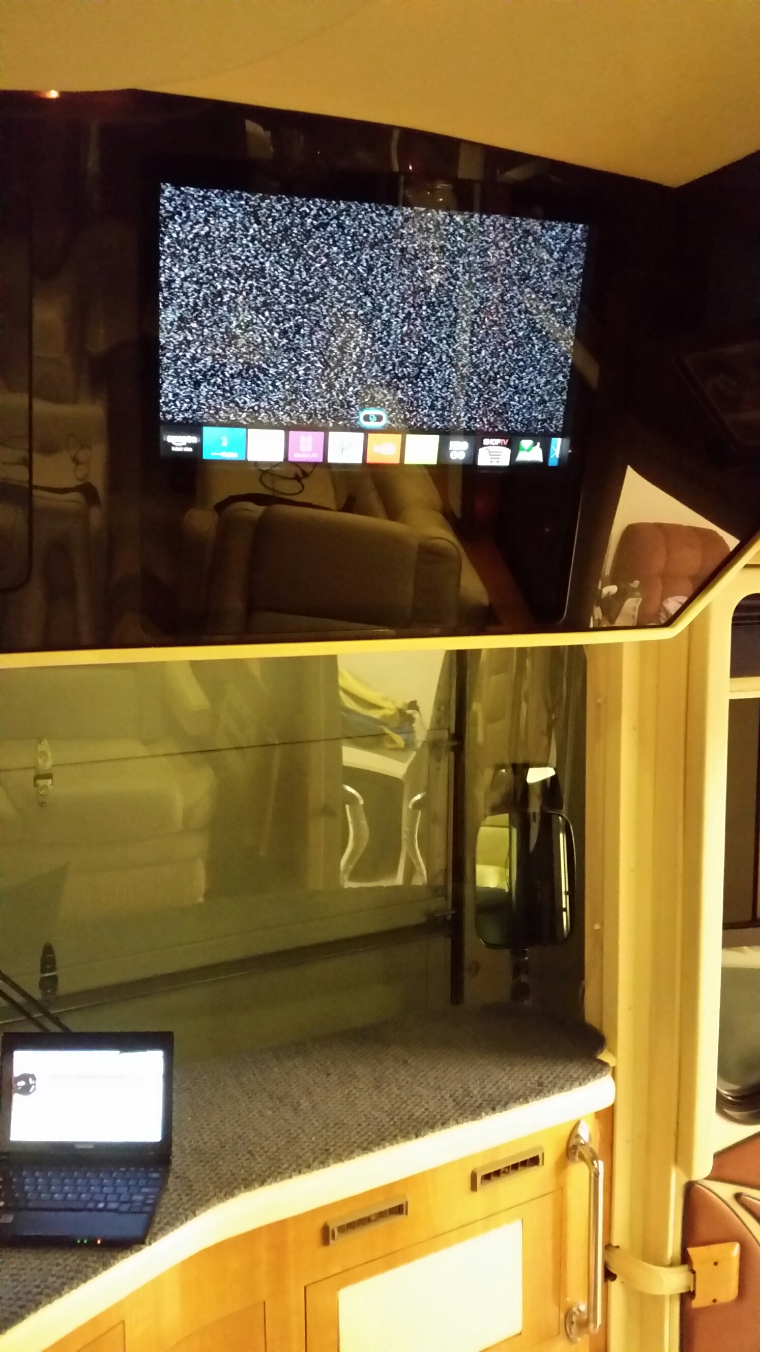

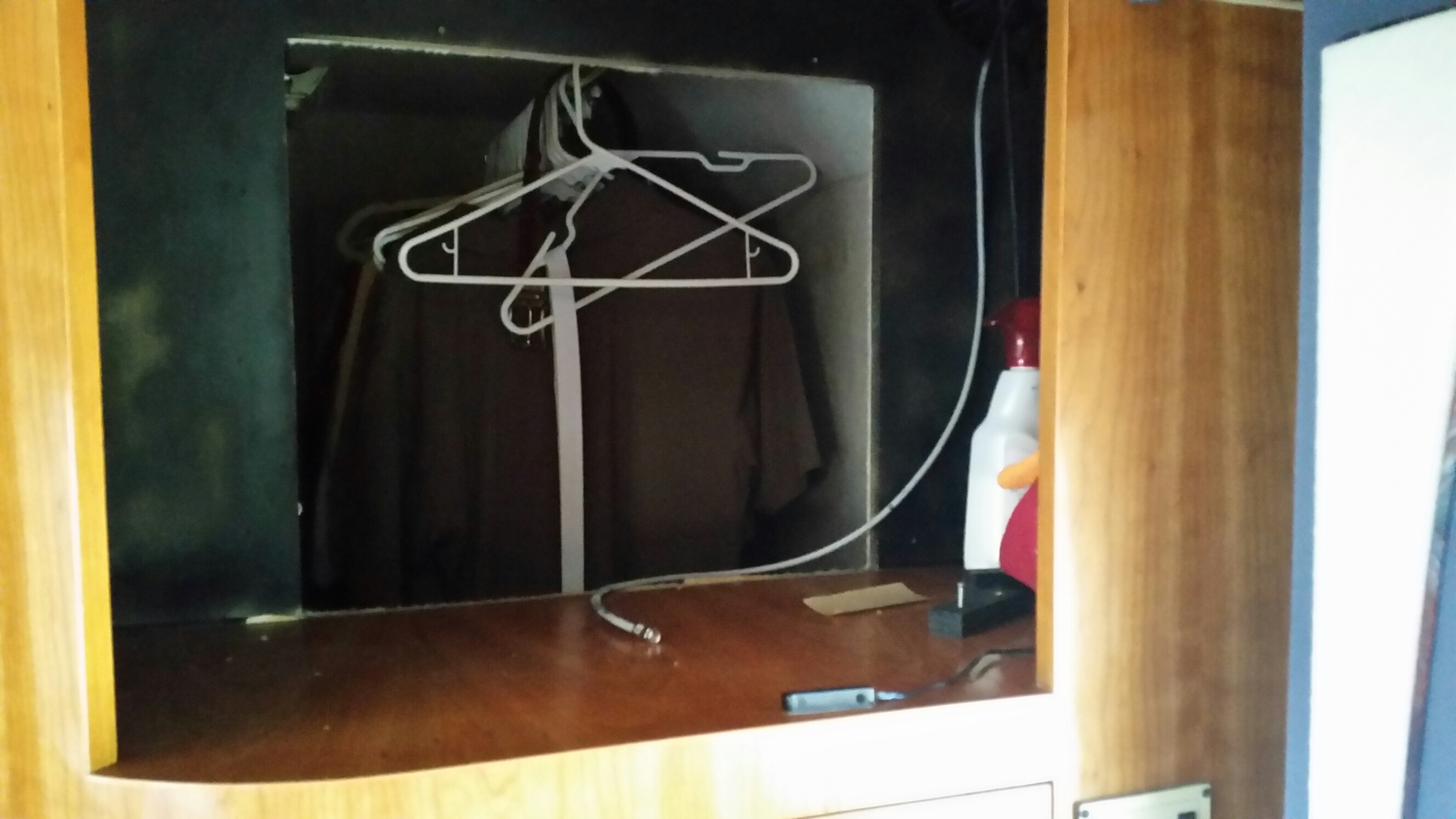

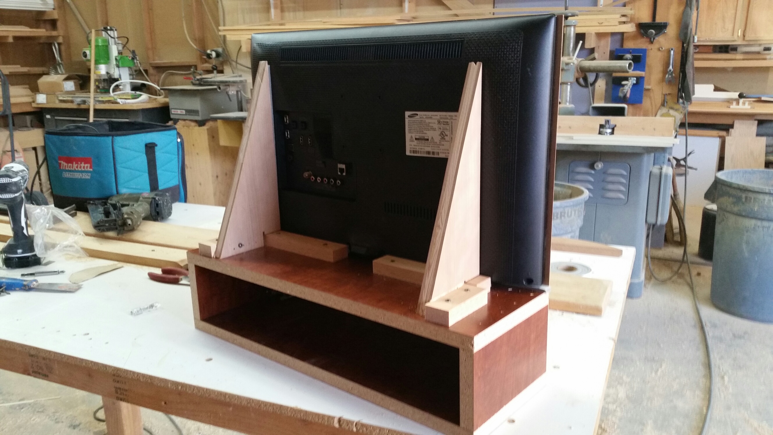

I’ve been thinking about upgrading my salon and bedroom TV(s) for a while now but I didn’t want to hang a big oversized flat screen on the interior of my bus. I already have a 42” HD flat screen in my second curbside bay. Further, I wanted to utilize the compartments that housed the original ProScan 21” CRT type TV(s) that BB installed when the bus was new. The trick was to find the largest snug fitting ones that would fit in the existing compartments. After much measuring and searching, I found the (2) Samsung 24” Smart LED TV(s) that just fit perfectly on Amazon. They are model # UN24H4500. The additional 3” in the screen size is proportionally perfect and fits the size of the rooms nicely.
If you’re looking to upgrade your old tube type TVs using the existing TV compartments, you may want to consider the model mentioned above. The pics below will show you the steps we took to install them.
Pics #1 thru 4 are of the bedroom upgrade
Pics # 5 thru 10 are of the salon upgrade
