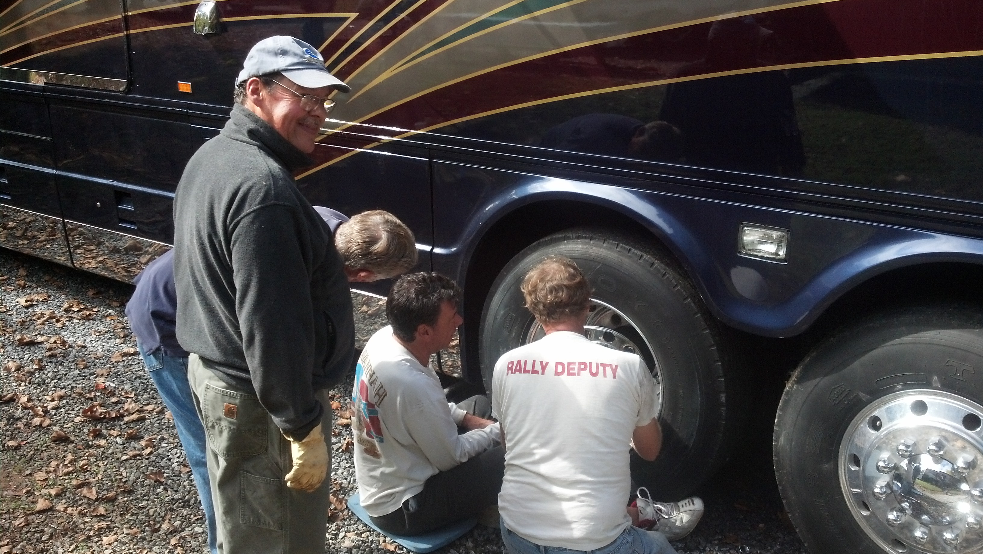

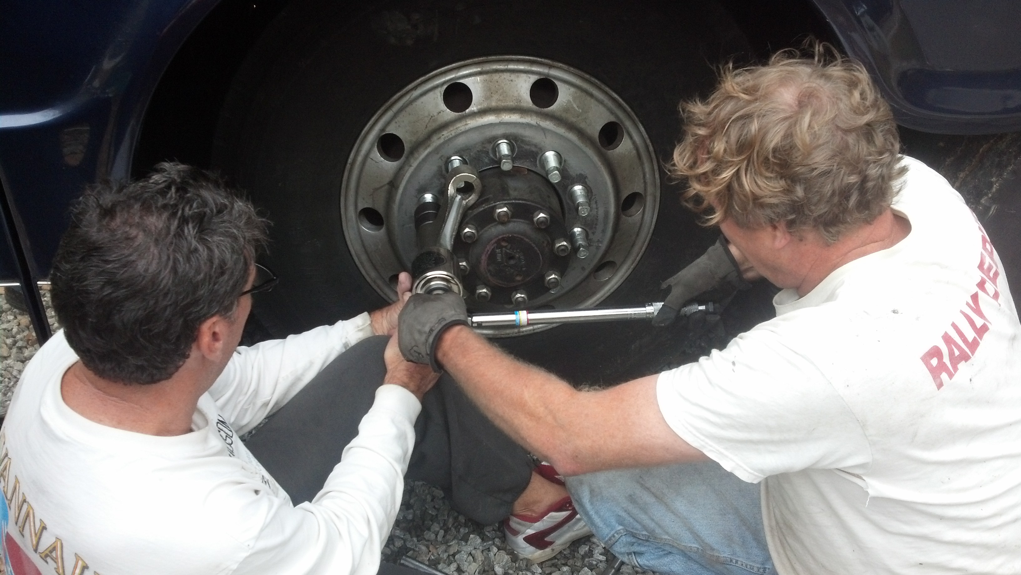

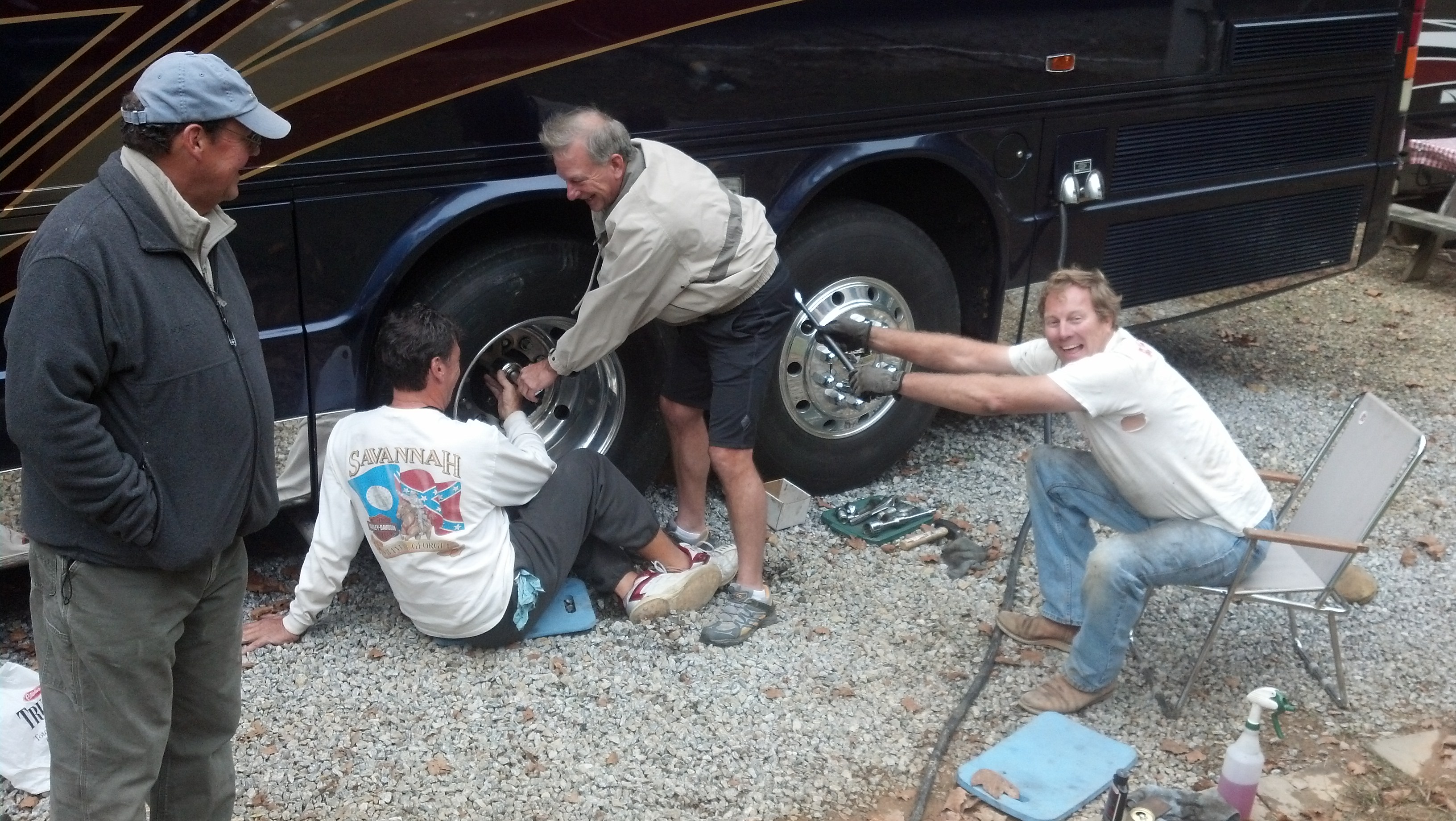

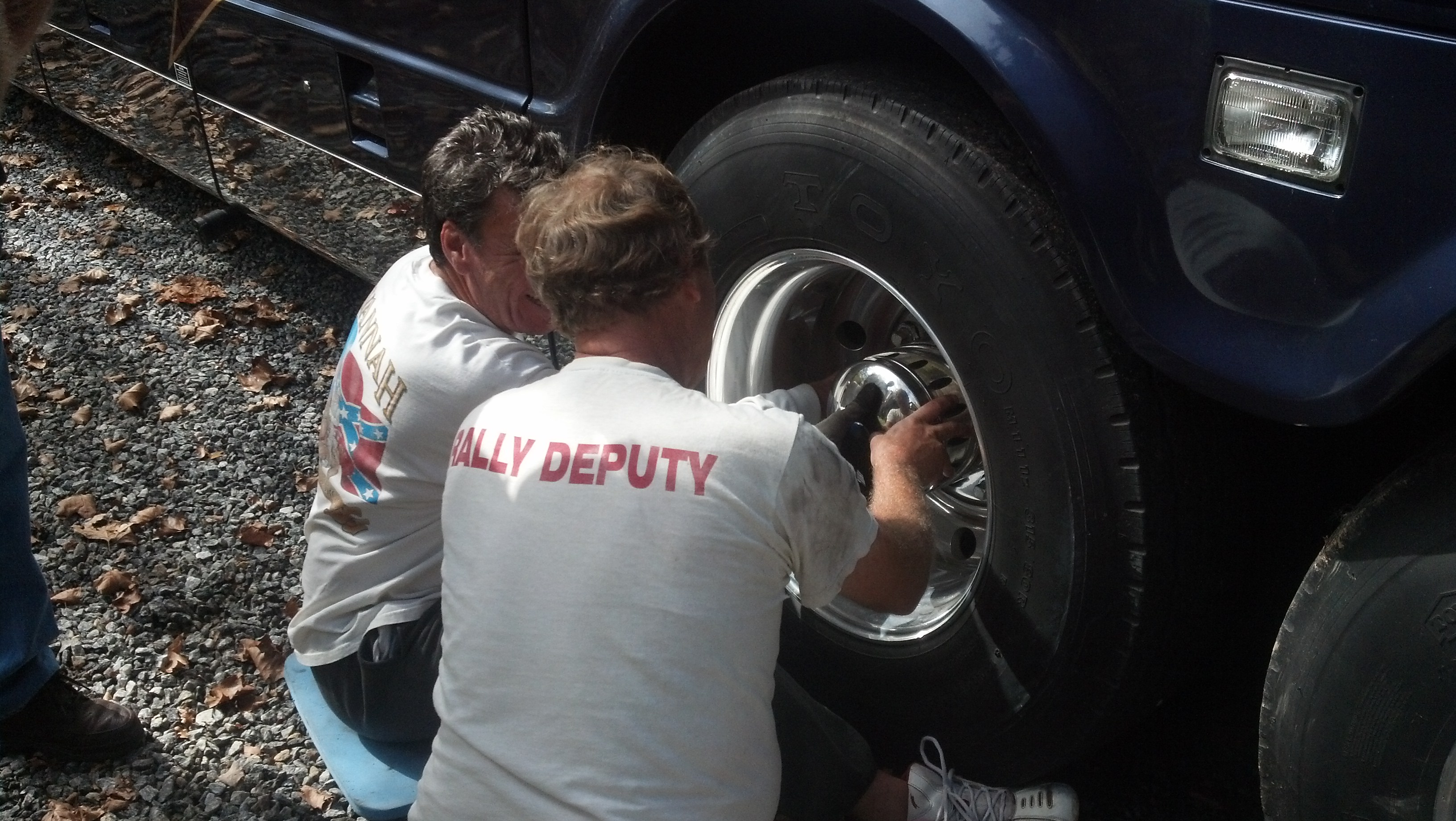

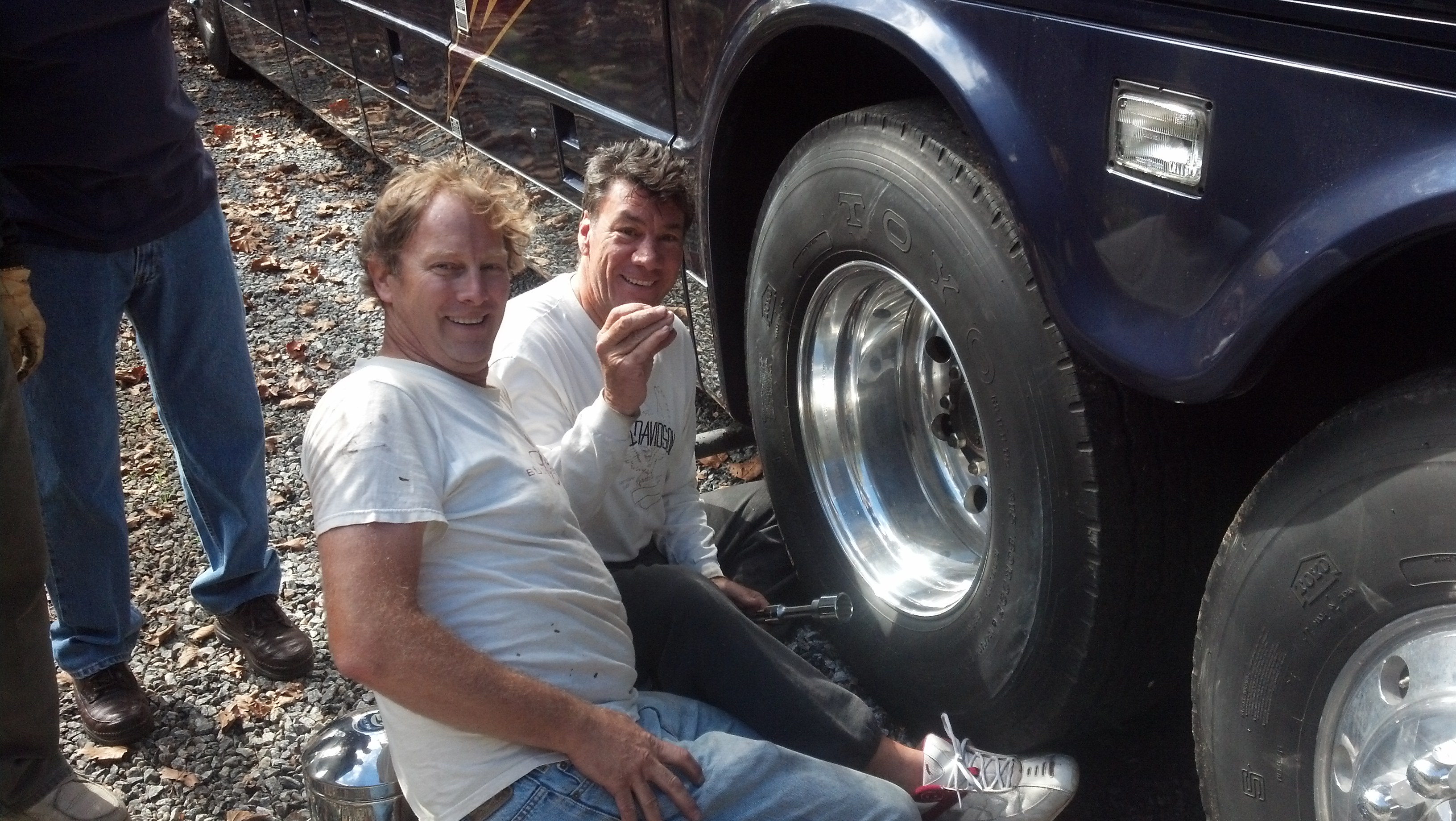

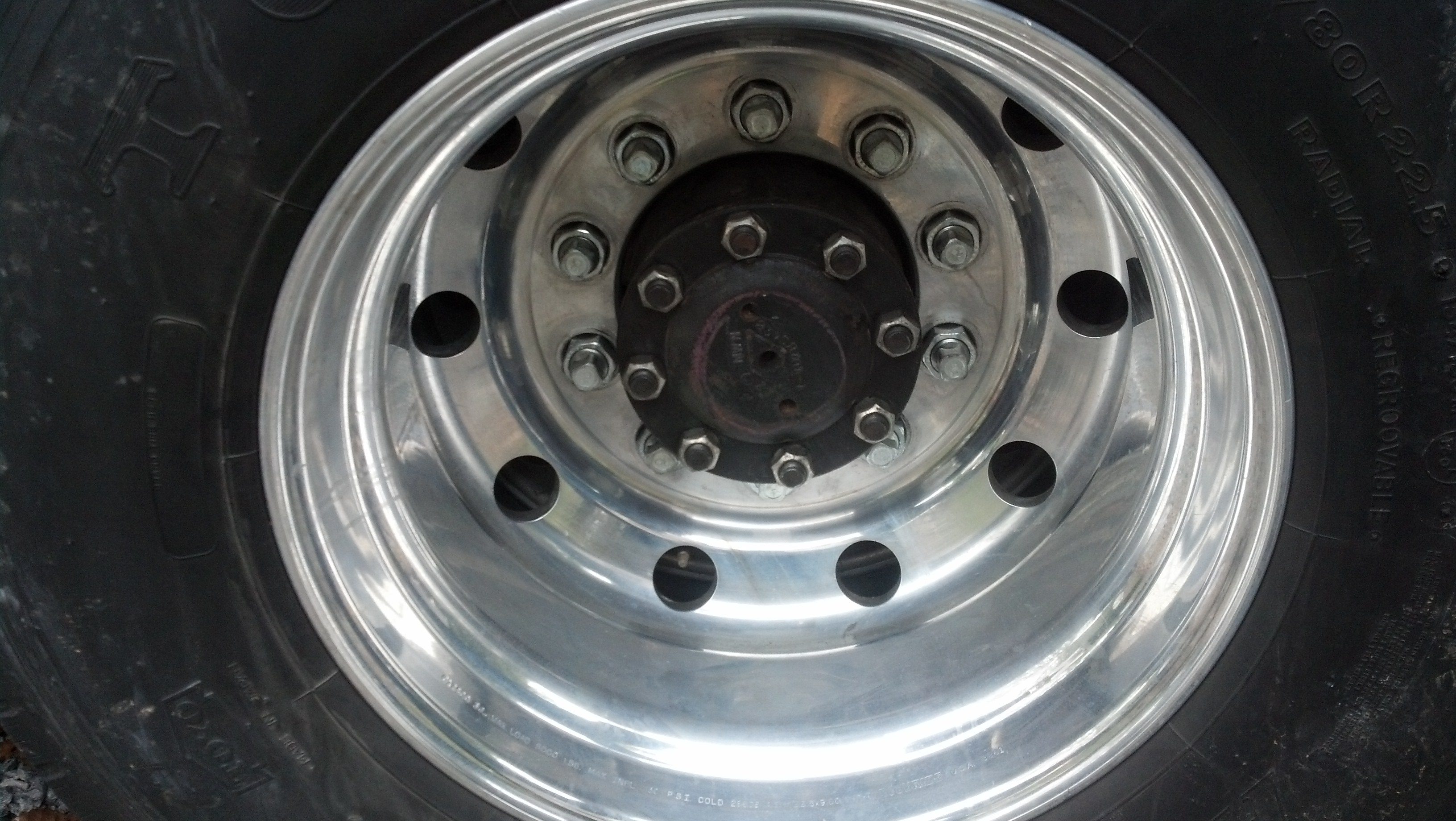

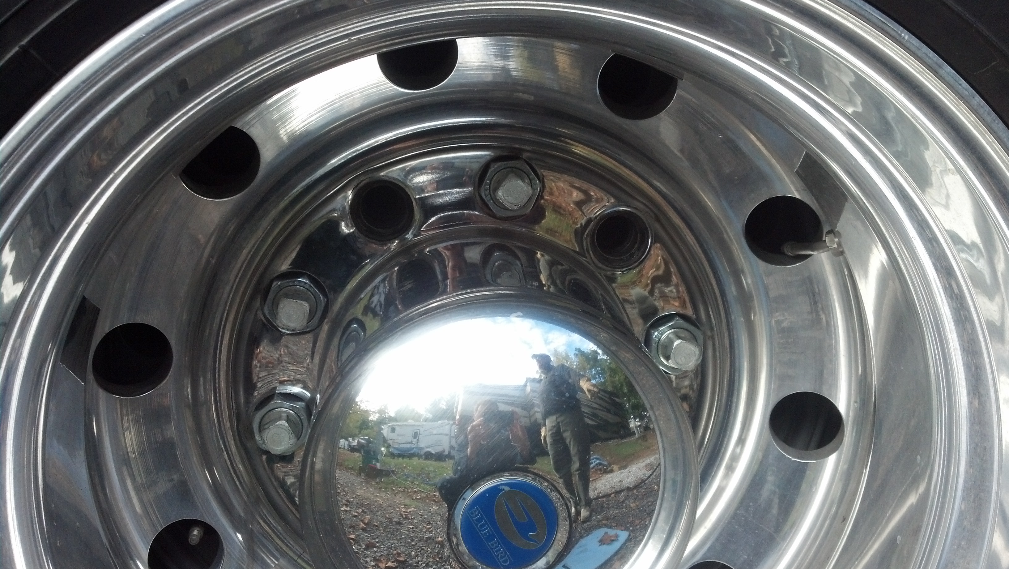

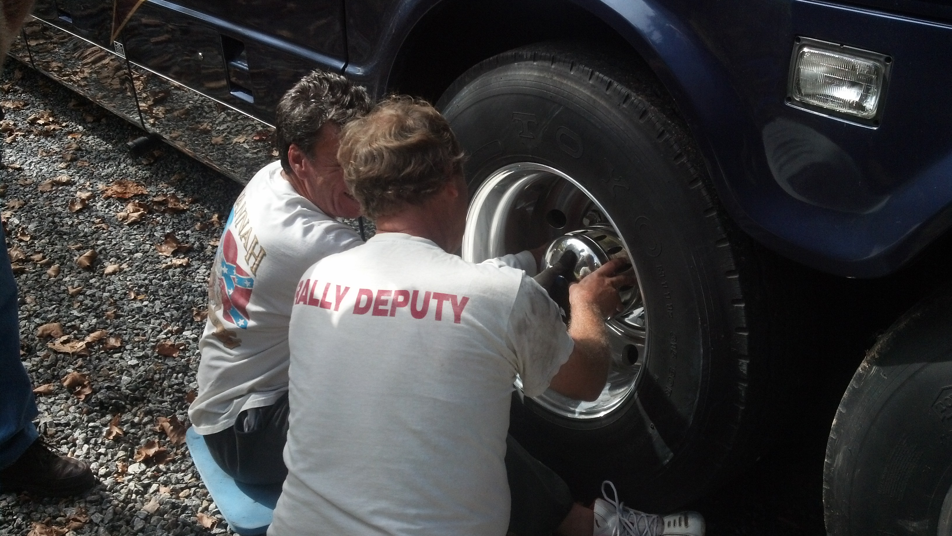

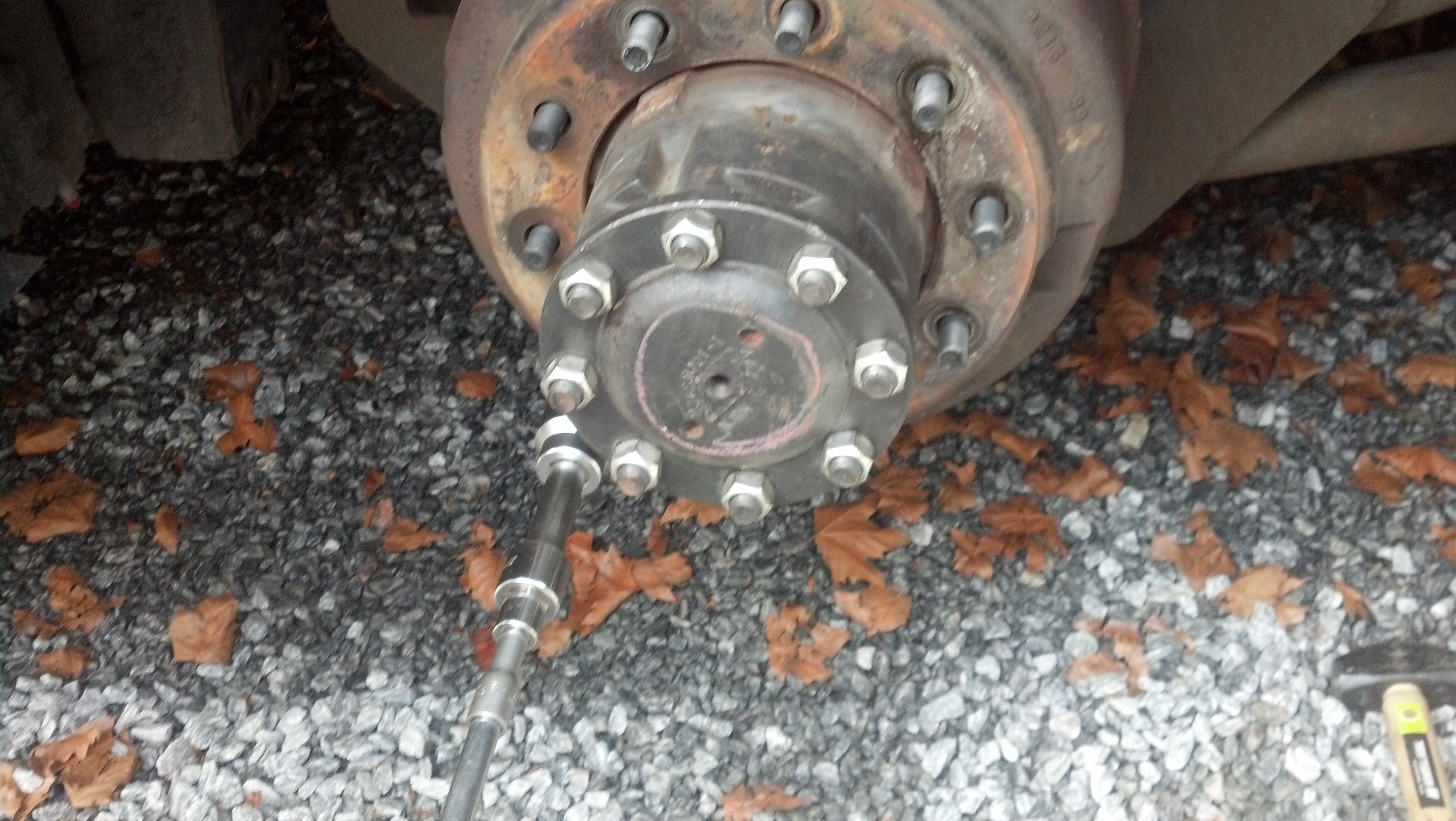

Al Perna arrived at the 2013 Wanderlodge Gurus Asheville NC Rally with a few wheel studs missing on his drive axle. He ordered the studs and had them shipped to the campground. The part numbers are Webb 101172 for the right handers and 101173 for the left handers. Let the fun begin!

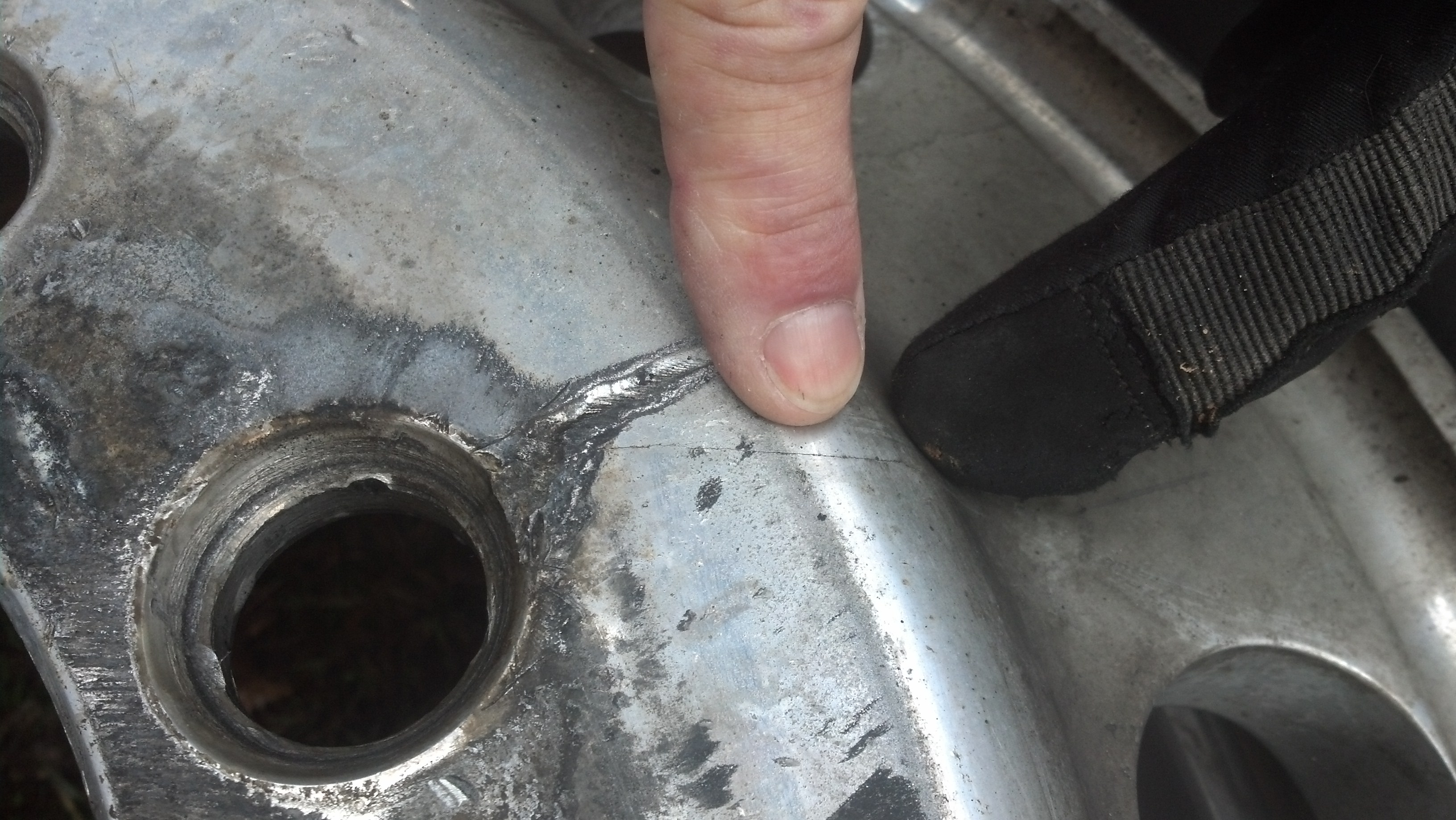

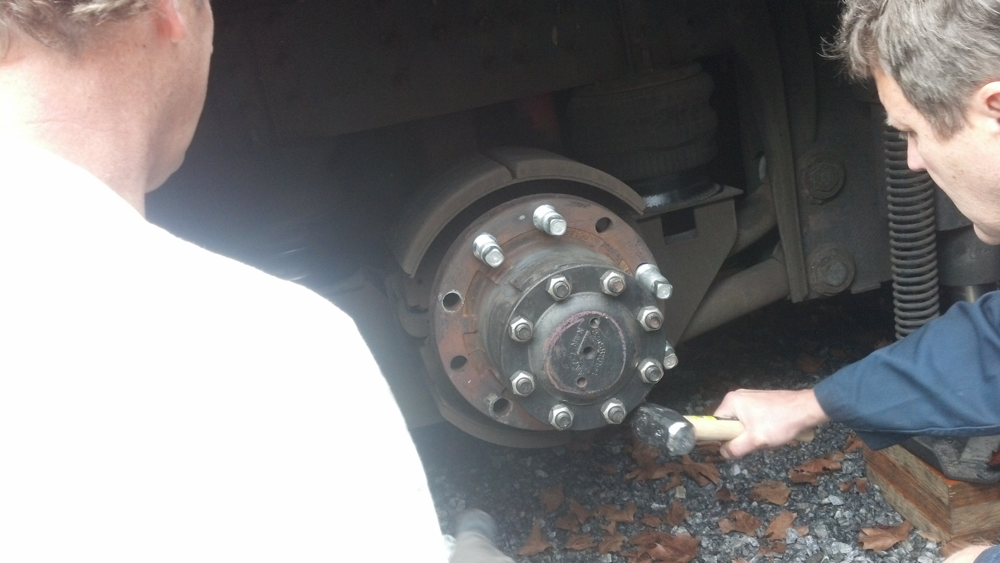

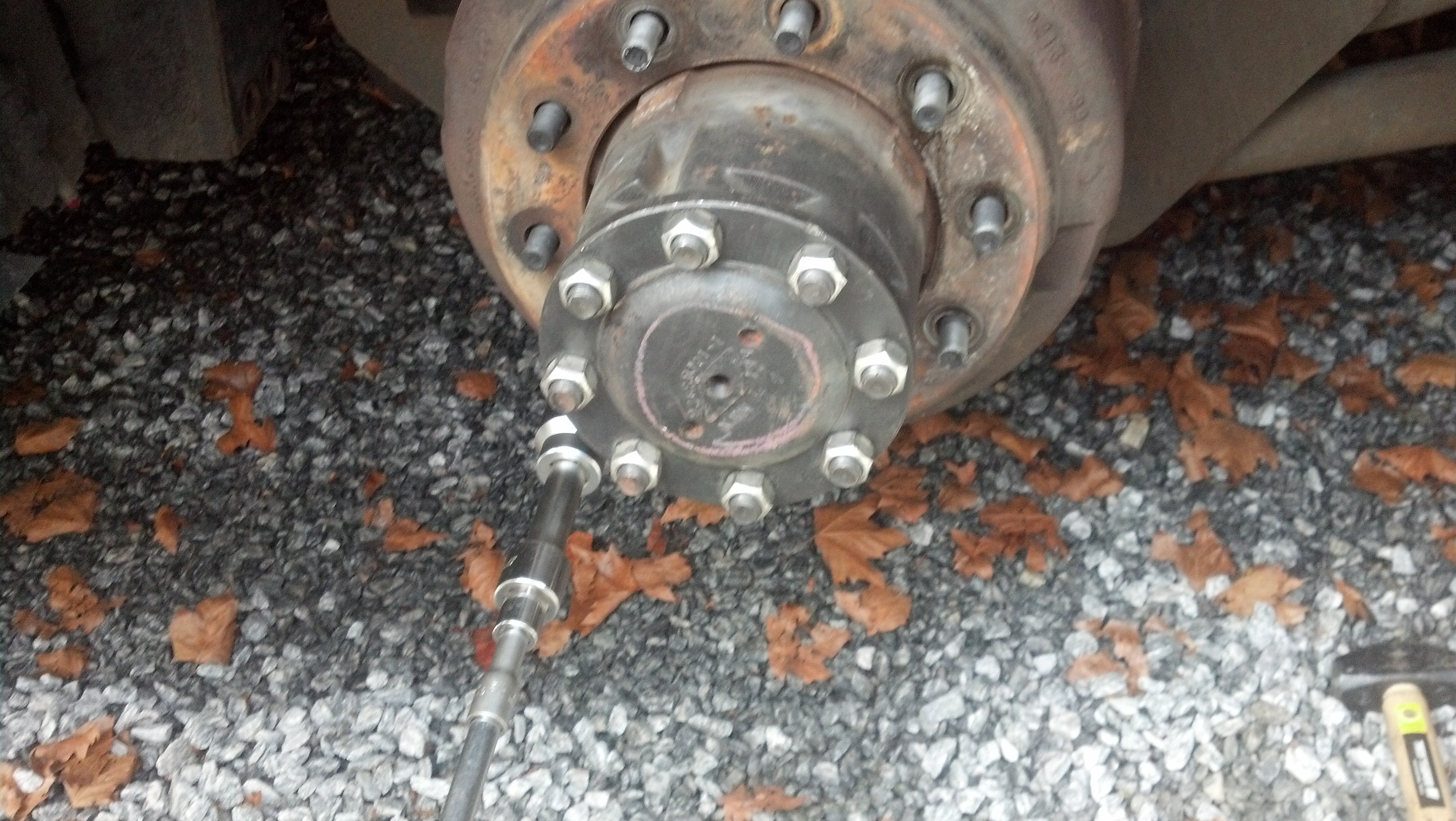

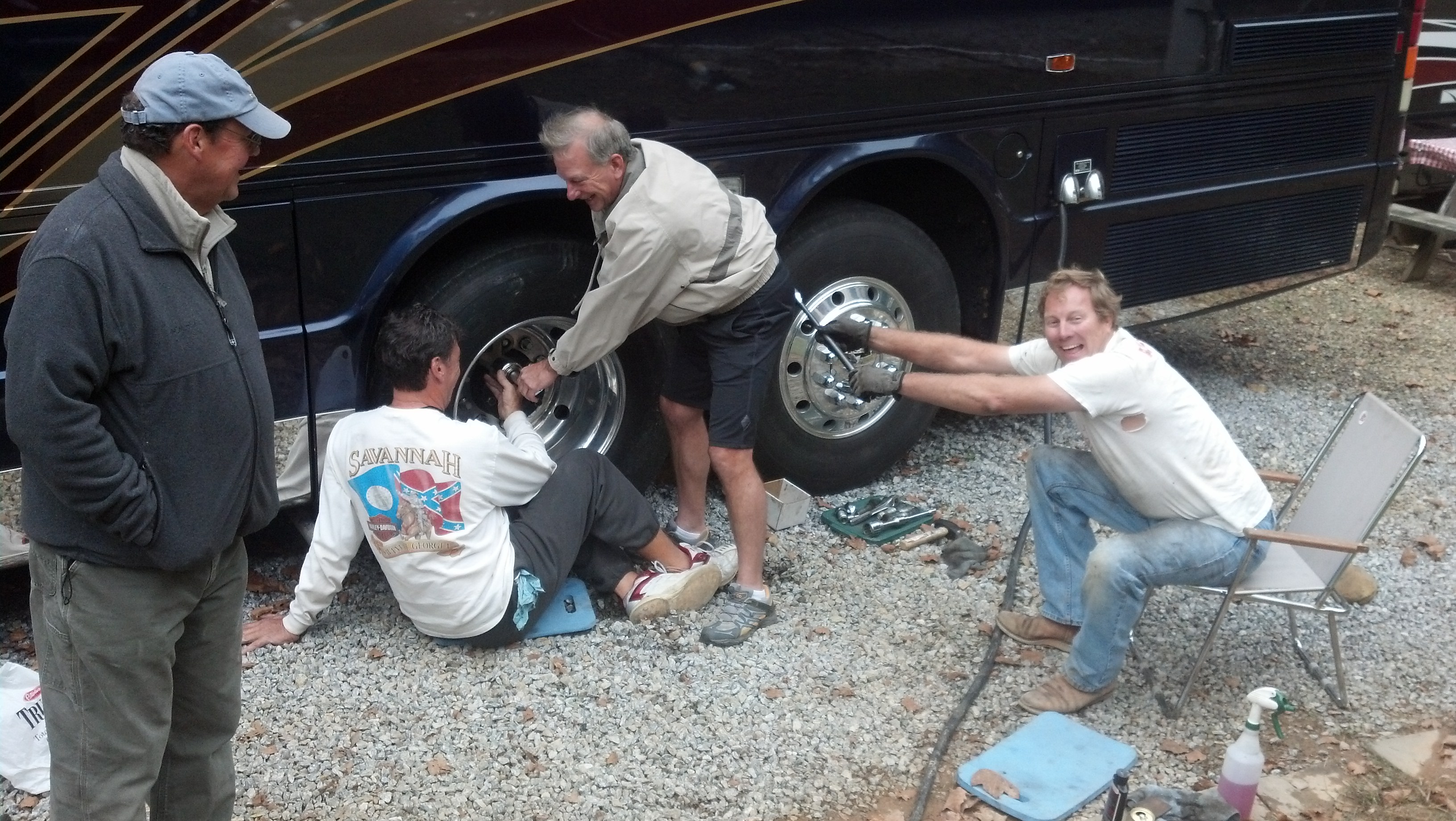

Missing wheel studs John and Al removing the wheel Greg Jesse and Corey supervising Identifying a crack in the wheel Al and David pounding out the old studs Pulling in the new studs, all 10 of them Al and John torquing down the inner cap nuts Greg, Al, Corey, and John, torquing the outer cap nuts and each other! :-) Job well done The Cast: Corey, Greg, Chuck, Al, John, and David (taking the photo)! david brady, '02 Wanderlodge LXi 'Smokey' (Sold), '04 Prevost H3 Vantare 'SpongeBob' "I don't like being wrong, but I really hate being right" |

thank you David for the fine Pics . One would think you were only the photographer . I owe many a beer and favor to the entire group . especially to David and John, for there take charge attitude toward this project . If not I would still be driving on 7 studs . as you can see from the Pics John did most of the work , Cory and I did just enough to get in a photo or 2 . Greg was our safety Mgr , Chuck handled procedure assistance along with wheel stud install . this was a true team effort . again I want to thank David for providing his expertise and dedication to Blue Bird Preservation, along with another Rally for us all to attend .
It was also great to be in a campground where we could work on our coaches and not be hassled by the staff . they were very accommodating to us the entire Rally . I look forward to this Rally next year . thank you again for helping Erika & I drive away safe . al perna 2000 LXI ormond beach fla |

(10-10-2013 00:11)Arcticdude Wrote: Anything above 40 or so is downright tropical! That explains the air conditioning built into the t-shirt! I have to say though, John is one energetic guy. I tried to wrestle that clammy wrench out of his grip but he wouldn't have any part of it! So, I was reduced to keeping time, "Six-O-Clock now Al, okay Ten-thirty, now Two-O-Clock Al, etc, etc"... ![]() david brady, '02 Wanderlodge LXi 'Smokey' (Sold), '04 Prevost H3 Vantare 'SpongeBob' "I don't like being wrong, but I really hate being right" |
