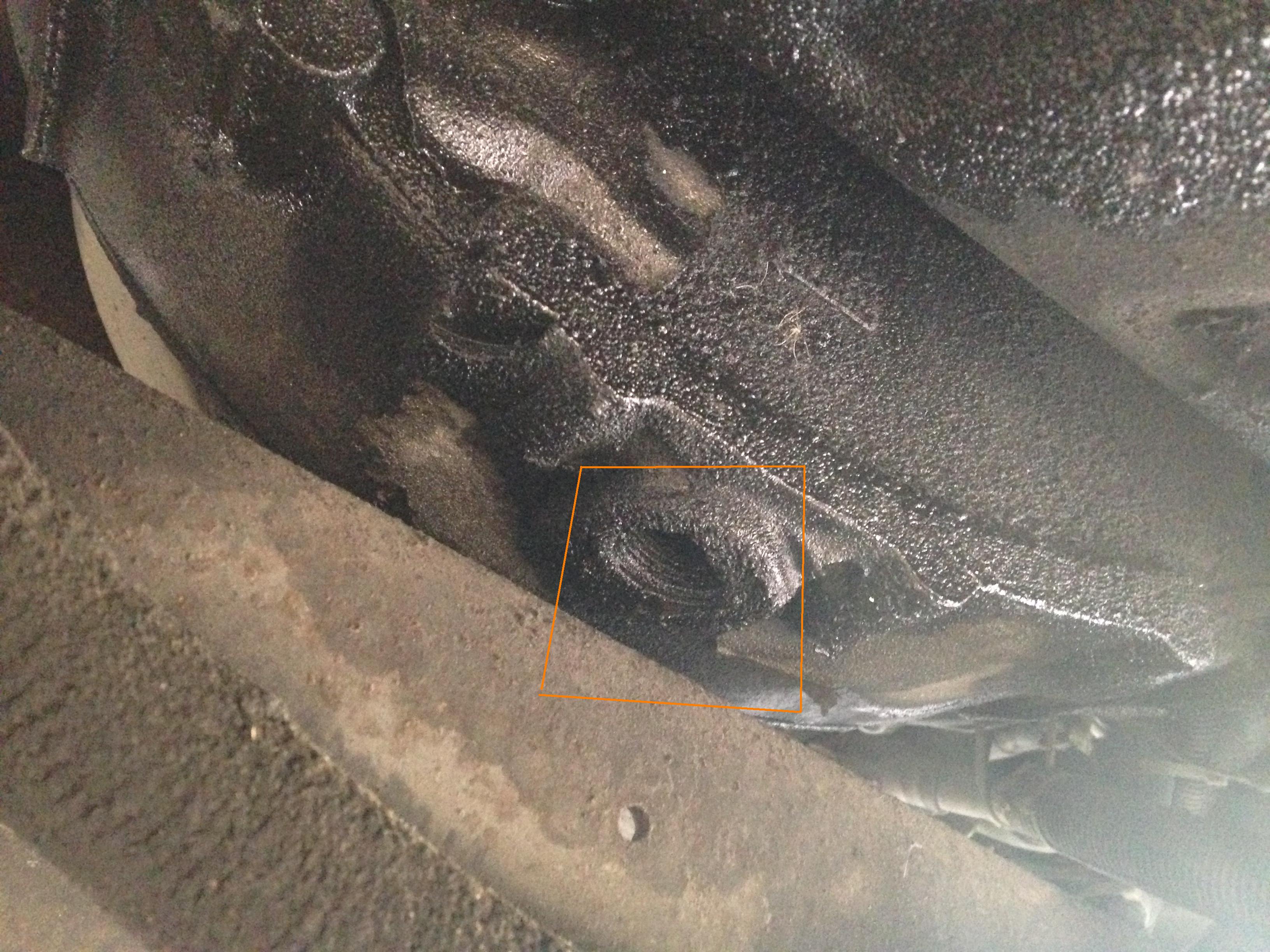

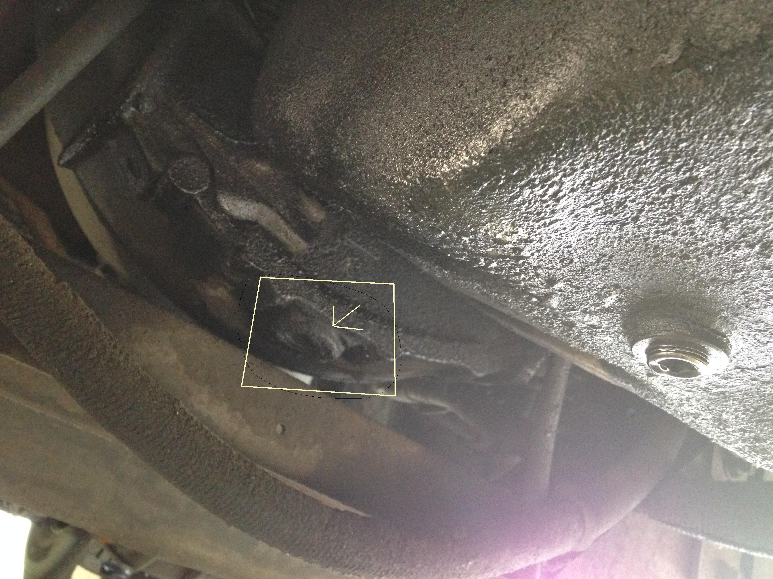

Out getting dirty today and noticed a treaded hole with no plug. Looks like its been out for a while?
8V92 just in front of oil drain

Is that on the bell housing? It's hard to tell in the pic but if so, that's the drain in case the input seal or crank seal leaks. It's threaded so you can route the drain somewhere else if you want.

Yes, I believe that is called the bell housing. So it's not a problem. Thank for help!
