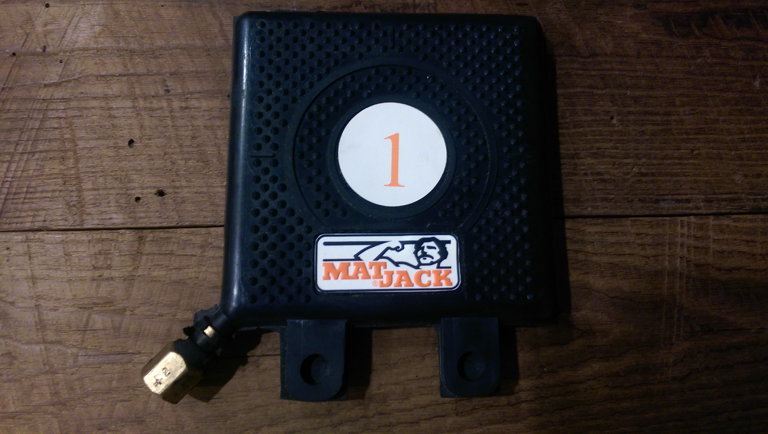

To R&R my Powertech Generator sump pan, I need a low profile jack. The plan is to insert a jack under the sump, disconnect the fore air springs, lift the front of the generator, and crib under the air spring mounts to gain access and clearance to all the sump pan bolts. Here's my low profile jack; it's a Mat Jack 1:
It's 6"x6" and 3/4" high when deflated. Inflated it will lift 1.5 tons to a height of 2 1/2 inches!
They're available in a variety of sizes up to 86 tons!

lift from the pan may squash the pan gasket. Can you hoist?
