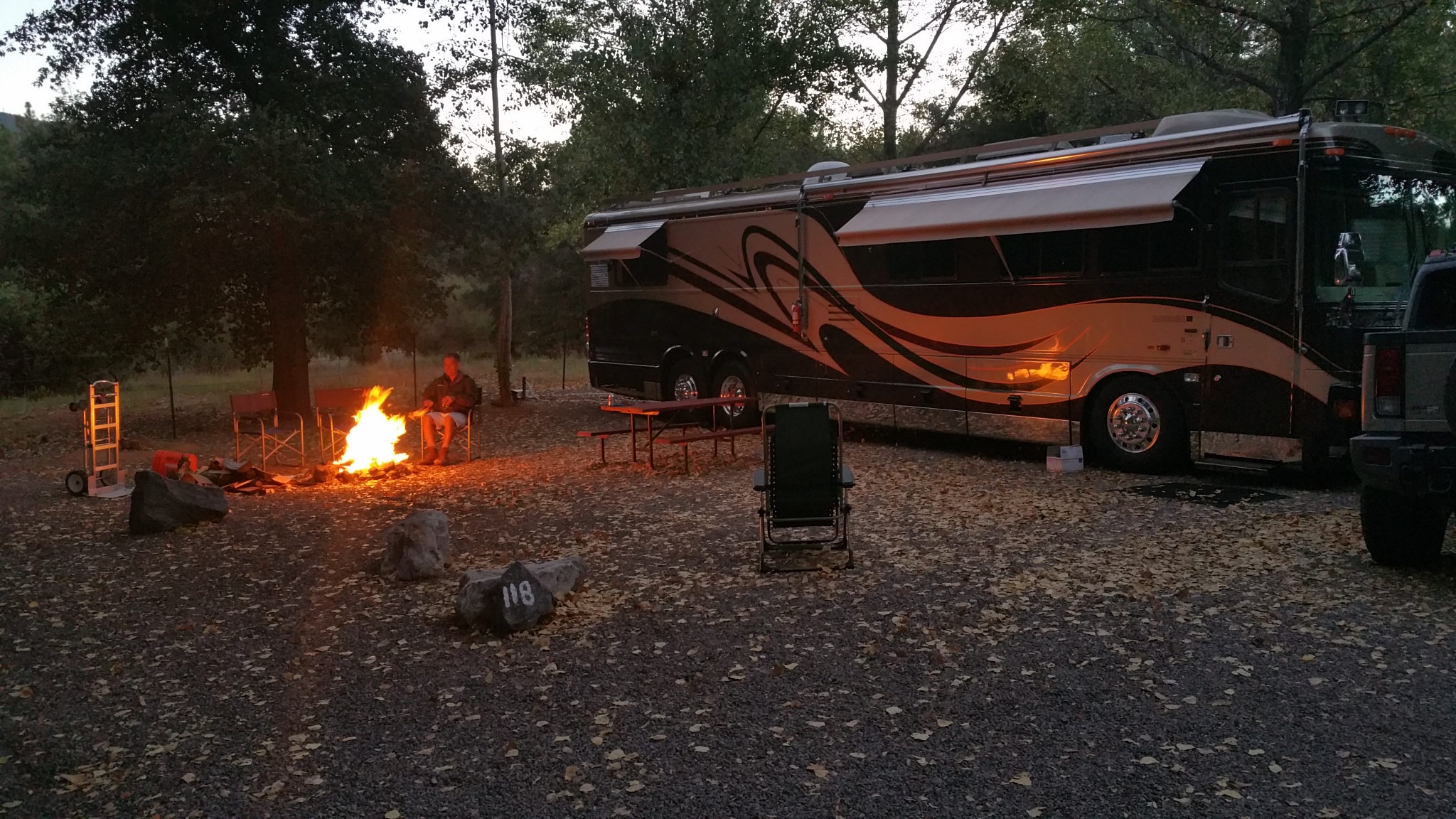

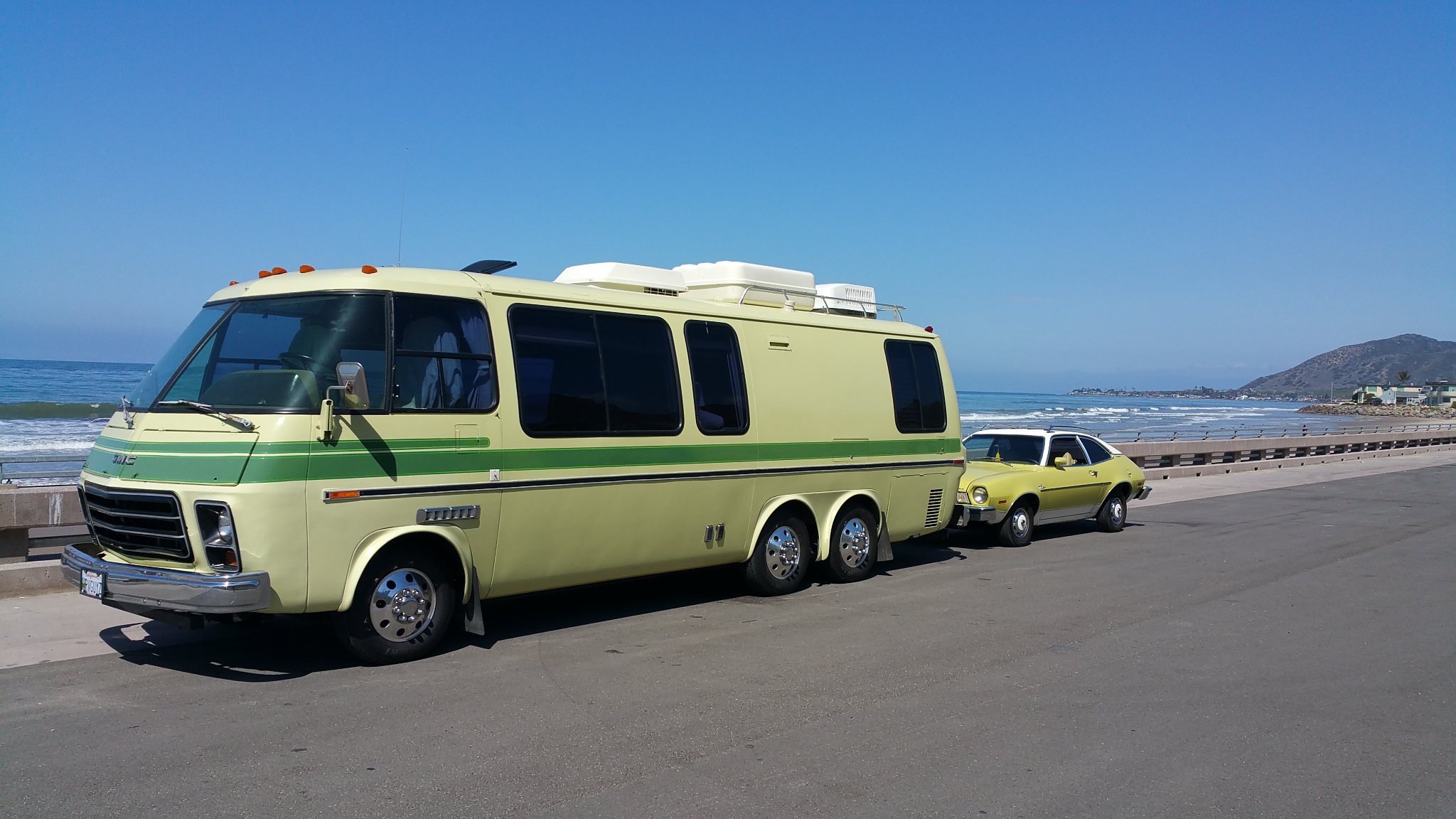

not sure but is it a tow'ed or a towed. the Pinto I pull behind my GMC is a toad for sure İmage
but the H2 I pull behind my LXi I call a Tow'ed. İmage
I think you will be fine with the weight. that 3208 is built to pull 60,000 loads. I has several of them in dumptrucks in the past with more than 400,000 miles when I first converted them into dumptrucks. one thing I do is pump up the tires in the tow'ed to max on the sidewall label to reduce the friction.
