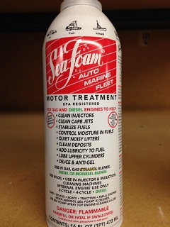

There are lots of treatments, just make sure it says it's for Diesel. All the chain auto parts stores have them. I would treat the whole tank, so you may have to fill up. Also, I would have some spare filters on hand. The treatment may also remove some tank growth.
I have used this one in my boat for water. Hope this helps Gregg Gregg & Jane Gesse 1994 WLWB 40 Mid-Door |

Today I was able to spend some time checking this out. I drained a mason jar full of fuel from the separator and the fuel tank. Neither had any signs of water.
It may be like Steve said, a bad sensor. I am adding additives just to make sure. Thanks for the help. Urnie Urnie & Medie Krueger Yorkville, IL 2001 LXi One Slide 1983 FC35 sold |
