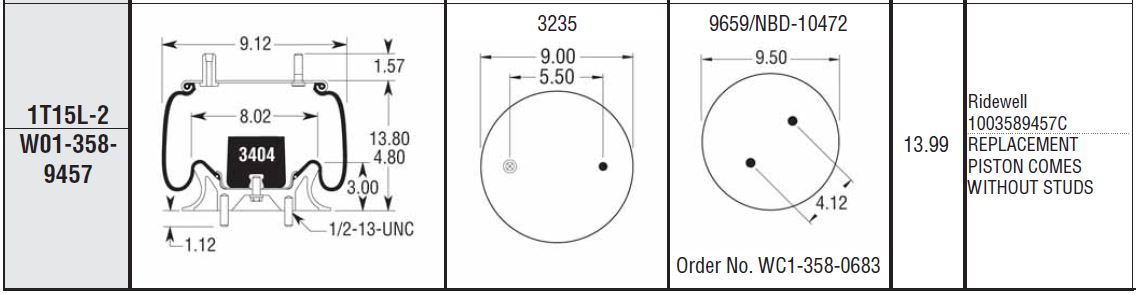

Here's an engineering drawing of 1R11-151, which crosses to W01-351-9457. I've also uploaded it to our Document Library.
Document Library > Models > LXi > Suspension > W01-358-9457 W01-358-9457.pdf (Size: 81.66 KB / Downloads: 1321)

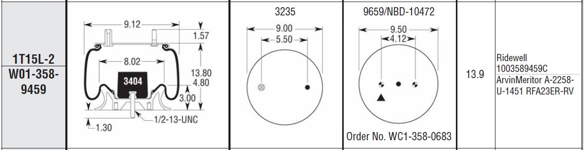

Here's an engineering drawing of 1R11-152, which crosses to W01-351-9459. I've also uploaded it to our Document Library.
Document Library > Models > LXi > Suspension > W01-358-9459 W01-358-9459.pdf (Size: 147.58 KB / Downloads: 1132)
